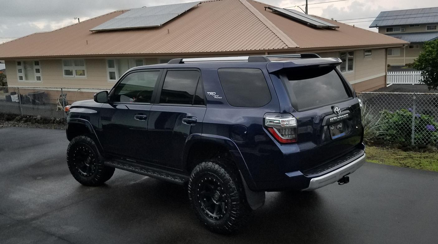

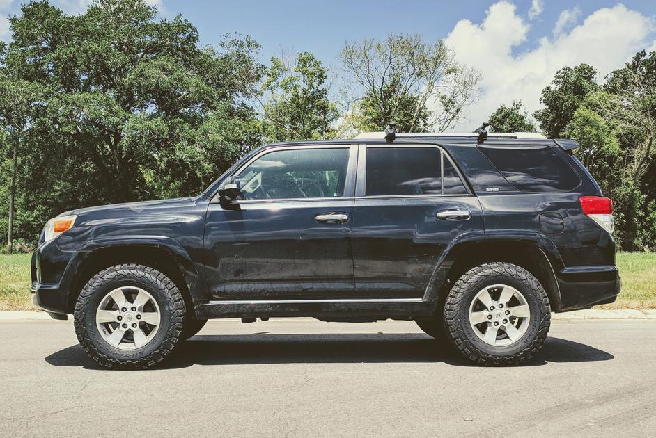

Sharing 2” front spacer lift, rear OME trim spacers, new 275/70R17 Kuhmo AT51 tires.
Nothing huge but figured it might help others make buying decisions.

Toiled over this for a long time. Its a daily driver at about 1000 miles a month on pavement, off road use is mostly forest service roads and light beach duty. So extra weight and any rubbing would be totally annoying. In the future when I change out to better dampers and more lift and have a second street vehicle, I'll change out to 285s likely.

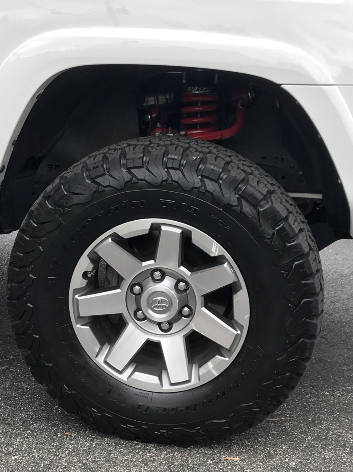

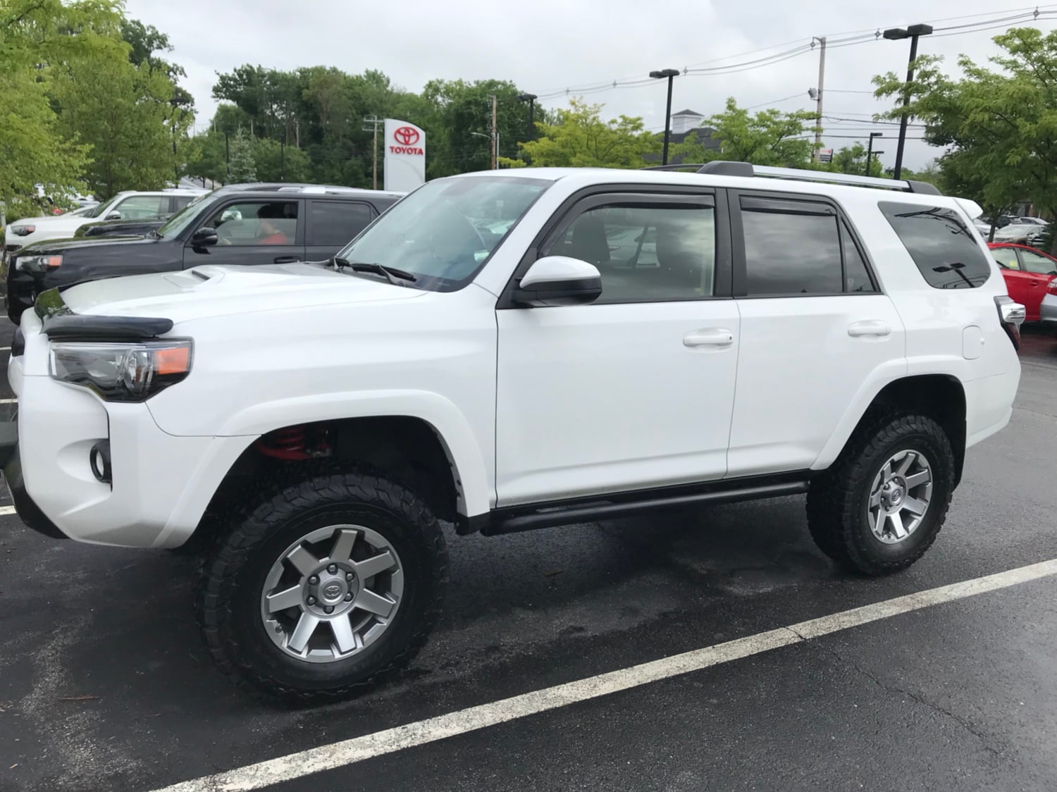

Anyone here have any thoughts on tire sizes with the Daystar 2.5/1.5 and TRD Pro wheels? I am looking to put some 285/70/17's but I don't know if that requires the BMC or not..

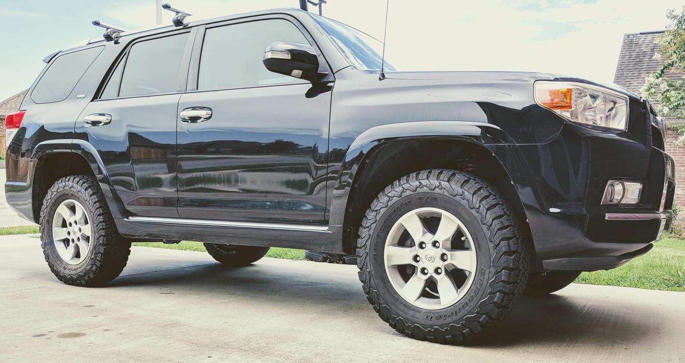

I have the Daystar 2.5/1.5 kit with TRD Pro wheels and 275's. No rubbing at all.
But if you might need to do the fender mod if you're planning to run 285's. YMMV

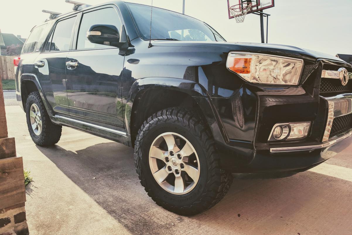

The guy at my local shop just threw me for a loop. I am removing my stock springs, and setting the bilsteins up front back to 0" from 1.75" and installing OME 2884 springs up front and 2895e springs in the rear. He said he thought the front shocks would need to be reset, as far as travel goes. In all my research, ive never heard of this. Have i missed something?

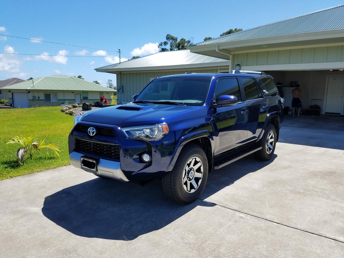

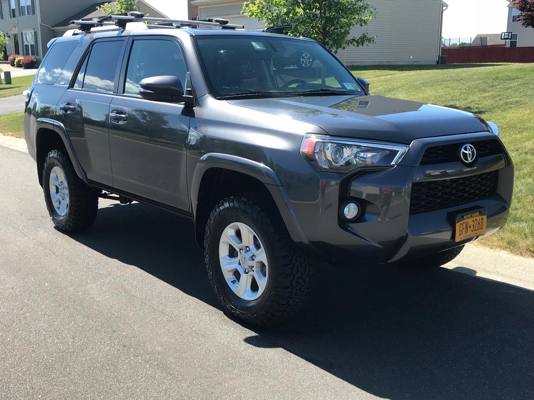

Bilstein set at 1.75 front, bilstein/cornfed 1" rear spacer. Stock size BFG's

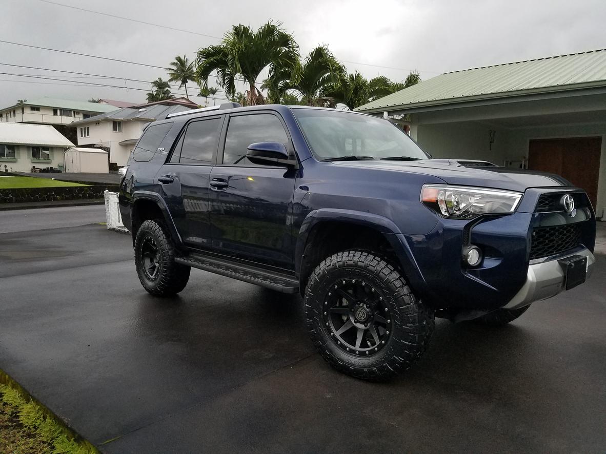

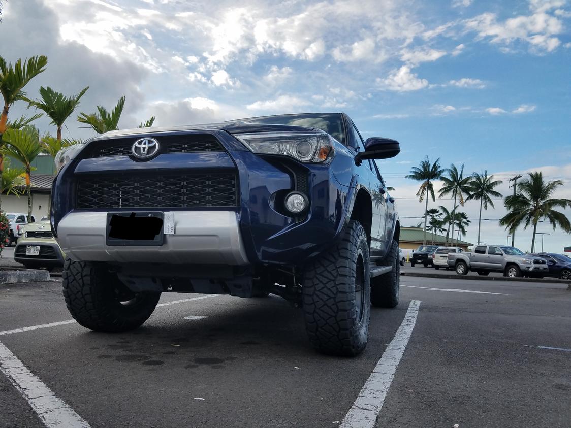

Nautical Blue TRD Off Road

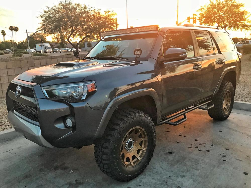

Nautical Blue TRD Off Road Toyota 4Runner equipped with 3" Bilstein/Toytec Lift, Icon Rebound Wheels, and Nitto Ridge Grappler Tires.

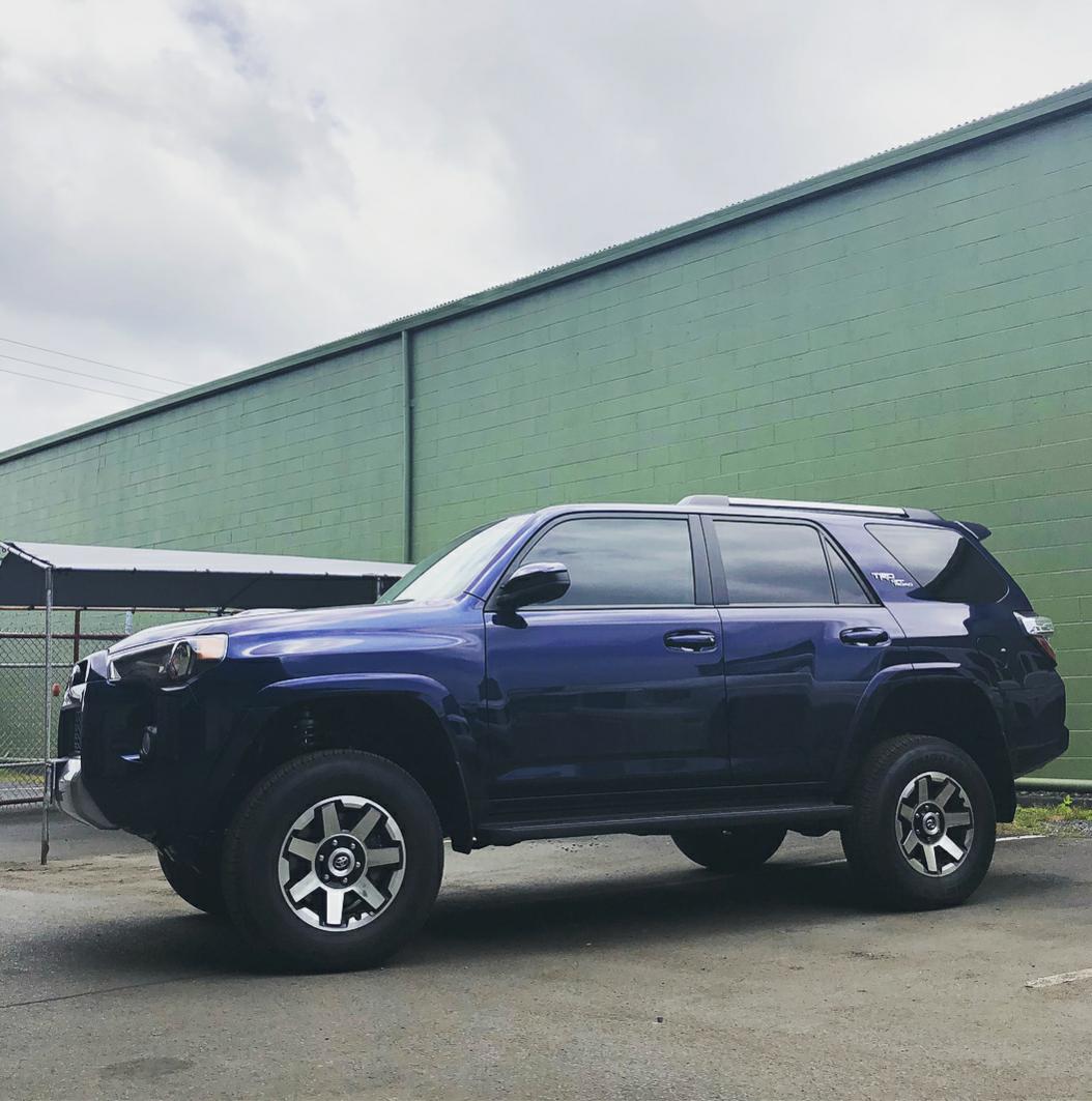

Update
I didn't like the rake and the fender gap difference of the 2" lift so I increased it to 2.5 with a larger spacer. Now the fender gaps looked level.
Later, I upgraded to 285 sized tires so the wheels didn't look so small. These are P rated Firestone Destination AT tires. I really liked how they didn't look overly aggressive and are lightweight P rated tires since I don't go off-roading. Still deciding if I will install spacers for a wider stance or not. Anyways, here are some progress photos.

Looks good man! The Destinations are really good AT tires.

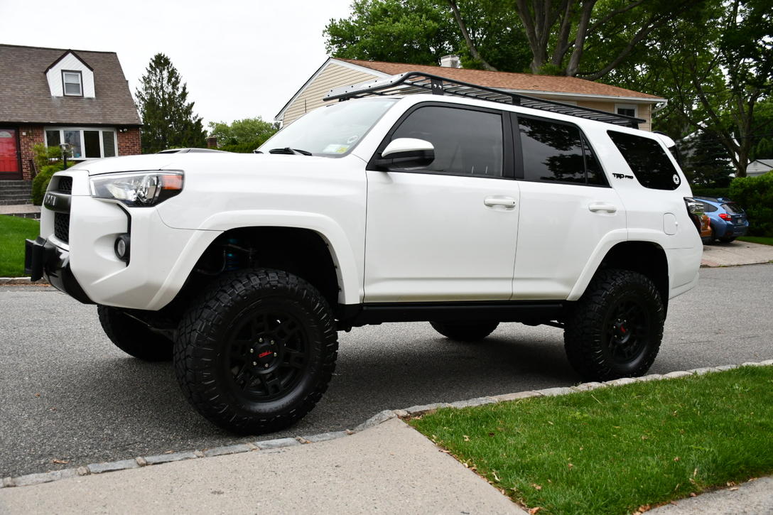

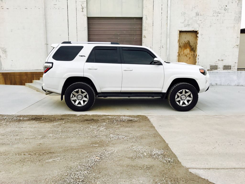

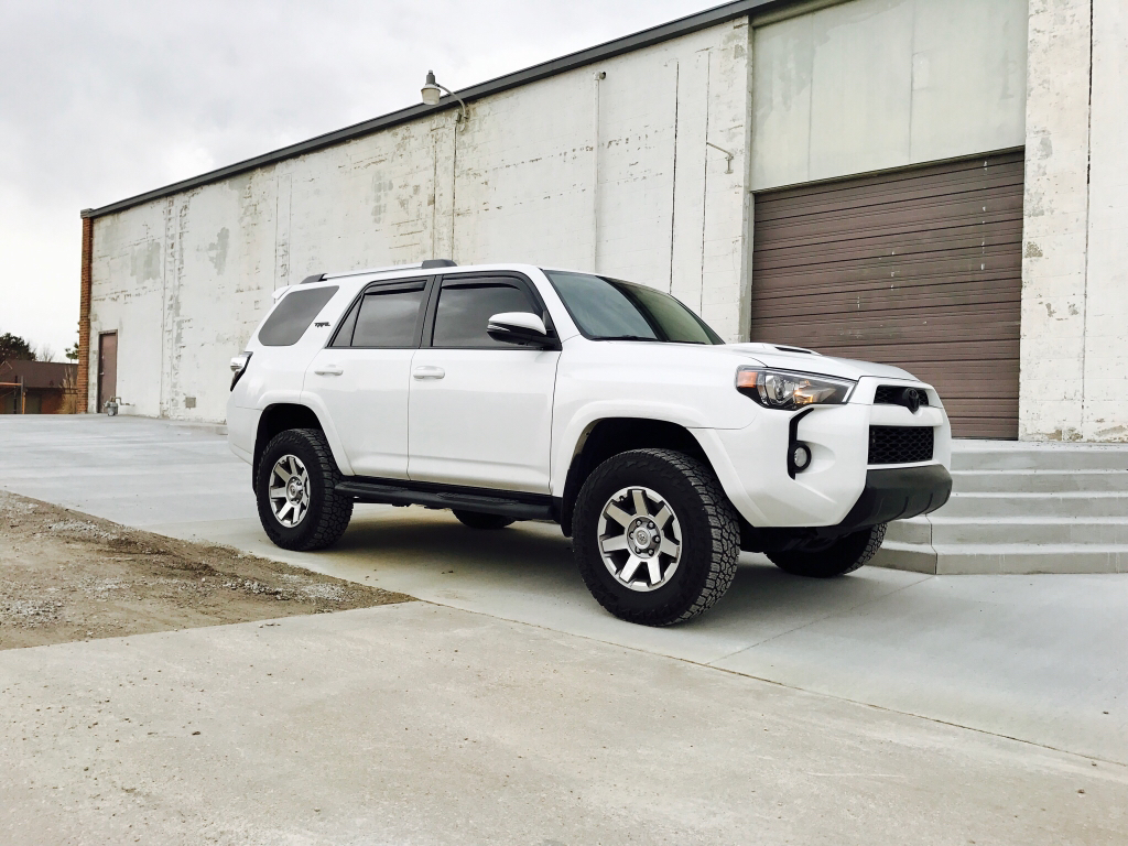

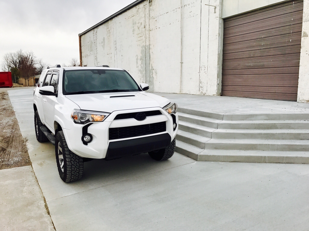

Toytec Boss suspension/JBA UCAs/Spidertrax 1.25 wheel spacers/285 BFG KO2
Super happy with how it turned out.

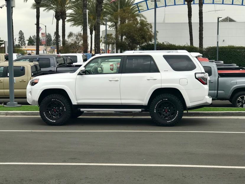

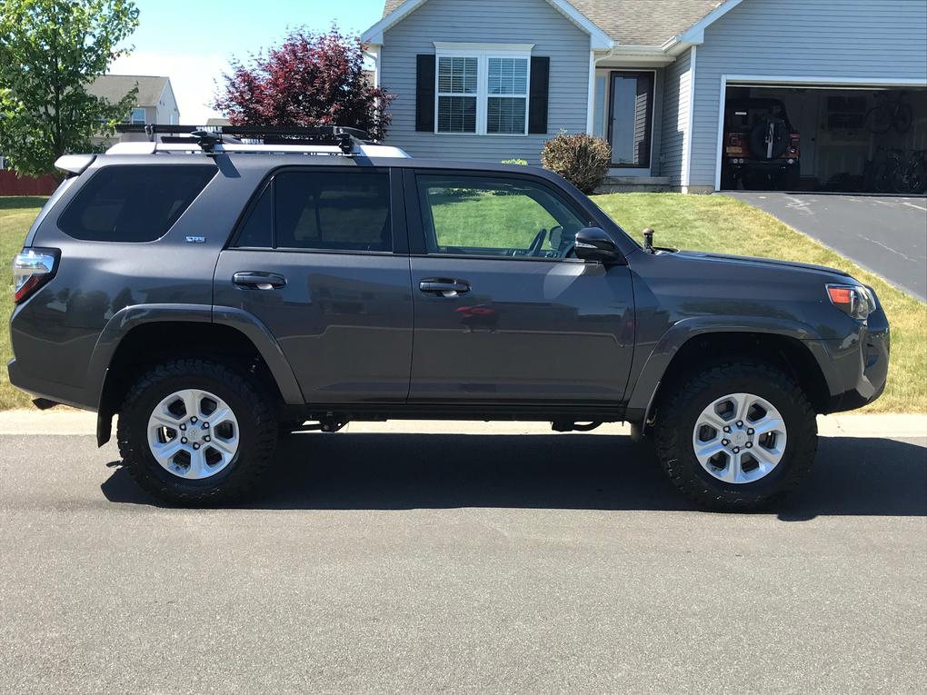

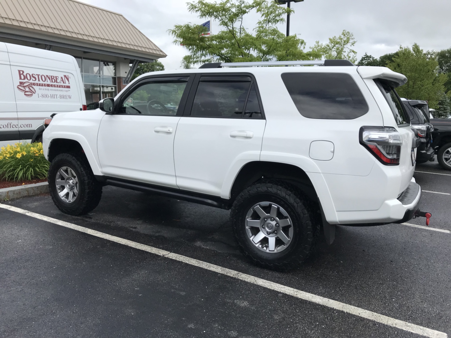

My massively mild lift...
Measurements
Center-of-hub to fender:
~21.50" front
~22.75" rear
From ground to fender (more accurate):
36 1/8" FL
36 1/4" FR
37 5/8" RL
37 7/8" RR
Full tank gas, no extra weight
Front - Toytec 112-620 springs and TT TP14 1/4" spacer on drivers side.
Rear - Wheeler's T13 springs and 1/2" Cornfed spacer drivers side.
ETA: Since this is often used for a reference thread by those shopping, I thought I'd post more details...
Tires are 275/70 K02's. Also worth noting, the TT 112-620 front springs are listed as 1.6" for 2010+ T4R, but both I and my buddy (also has a '18 TRD OR) both seem to be getting greater than 2" with them. He's had his for a couple months, and they settled at 2 1/4" on passenger side and 2 1/8" driver side with the TT TP14 1/4" spacer. I expect things to settle out a bit, but here are my measurements...
Pre-lift
Driver F - 35"
Pass F - 35 1/4"
Driver R - 36 3/4"
Pass R - 37 1/8"
Post-lift
Driver F - 37 1/2"
Pass F - 37 3/8"
Driver R - 38 1/4"
Pass R - 38 3/8"
