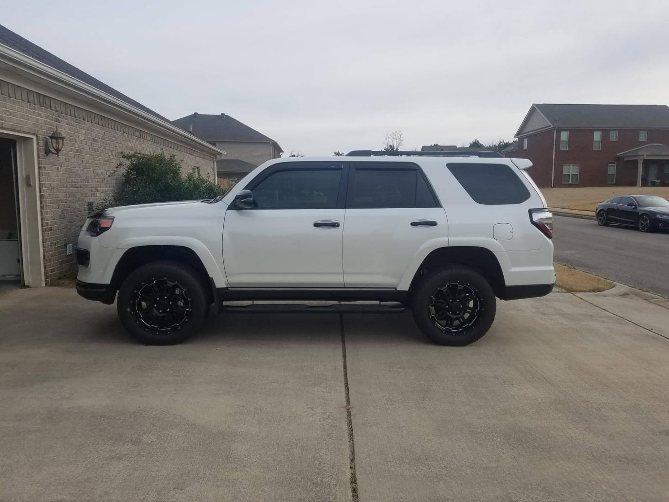

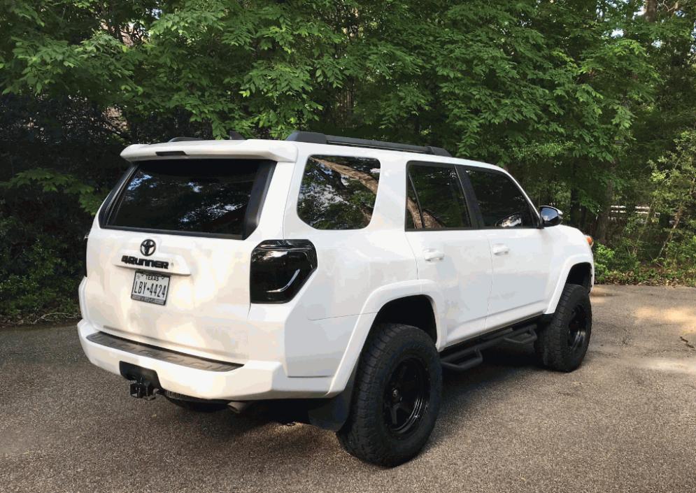

Not the greatest angle, and only 24hrs of settling time, but here's mine...
Dobinsons 300 Front Springs
Dobinsons 574 Long Travel Struts
Dobinsons 327 Rear Springs
Dobinsons 701 Rear Shocks
Diff drop, UCAs, and bumpstops as well; 265/70/17 Wildpeak A/T3Ws

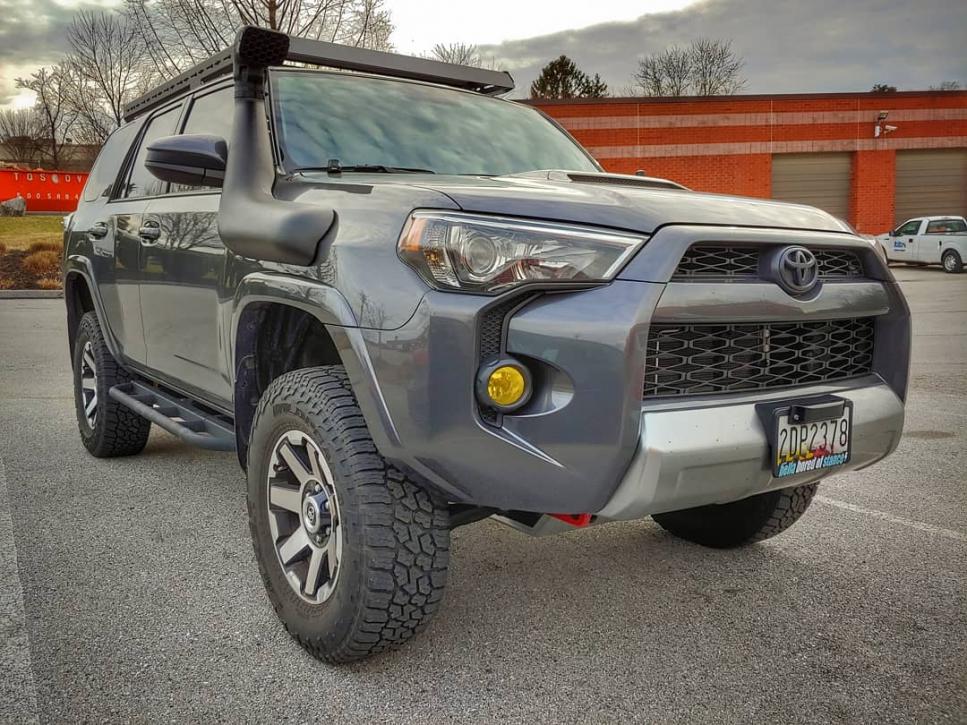

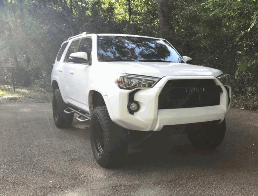

FJ TRD suspension w/ preload spacer & top plate spacer
wheelers t13 springs w/ 2stacked OME trim packers
total chaos UCA
stock trail wheels w/ 1.25" spidertrax spacers
285 70 17 Duratracs

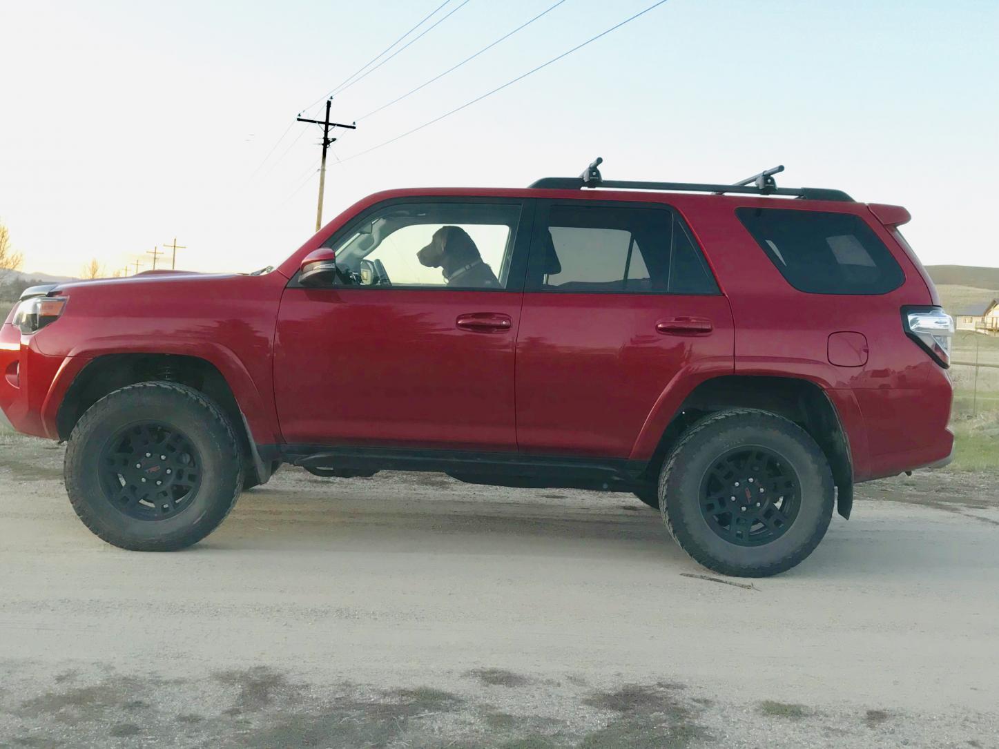

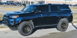

Here's my 2017 TRD OFF ROAD PREMIUM w/ KDSS. 6112/5160 combo. Front lifted all the way to the top of circlip and added 1/2 toytec spacer. Placed toytec superflex at the rear w/ a 2 inches lift. Went for a 1.5 inches wheel spacers by synergy. Kept my stock trd off road wheel I like the way they look and put 285/70/17 Nitto Ridge Grappler. Did a minor cut on my front mud guards but no body mount chop. Has rubbing in front but only on reverse full turn when car is leaning to one side but bearable very small rub. I hope this will inspire new guys wanting to do the same set-up or some ideas and how it will look. Proud to say I lifted this bad ass on my own. Can't wait to put this on it's paces. Hope everyone appreciates it! :)

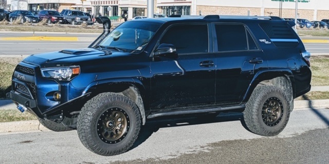

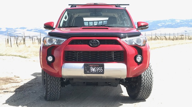

FJ TRD kit (6112/5160)
*1.25" Daystar spacer + Wheeler T13 rear coils + OME trim packer on driver side
*2"/1.5" lift.
*285/70/17 Wildpeak A/T3W

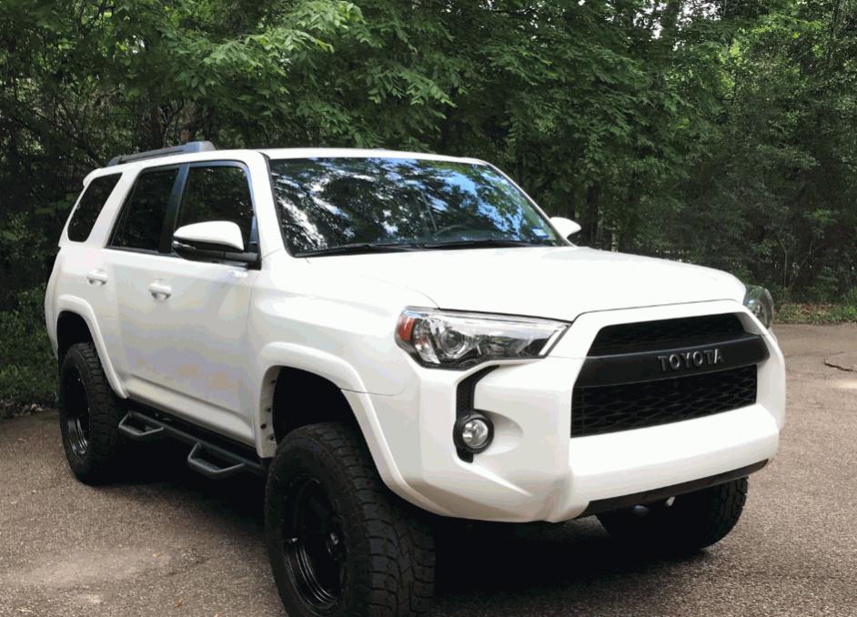

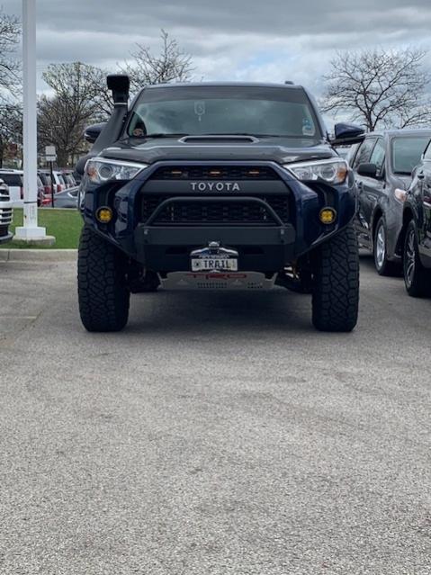

2019 Limited NightShade
3K miles
275/55-20 XP wheels ( South east Toyota dealership wheel package with WORN OUT BFG Rugged terrain tires lol thinking Cooper AT3 XLTs are the replacement tire I will be going with
~5 hrs install including lunch.
Ready lift spacers F/R (+3" and leveling)
Bump stops F/R by DURO Bumps/ toyotabumpstops
F. Diff drop
F. Sway bar relocation kit
Skid panel spacers
We took our sweet time :)
Now to get an alignment.
Still tracks straight but
have about .2 POSITIVE camber and perhaps a little tow out.
Anyone heard of waiting a couple days to get an an alignment in case things "settle in"???

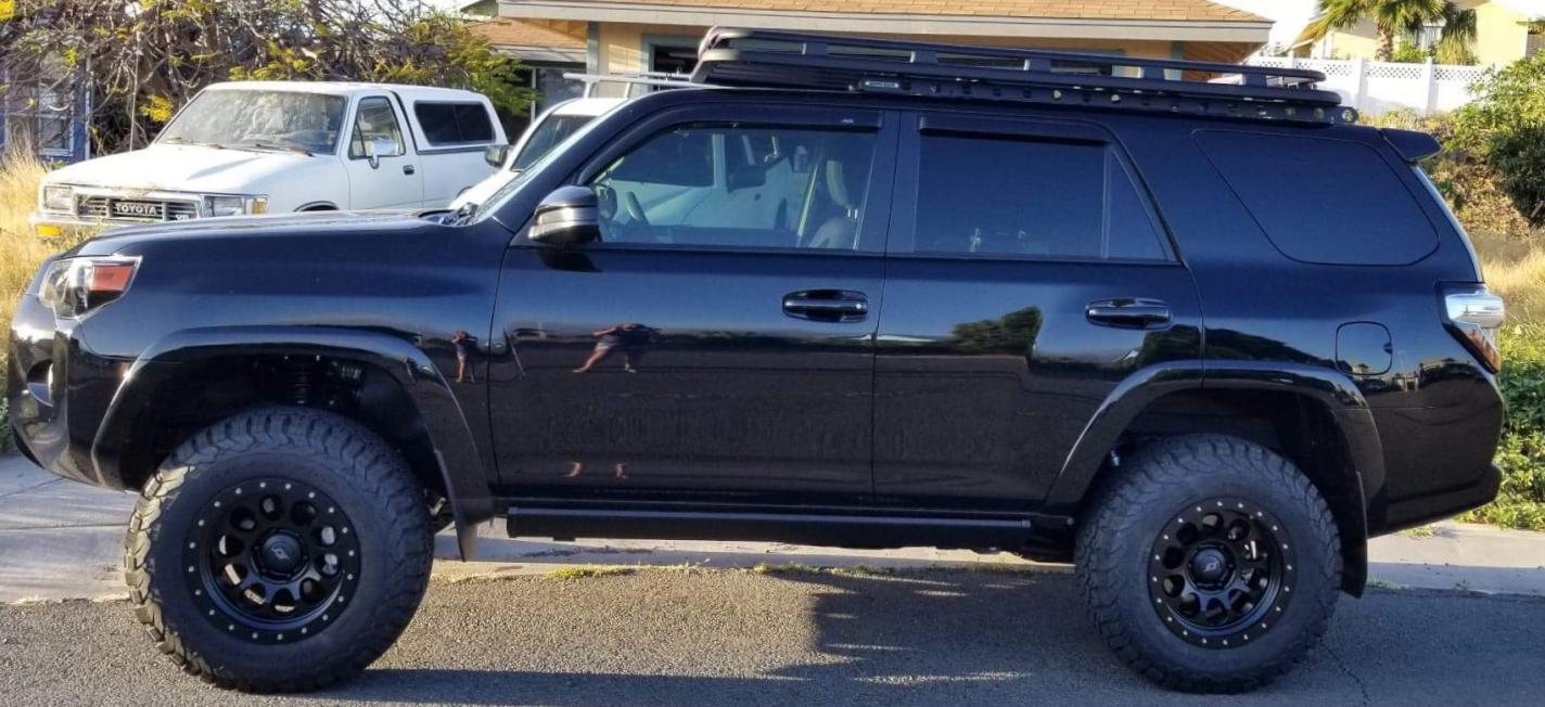

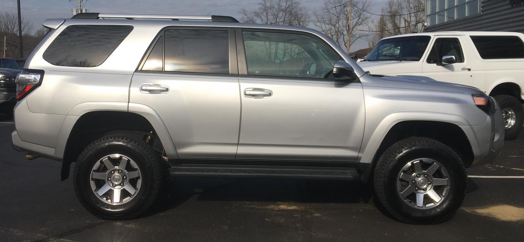

2015 4 RUNNER 3" arb ome heavy springs front and rear
