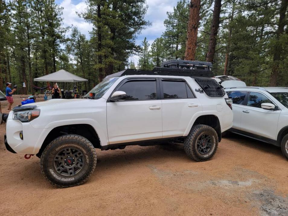

My small 4R
Sent from my Pixel 5 using Tapatalk
Eibach front coils are like 620lbs were the dobinsons are 585lbs. I don't plan on adding a winch and I wanted a softer ride. Just the opposite with the rear the dobisons are 220lb and the eibachs are 205lb. I emails pretty much every manufacturer to find a great setup for my build
Good info. When I looked into lifting the 4Runner, there wasn't many options that had matching front and rear springs with 2.5" of lift (i like the factory rake). The Dobinsons springs are nice, but I feel the rear shocks don't always handle the spring rate in certain conditions. I don't have any extra weight either.
Yeah dobinson rear springs are 220lbs which are great if you got some weight in the back. In which I might try out since ill be putting a tire carrier on the back shortly. But eibach did something right when they built these struts and shocks, they are amazing.

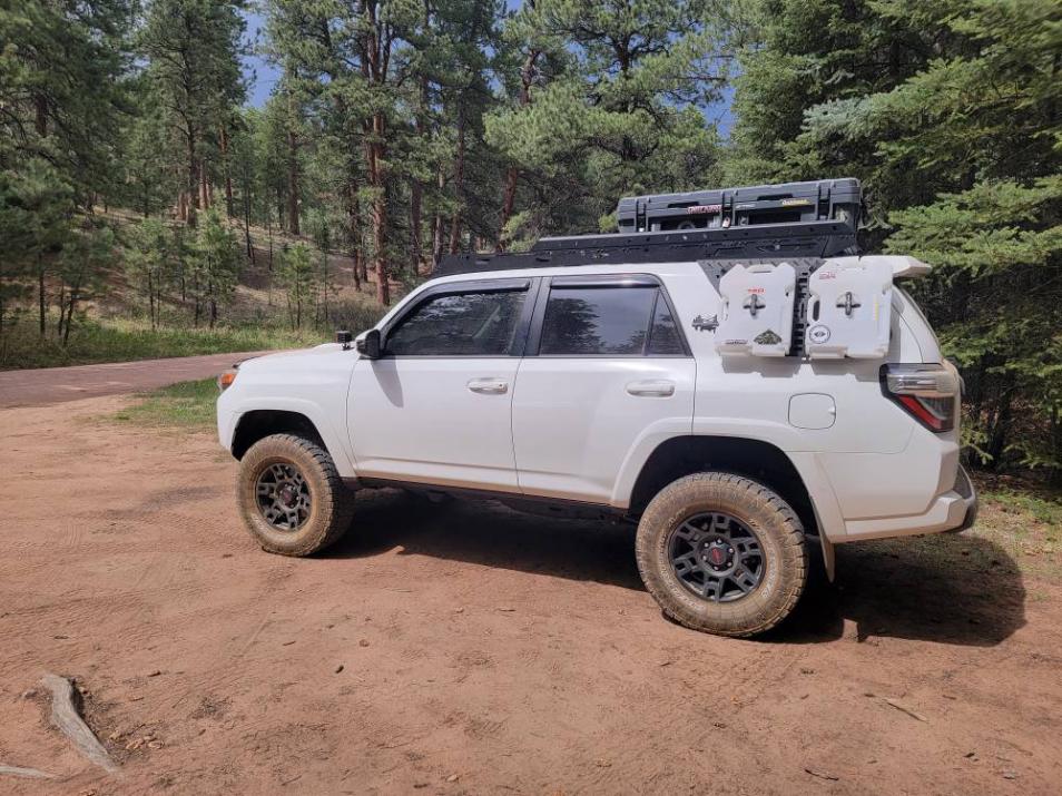

Dobinsons IMS 3/2.75, Dirt king tubular UCS, Toyo AT3 285s20220527_160458.jpg20220529_150358.jpg

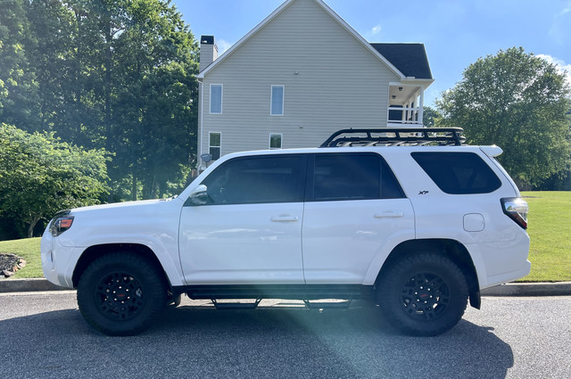

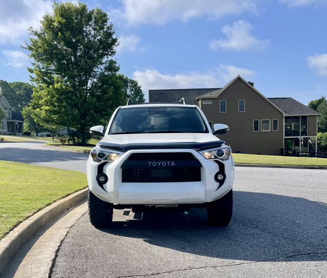

Bilstein 6112s at clip 6/4 and Bilstein 1.5" rear springs with 5100s. Cooper AT3 255/75

So I’ve got different tires, but the same size, on the highway do you feel like the ride is more planted or more top heavy/wobbly since the lift?
One of the things I really dislike is the softness of the stock suspension at speed on the highway.

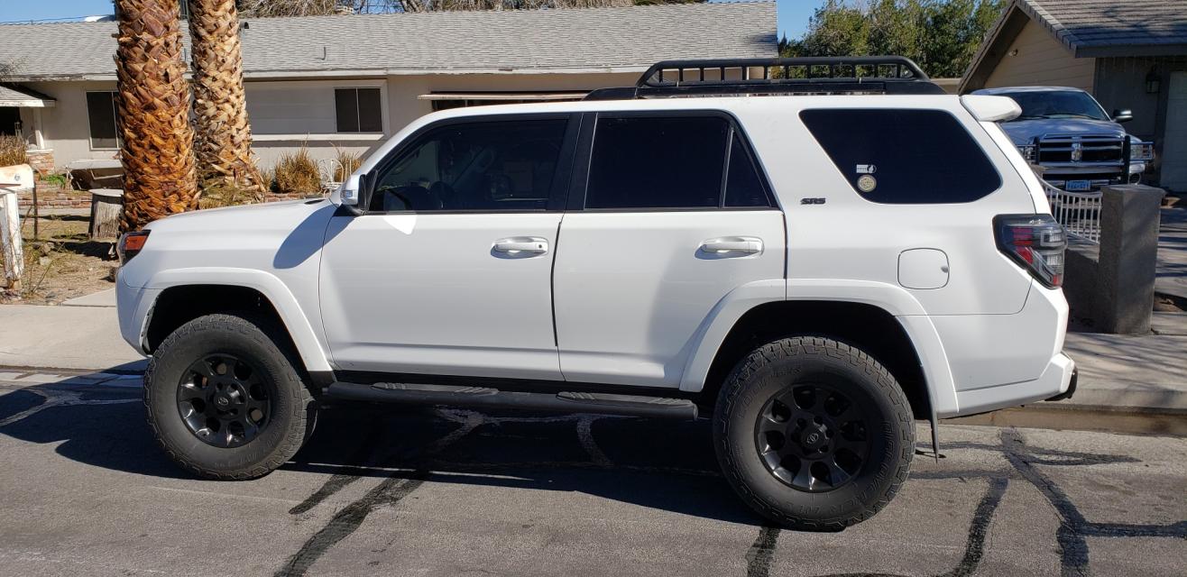

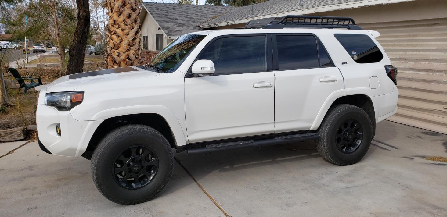

2016 TE w/o KDSS, Icon coilovers, shocks, and UCA, Dobinsons 701v rear springs, Falken Wildpeak AT3W 285/70/17, SCS F5 17x8.5 -10mm offset.
All of this was installed by the PO and they did have a BMC done. I'd love to go a size or two bigger in tire but I'm really unsure whether it'd take more work (pinch weld, etc). I know I may have to consider a re-gear but I'm mainly speaking here of measures necessary for fitment. Thoughts?
