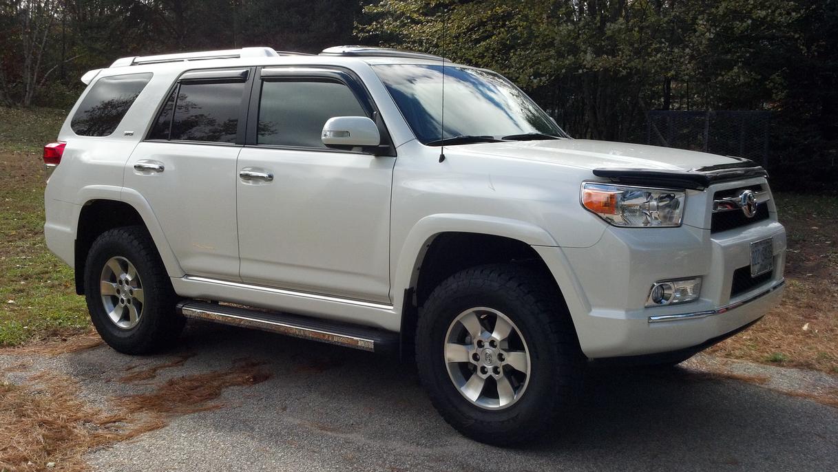

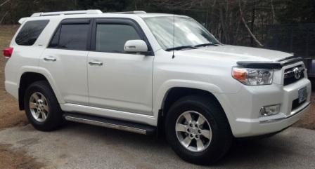

Before;
After;

Looks good! How do you like the ride with the Daystar? Did you need the UCAs to get your truck back into alignment? I too am researching some less expensive lift options for my DD to fit 285s...
Thanks FatTires,
Rides like stock, love it! What Daystar doesn't tell you is that when you lift the front;
  • Factory UCA will hit spring when suspention is fully extended
  • Factroy balljoint will bind when suspention is fully extended
  • Caster adjustment will max out at 0 degrees
LR UCA's don't hit springs, balljoint allows more angle without binding (and is adjustable), current alignment is +4 caster. Easy to install, took me 2 hours to do both sides.
Rear lift was easy with no issues.

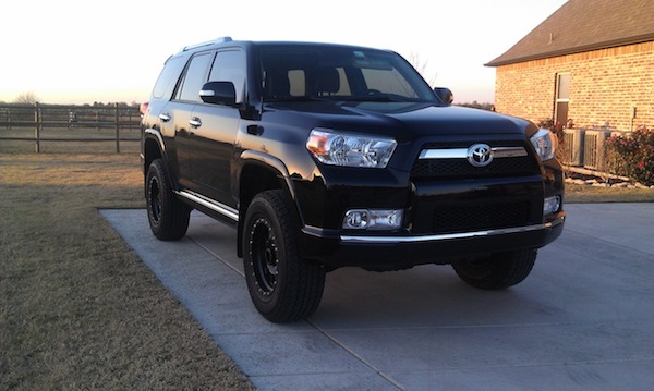

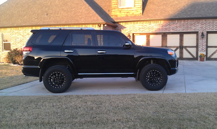

Progress! New Method MR301s: 17x8.5, 4.75" BS, 0 offset. I love these wheels! They are perfectly flush with the mud-guards and look great. The +1.5" width makes the 275s look pretty good.....still leaning toward upsizing to 285s though. Bigger is always better, right :shrug:

Looks good KC :bigok:, I was torn between black or polished ring, went with the polished ring as mine is silver and figured I could always get the ring podwer coated if I wanted to change it up.
Wheels look great KC! I've been toying with either these, the six shooters, and the X's. 285s would definitely look great on there!
Wow. That would be a tough choice....all great wheels. I liked the silver accents on the MRs to coordinate with the SR5s chrome.

We have different opinions haha. The silver bolts of the 301s are what I'm not so sure about. I don't think they look bad, but I have NO chrome left on my TE. I just feel it might look a little out of place. I wish they made the 301s without the bolts all together and that would for sure make my decision alot harder.
My biggest deciding factor is going to most likely come down to weight of the rim.
You don't happen to have a weight of the rim do you?
I see what you're saying about the silver/ bolts on a TE. I guess you could go with one of their race wheels. I think they come unfinished:
They're a little pricier, but I think the X's are too, aren't they?
Products – Race Wheels « Method Race Wheels
Sorry, no weight on the 301's, but looks like the weights on the race wheels are listed. If you really want to know weights on the 301s just email Method. They are very quick to answer any questions.
