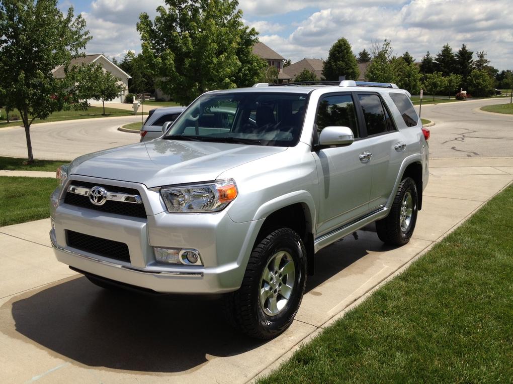

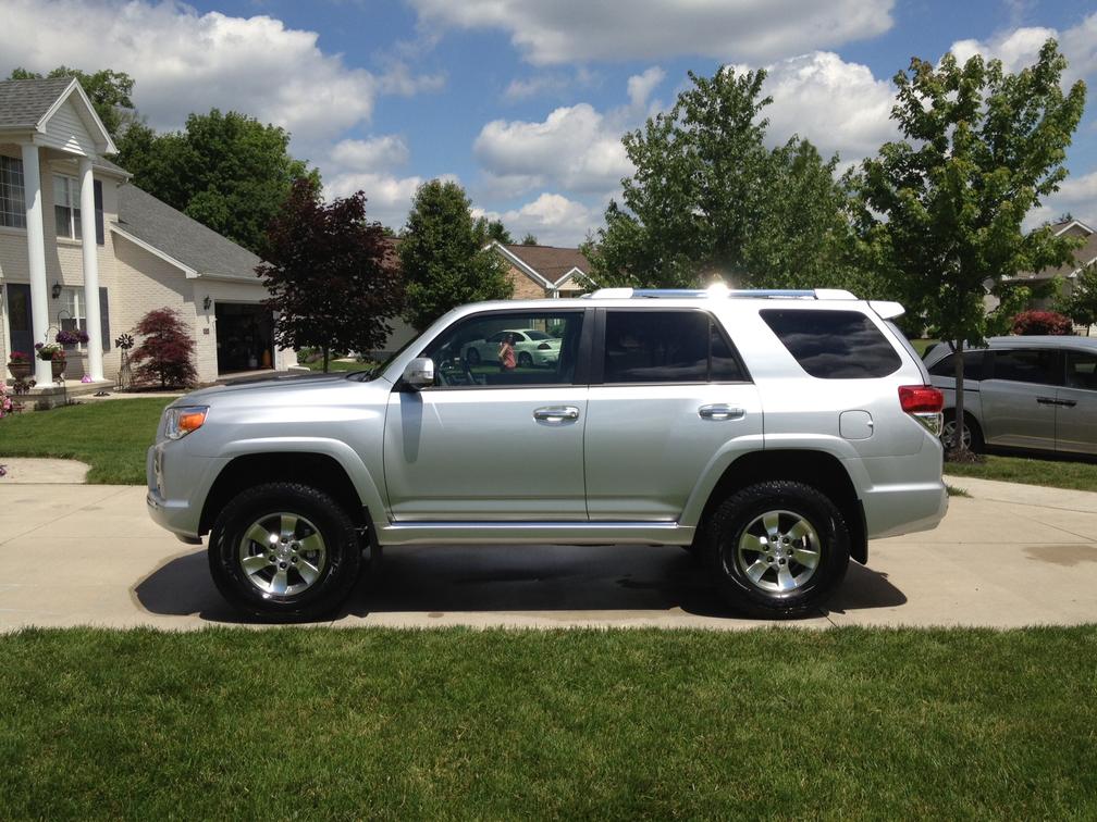

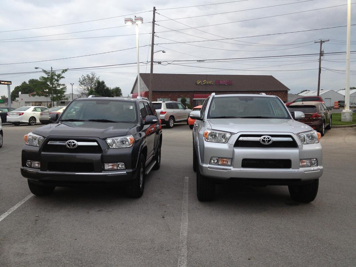

Lift and tires on at 851 miles. I went with OME coils 884/895E and Cooper AT3's in P285/70/17 on stock wheels. Had to move the fender liners forward about and inch and used a heat gun to massage a little more clearance. No rubbing at all now. Tires seem to have mounted much wider than the P275 GY SA's I had on my 2011.
Compared to a stock SR5

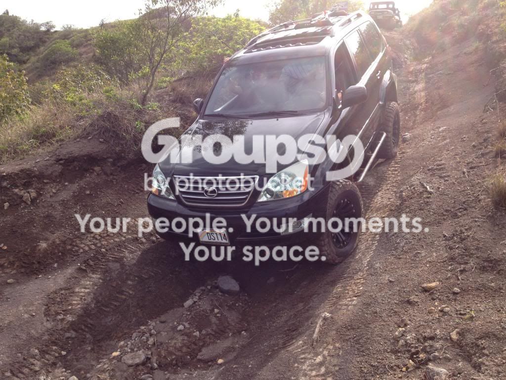

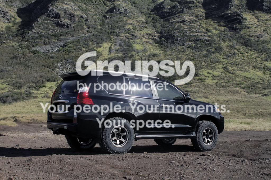

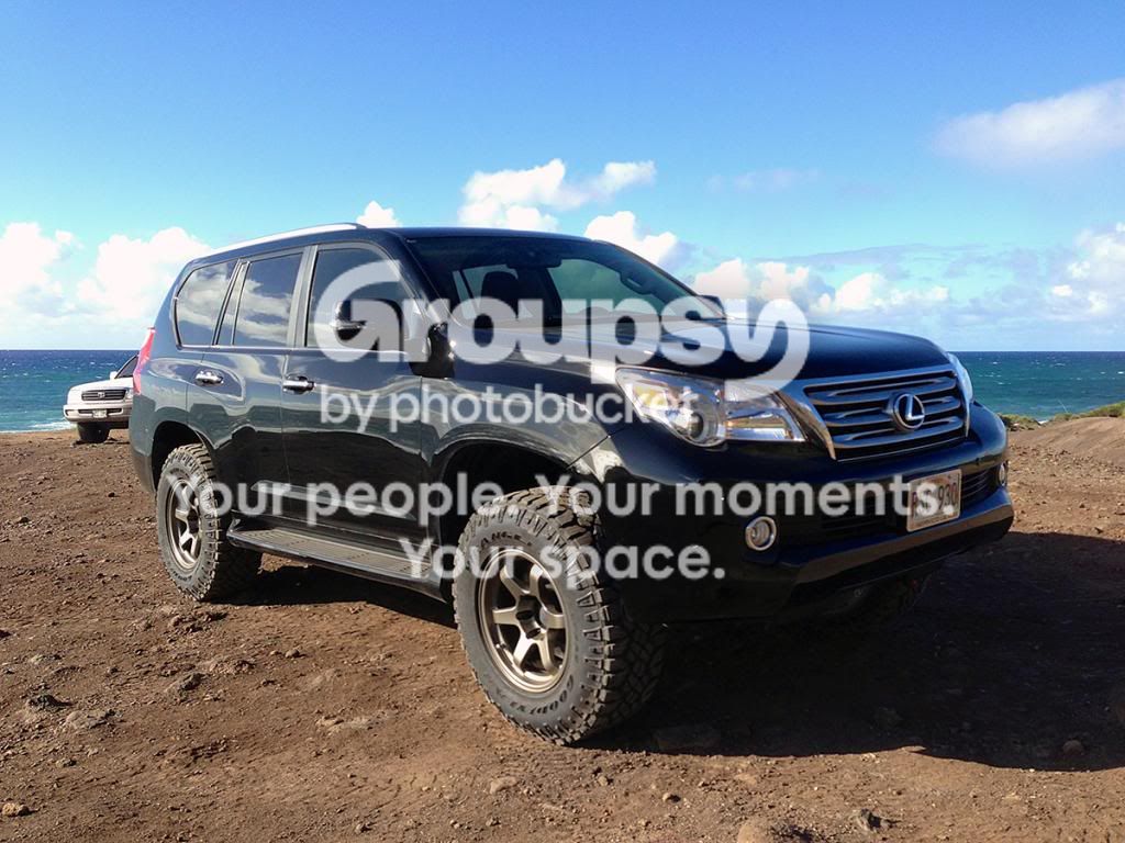

Not a 4runner but its close. As there was not a whole lot of information re lifted GX460s available, I used this thread as a reference in choosing wheels tires and suspension. Thanks for the info!
And my old GX470
