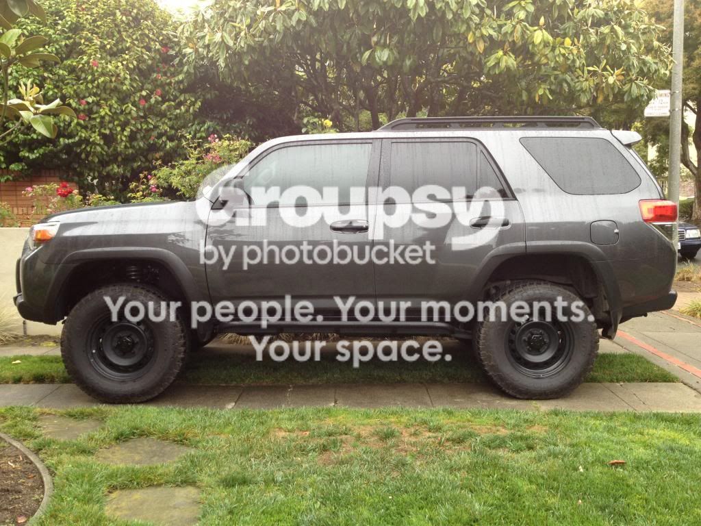

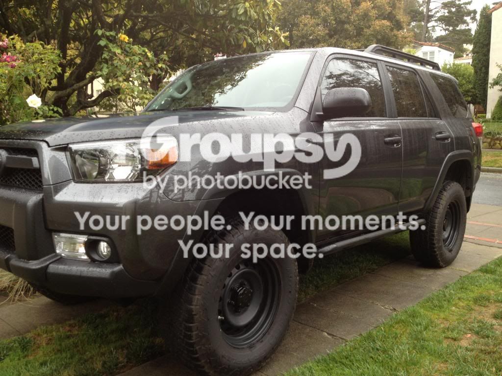

Got my lift situated finally.
Specs:
2011 Trail with KDSS
Toytec Adjustable Coilovers on the front
OME 895E on the back
Bilstein 5100 all around
Light Racing UCA
FJ Steelies with 285/70/17 Terra Grapplers
Measurements from the ground to the bottom of the fender well are 39" in the front and 40" in the back with a near empty tank. The back goes down to 39" when the tank is full.
Hope this helps people research.

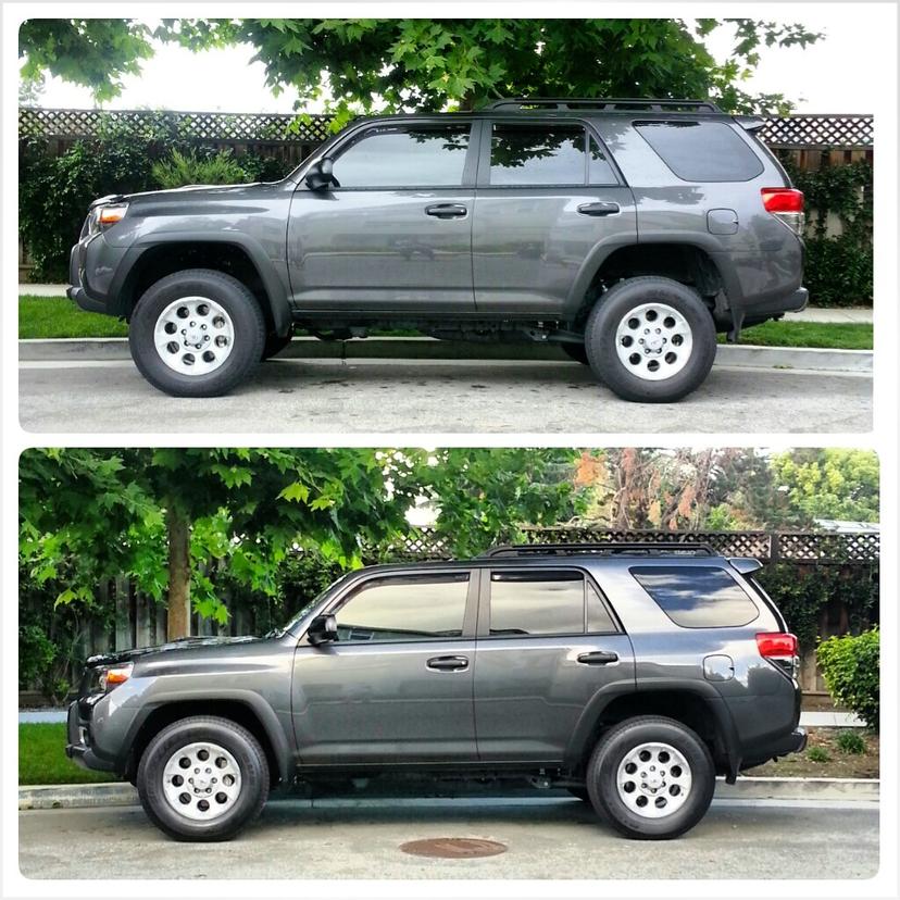

Just put my lift on and hope this before and after picture helps people interested in the same setup.
2012 TE w/ KDSS
Front - Bilstein 5100 set at 2.5" w/ stock springs
Rear - 1.5" spacer w/ 5100 shocks & stock springs
