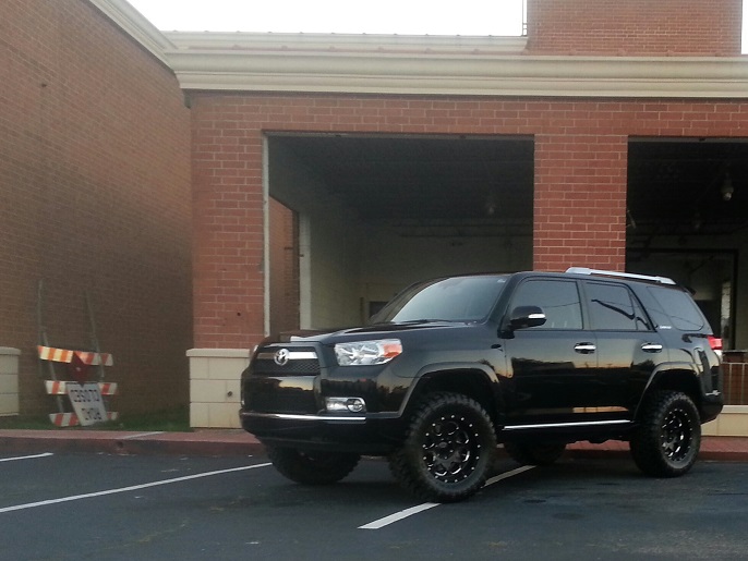

lifted on 35's
Hopefully in time, they'll come out with a full 6" lift kit.. I'm sure we can fit 35's if we reeeally tried :)
Yup 35's fit perfect, with minor trimming and fender relocating

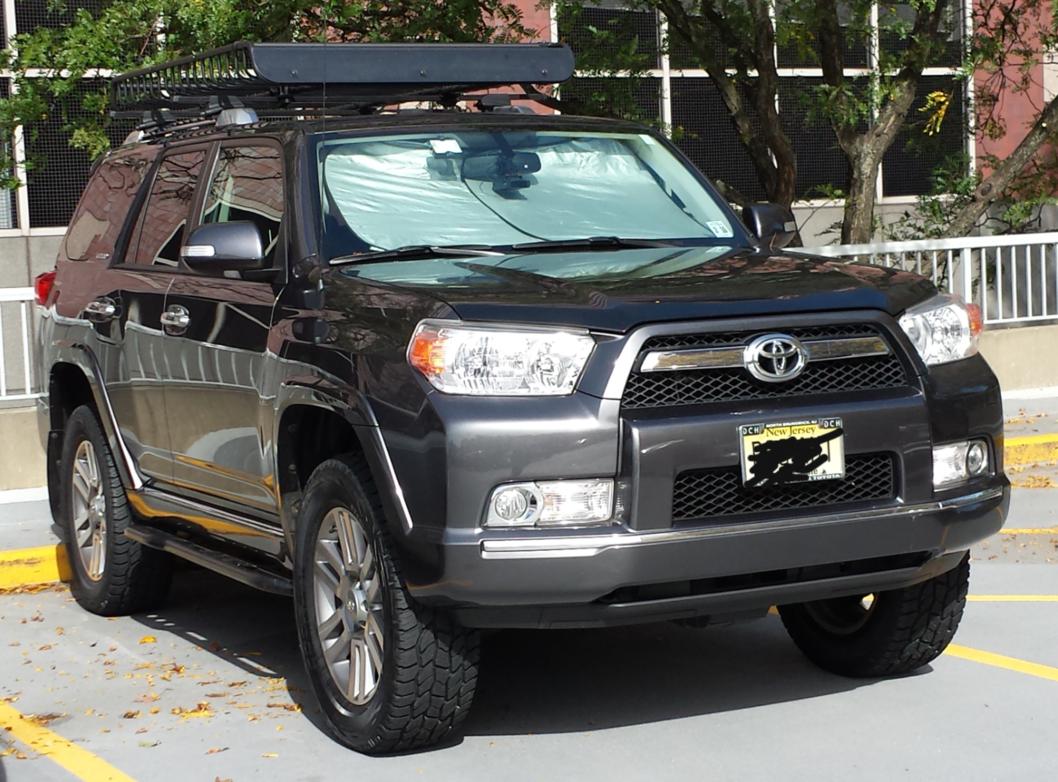

Finally rid myself of the Yokama Geolanders. Great tire put 46K on them but was time to go. Installed the new Daystar 9134 kit on my Limited and added Cooper Discovery AT/3 275/60R20. Love the look and adjusting to the new ride.
Have one issue so far. The garage I used didn't do an alignment and set the PSI around 40. I have a bad vibration when I go over 55 on the highway. Besides get an alignment, is there anything else I should do or be concerned with.
Doing fender mod later today.
Might need to go back or to a different shop and have them re-balanced.
i had a similar issue.
Sounds like wheel balance issues instead of alignment. Find a shop that can do road force balance. Even some dealers haver he right equipment.
Btw, truck looks great.
Spoke with the shop, he said that he doesn't believe his equipment balancer got it done right. Their going to take it to another shop tomorrow morning. I've heard good things about the shop so going to stick with them for now.
