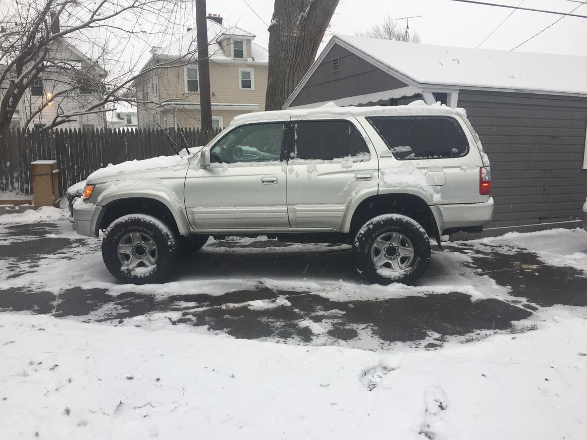

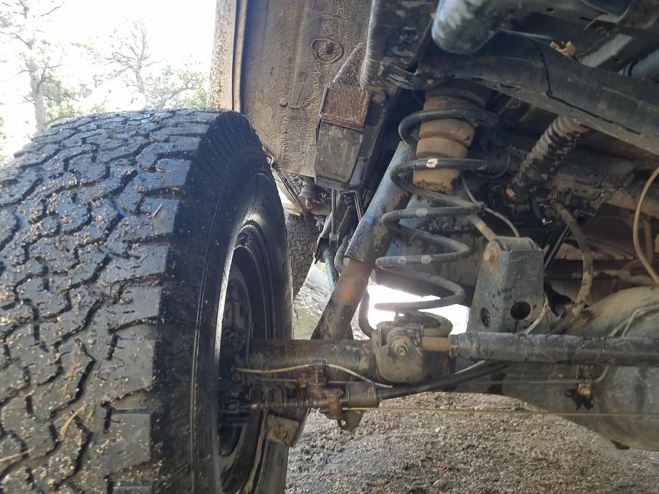

Superflex/5100 rear, 3" ToyTec spacers front.
If I remember right, my rear is 24"- on the nose- axle center to bottom of fender.
New OEM LC 7 wraps
LC OEM Tokico Black shocks
SS lowered bump stops
SS Adjustable Panhard bar
SS rear sway bar lift brackets
2nd gen extended sway bar links

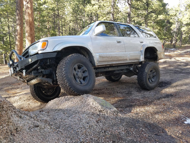

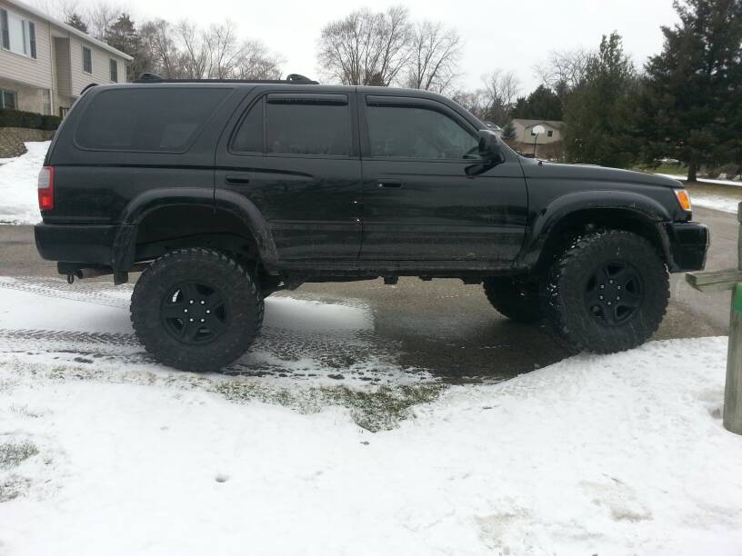

Here is my lift!
Front:
Tundra 5100 (2nd perch) on Toytec coils
Rear:
LC 7.5/8 wraps (used) with new OEM tokico blacks
OEM 4runner wheels on 265/75/16 Wild Country XTX All-Terrains
Hope this helps someone.

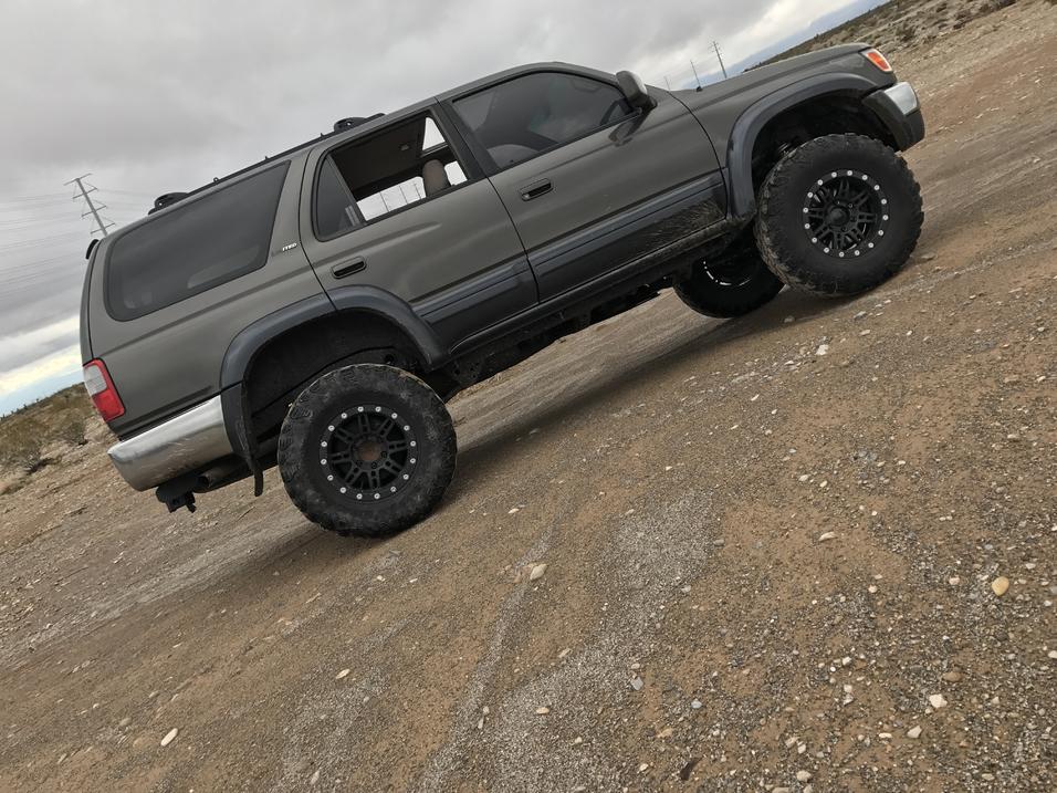

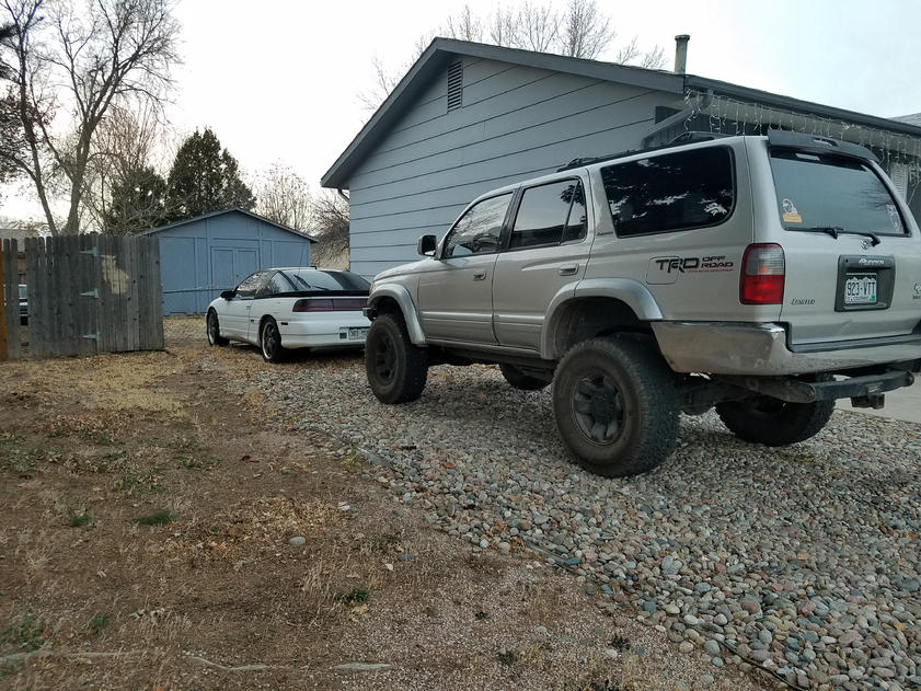

After winch she dropped some up front. This was a budget build do went cheaper up front. So it's got some rake. Just cleaned phone out of pics. This is only level shot I have at moment.
OME 881 coils
OME Sport Comfort Shocks 90004
SS 1" Lift Sleeves (3" total lift)

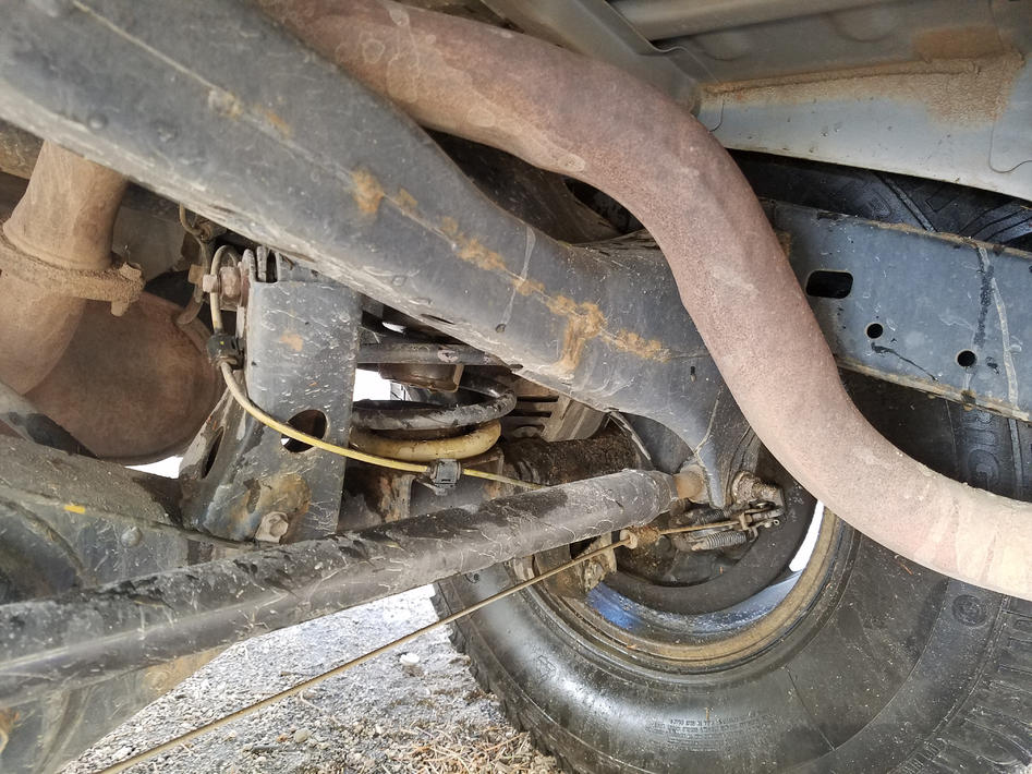

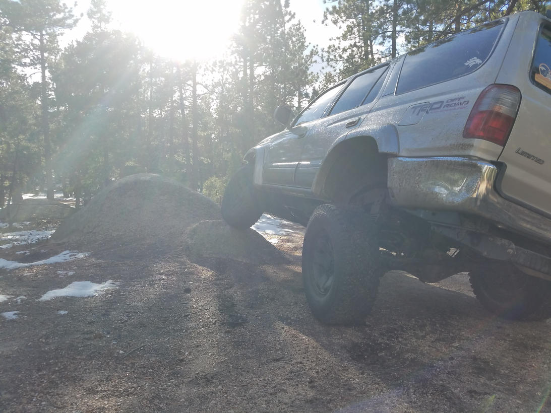

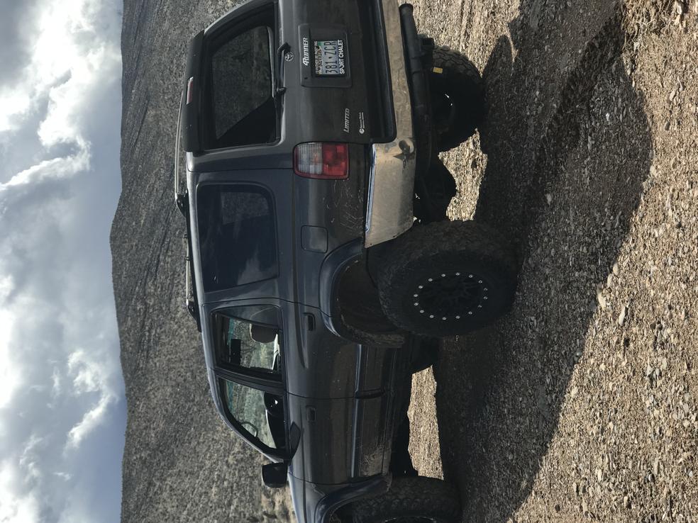

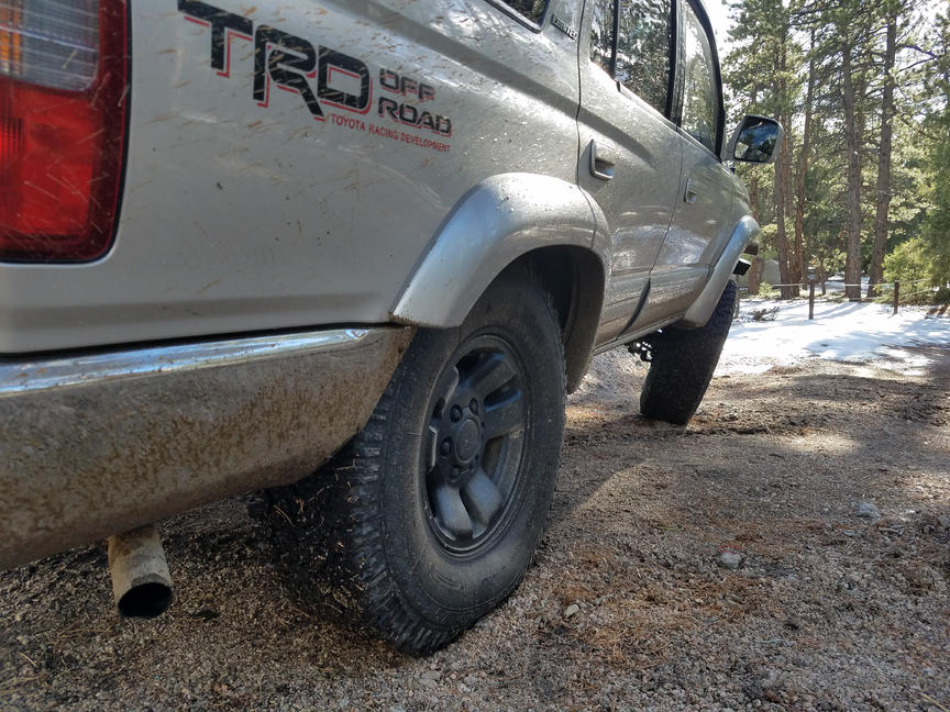

I got some 9 wraps in the rear.. a little too agressive for my taste but could never find the 7 or 8 wraps (impatient). With the 9 wraps, I feel like I'll snap the rear sway bar end links in full droop.. kinda scary.
