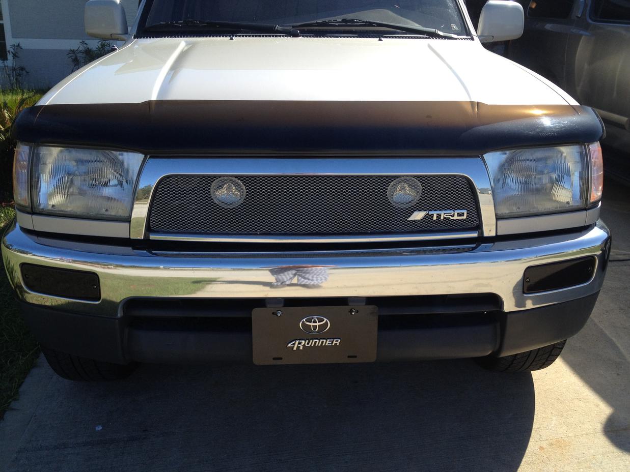

This is mine with a little twist. 3 1/2 inch fog lights behind it.
