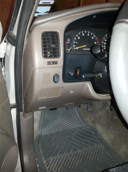

Picture of the switch

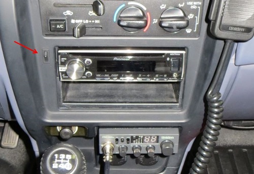

It is indeed a useful mod. Here's mine. My intent was to use it when wheeling in terrain where it (or a whip) may otherwise be damaged. This way you have full antenna control and can still use the radio with antenna down. I use the "Y" adapter so I can run both rear glass antenna + power antenna. Turns out that in most cases I have found the rear antenna to be adequate and do not even need to raise the power antenna...
Space is tight where I put the switch - I had to bend the terminals to get everything to fit. I scribed the cutout with calipers, and then cut the plastic cleanly by heating an exacto blade with a torch. Cut a little at a time until it was done, and then cleaned up with a small needle file.
This is the small rocker switch I used: http://www.amazon.com/gp/product/B008TOXEYS

If anyone needs it, I'd be happy to post more pictures. Don't hesitate to ask.
Everything is still working great and I think I've only used the antenna a handful of times. Nice to save all that wear and tear on the motor.

Yes please, and thank you!
I did this some time ago. My JVC HU keeps the antenna up if it's on. My concern is when I'm on a trail I don't want the damn thing getting destroyed. I have no interest in the Taco whip being I listen to a lot of AM sports radio. Very cheap and easy mod. Cheers -
