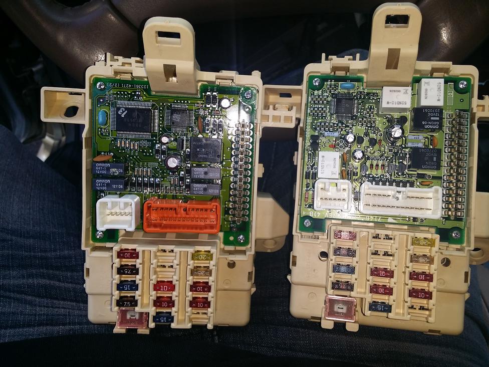

Sorry to bring up an old thread but my 57k milage 4runner had this happen. Dealer wanted 500 for a new bcu and was trying to tell me it wasn't the BCU and were all for door lock mechanisms.... told me not to trust the Internet lol. Anyway I found this part on partshotline.com....I ordered two from two separate salvage yards. The first one that came in was installed and works 100 percent!
See attached image... faulty bcu on left, replacement on right (top covers are off to show the circuit board)

Why do they look different? Especially the orange vs white plug?

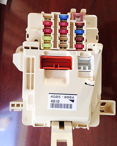

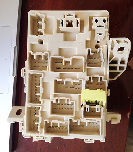

I read this through and it seems the instructions don't replace the entire assembly. My soldering skills are not good enough and I have an entire brand new assembly and want to replace the entire block.
It seems the back connections may be problematic but see no detailed information on any tips and tricks.
I attach images of the exact block I have. I have ignition disable vehicle.
Sorry if this has been covered but I'm not finding any simple discussion.
