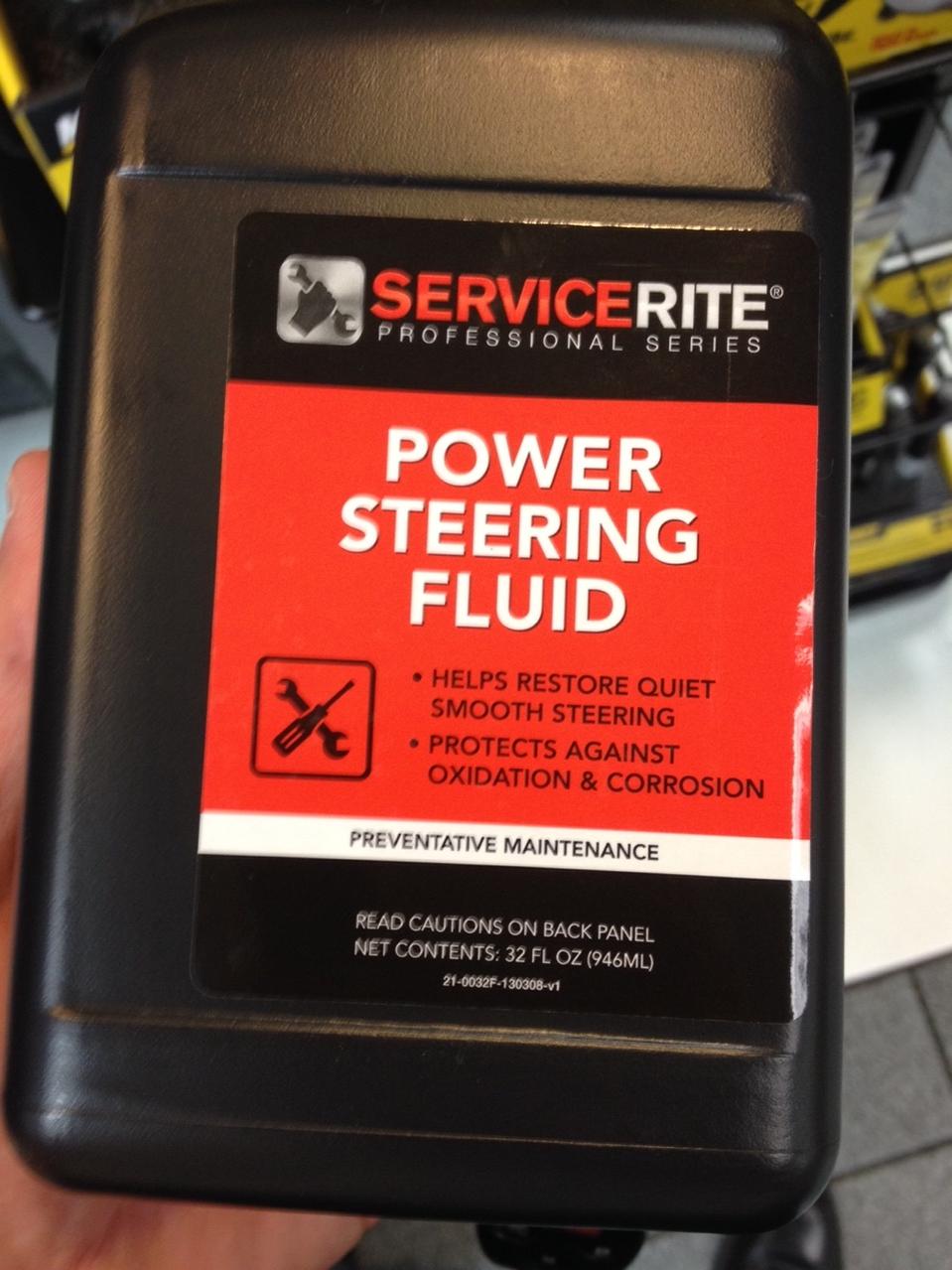

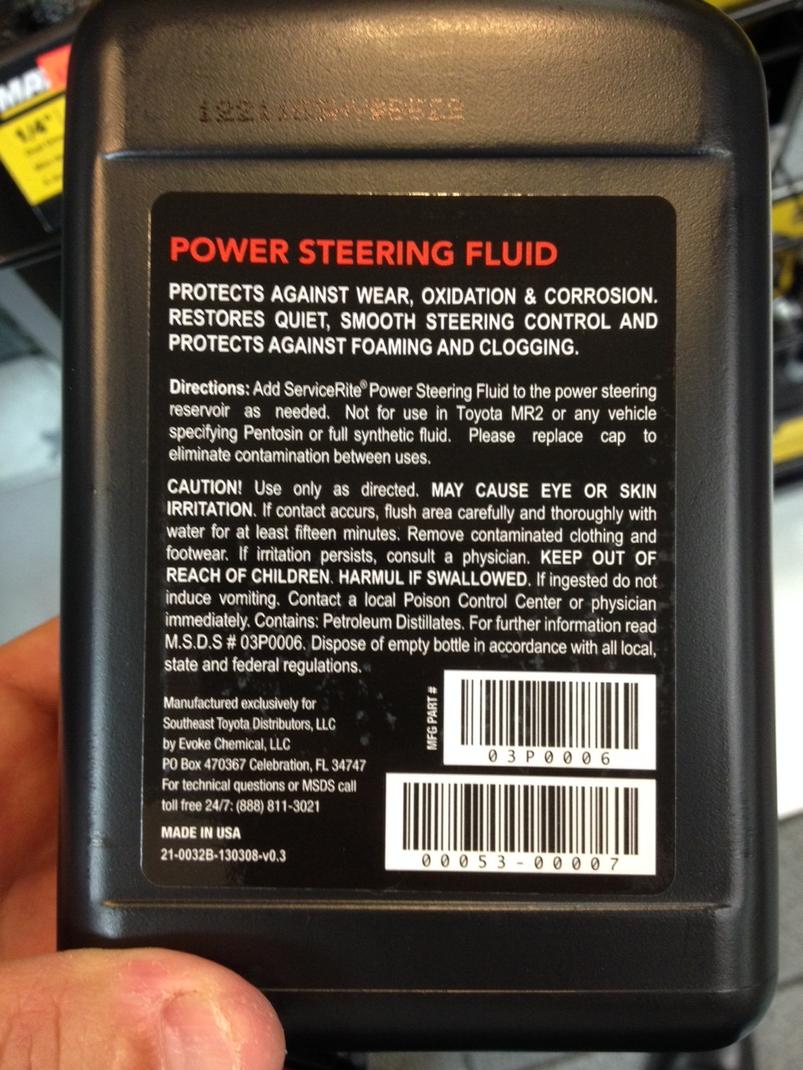

This is what South East Toyota supplies to their dealers. Container does not say Dexron III or II anywhere on it. I called the number on the back and they advised me that it is Dexron III but I don't know if I believe it. Maybe someone has additional info on this.

I contacted Prestone about their PS fluid for Asian vehicles and the response from them was that it is in fact Dexron III ATF fluid without the red die. I think I will be using it next time I do the flush.
Prestone | Products
Lmao some of you guys are batshit insane. If Prestone Asian PSF is dexron without dye for more money then just buy Dexron. It's power steering. I use synthetic in it because I have a bunch of synthetic ATF laying around. Even then, you could run Supertech ATF forever in these things. Age plays a bigger factor in when your power steering system will die, not whether you used some Dexron without red dye.
