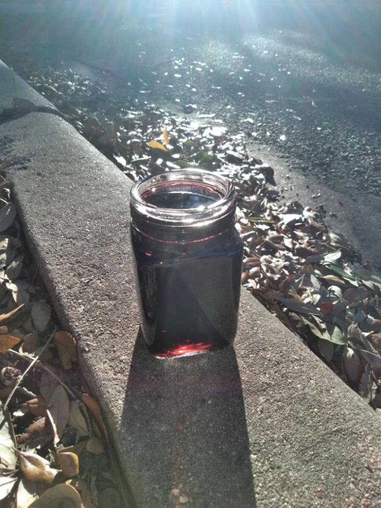

Mine did the same, only in really cold (20s here) and only for about 20 seconds.
So i did an experiment using an old turkey baster. Just suck out what you can and replace with fresh, each time turning engine on and moving steering wheel for a few seconds to let fluid mix, then repeat, say about 5 times.
Now you'll have about a pint of fluid that looks something like this, so dark, not even full sunlight goes thru it.
Result, no more whine or grinding noises, do this once a year and it'll be fine. Luck.
Did you clean the filter in the reservoir?

No. I figured I'd try the lazyman's approach first, if it worked, well it worked. If not, then time to dig deeper as you say do the full flush and filter cleaning. Its happy, for now.
