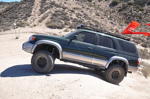

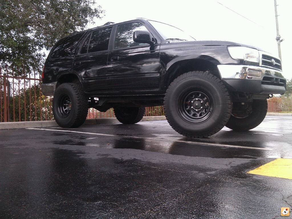

Does anyone have pictures of their rigs with these wheels, or style wheels on? I am having a hard time deciding on which ones to get.
I had the soft 8s on my Toyota pickup and loved the way the looked , always thinking about putting a set on my 3rd gen .
I have the black rock type d steelies. I like em. Same thing as the brocomps. Just a matter of preference, do you like circles or almost-squares lol

I prefer the look of the soft 8 on a newer truck like the 3rd gen. I had the D-windows on my FJ60 and '84 mini truck, and it seemed more fitting on an old rustbucket :D

I've got 17" ProComp 98s on mine, similar to the soft 8s you have pictured. I did have to put 1/4" spacers up front and shave a little off the 231mm calipers to clear. I don't remember what backspacing I have off the top of my head.
IMG_0383_zps87f3a4fd.jpg~original
IMG_0380_zpse53e7240.jpg~original
