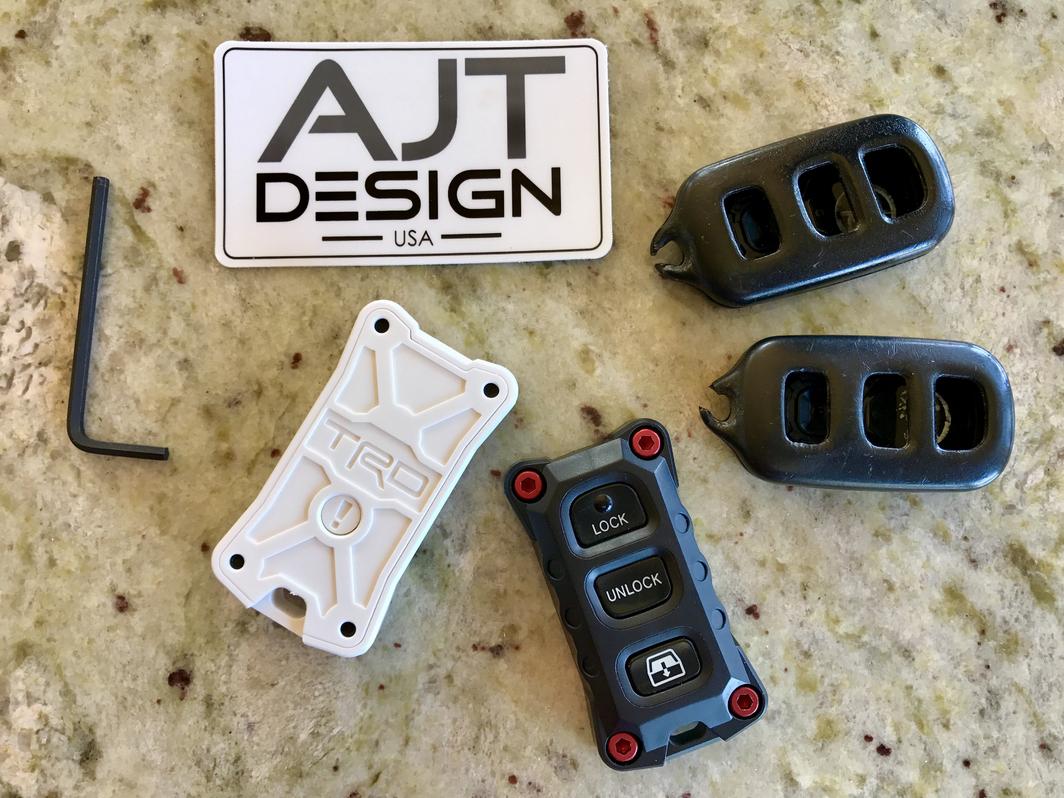

Fixed some broken fobs with AJT Design'd injection molded plastic replacements.
Bought a BROKEN USED one off eBay for $10 & programmed it. I just referenced the FCC ID for a search word.
