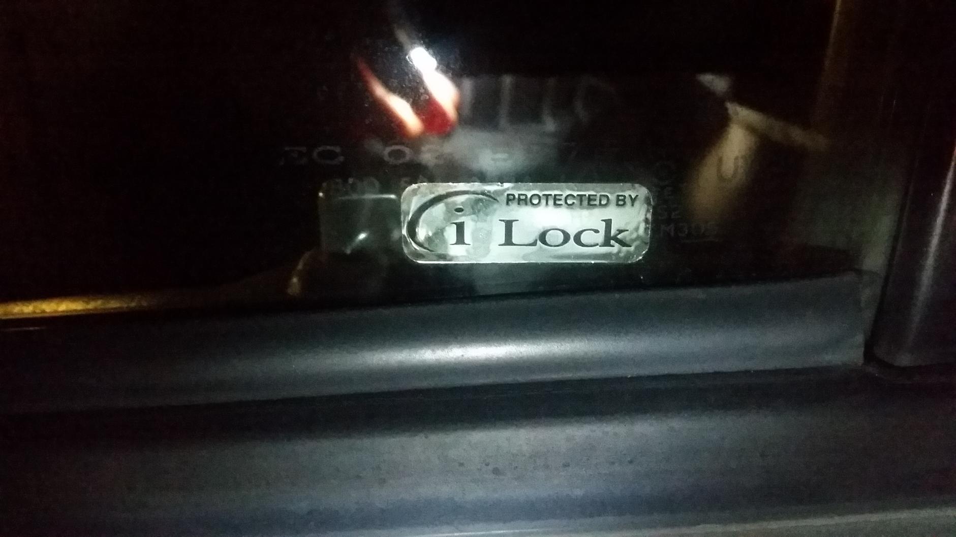

Hi i have a 2001 sport model. Iv tried all of the above (read entire thread) about 30 times now and I can never get the door locks to do a confirm cycle that I'm in program mode or erase mode. So I searched all over my interior and can't seem to find a alarm modual. If I lock the car with me inside and I manually unlock one door and open it the horn/headlight alarm goes off. Only way I can disarm it is too insert key and turn the car on. There is a i-lock sticker on the driver window. Anyone famillar with this? Is it factory or after market? Any help is appreciated iv about given up on it...
