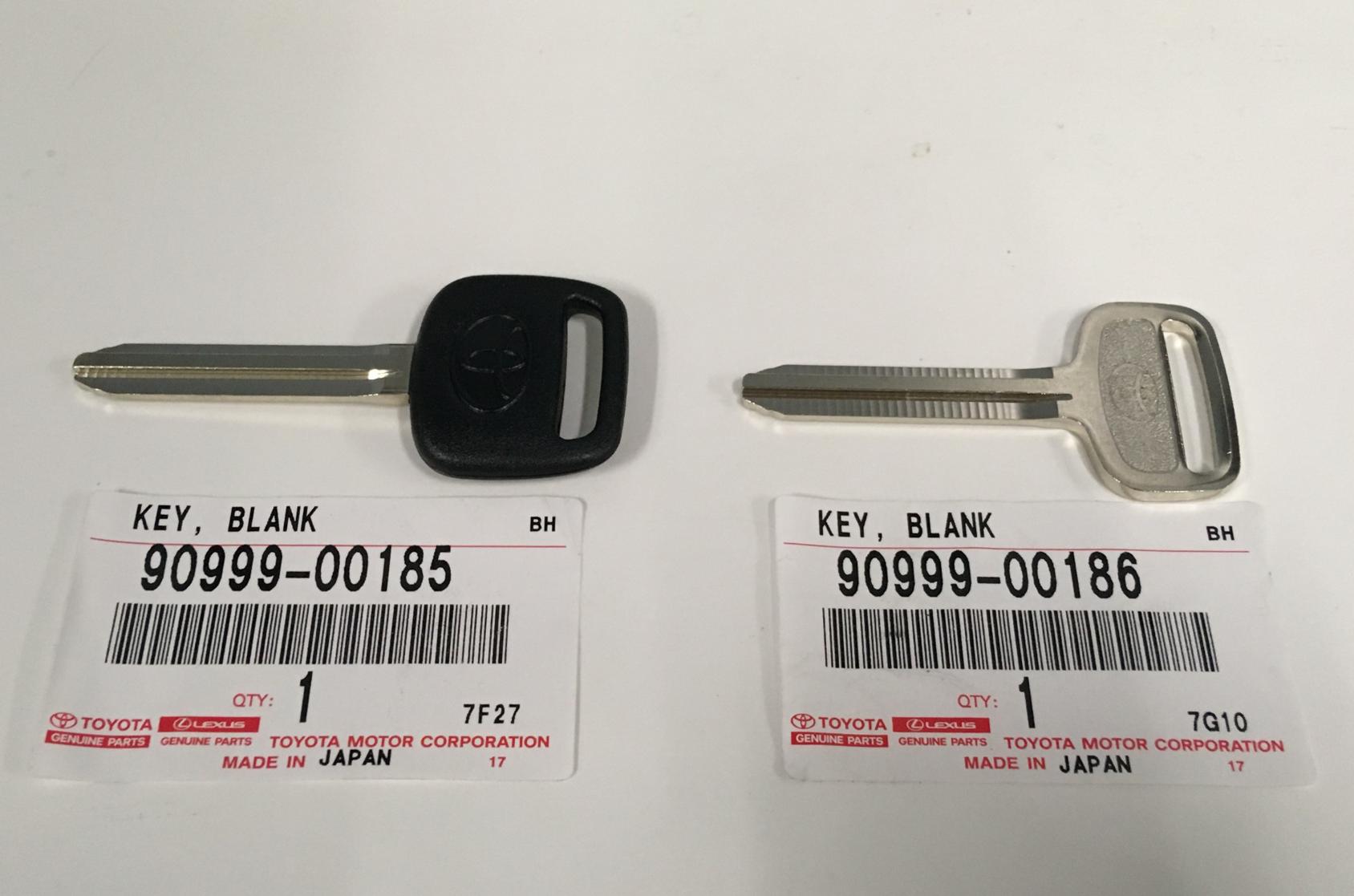

With my swapping of the ignition cylinder on this rig, I wasn't able to use the new key because the locks were different & the broken end of the key I did have got sucked up at the car wash vacuum... oops. This means I have to have Toyota cut a new key from my VIN. They require your ID & registration of the truck in order to make the request to get the key cutting code, so its a little bit of a process...
I ordered part number 90999 - 00186 which is an all metal key. for the ignition I would need a chip key but this is only for the door locks so it wouldn't work in the ignition anyways.
90999 - 00185 is NOT a transponder key! It is simply a key with a rubber/plastic end.
