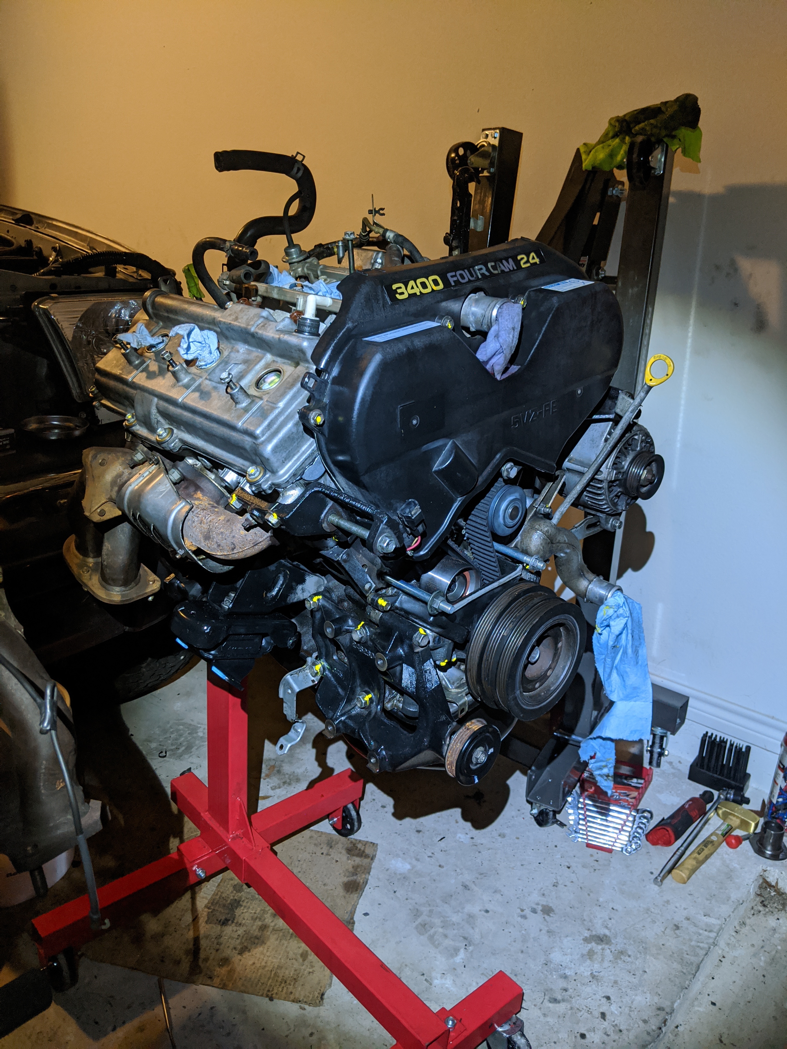

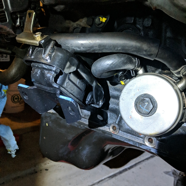

Engine Swap Update #3:

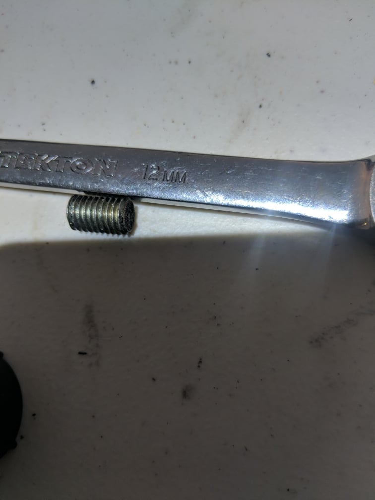

Got the second engine mount on. I swapped over the spark plugs and I got the sheared bolt out from the alternator bracket

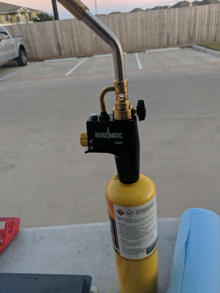

I used a MAP torch (I think that's what it's called) and I took [MENTION=164664]brillo_76[/MENTION] advice and got transfer punch set from HF: Transfer Punch Set - 28 Piece
I heated up the bolt for about 30 seconds then I got a small punch with a small hammer and it came out with zero problems.
So now I got my old alternator bracket and alternator on.
Currently degreasing the engine bay with a water based degreaser safe on all surfaces. It basically just loosens up the dirt and you can let it sit there and it won't stain anything.
Still need to replace oil cooler fittings and I'm going to drop the oil pan tomorrow and reseal it.

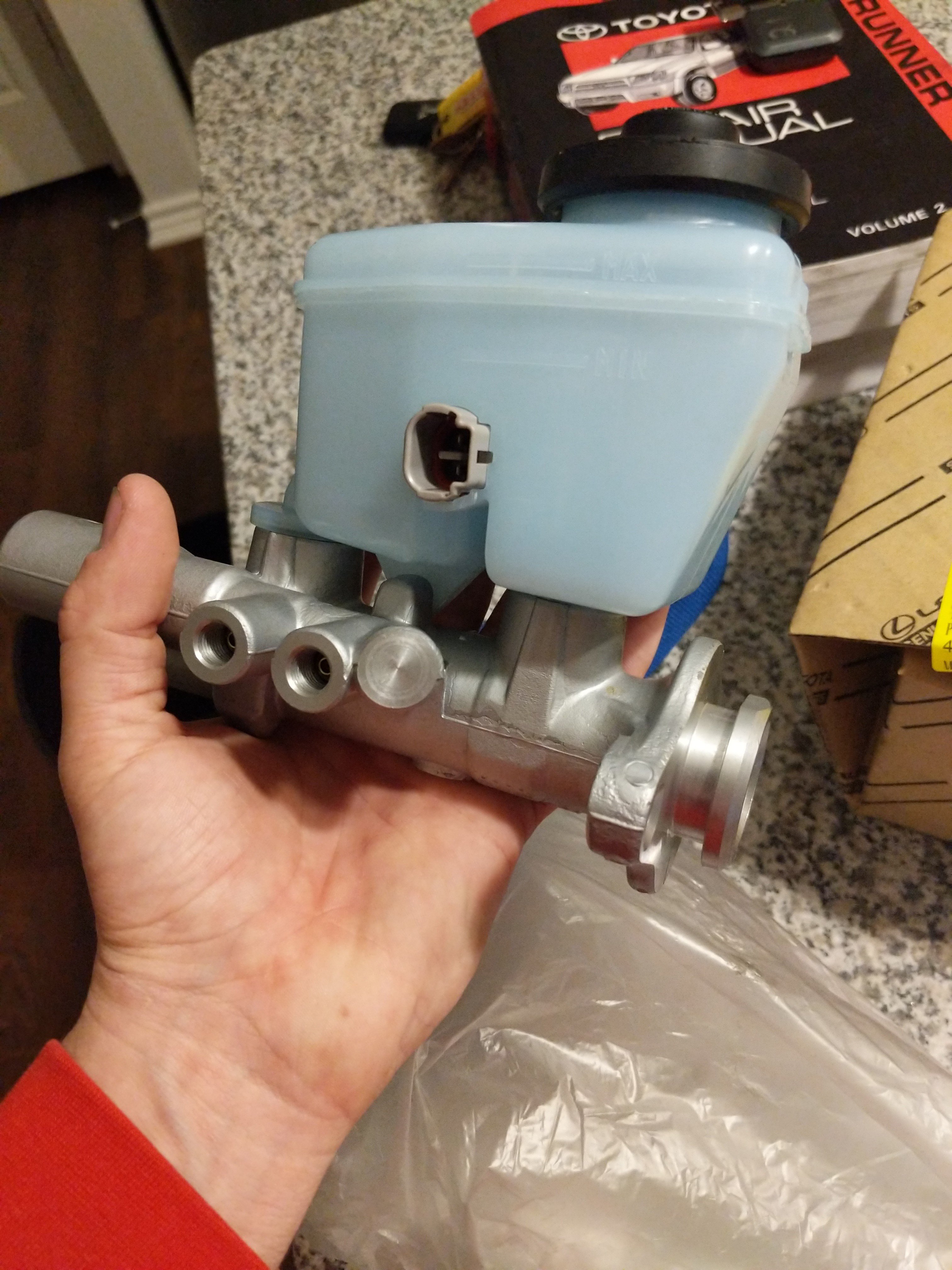

After that I'll swap my brake booster for an OEM one then I'll swap the related gaskets as well. And I'm gunna bench bleed the new master cylinder I got.
The threads on the master cylinder are 1/4inch NPT thread for anyone needing the Barb fittings. to be transparent I got 1/4 NPT thread with 1/8inch barb

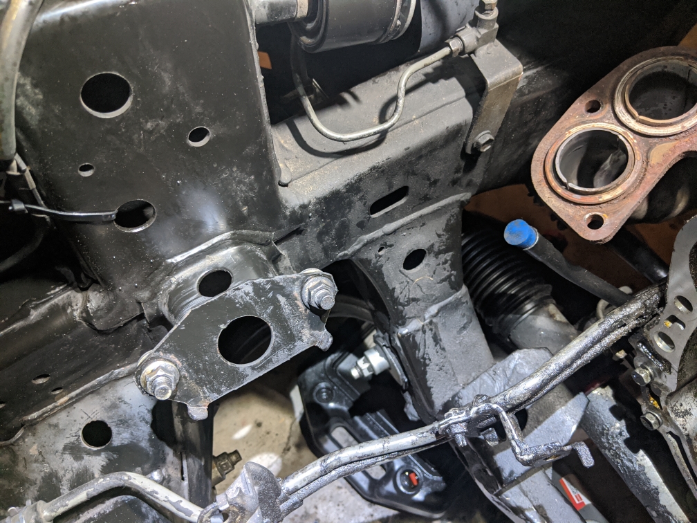

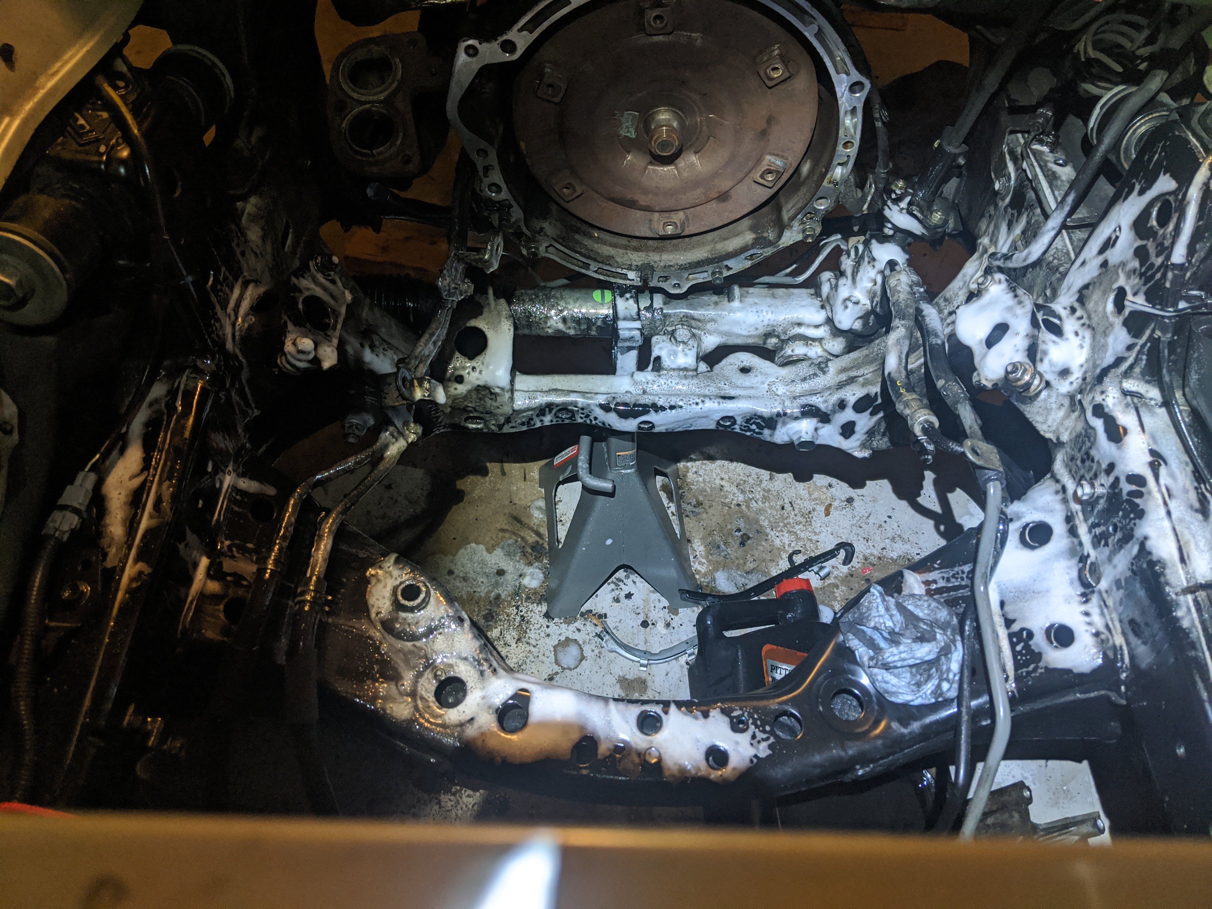

Engine Swap Update #4: Degreasing Engine Bay
Speaking of rust Free....had to use my hands and some CRC water based degreaser....I got alot of.
No access to a water hose or nothing. All my detailing stuff is at home
Overall it's a million times better pretty sure I have couple of pounds of bull crap on the frame.

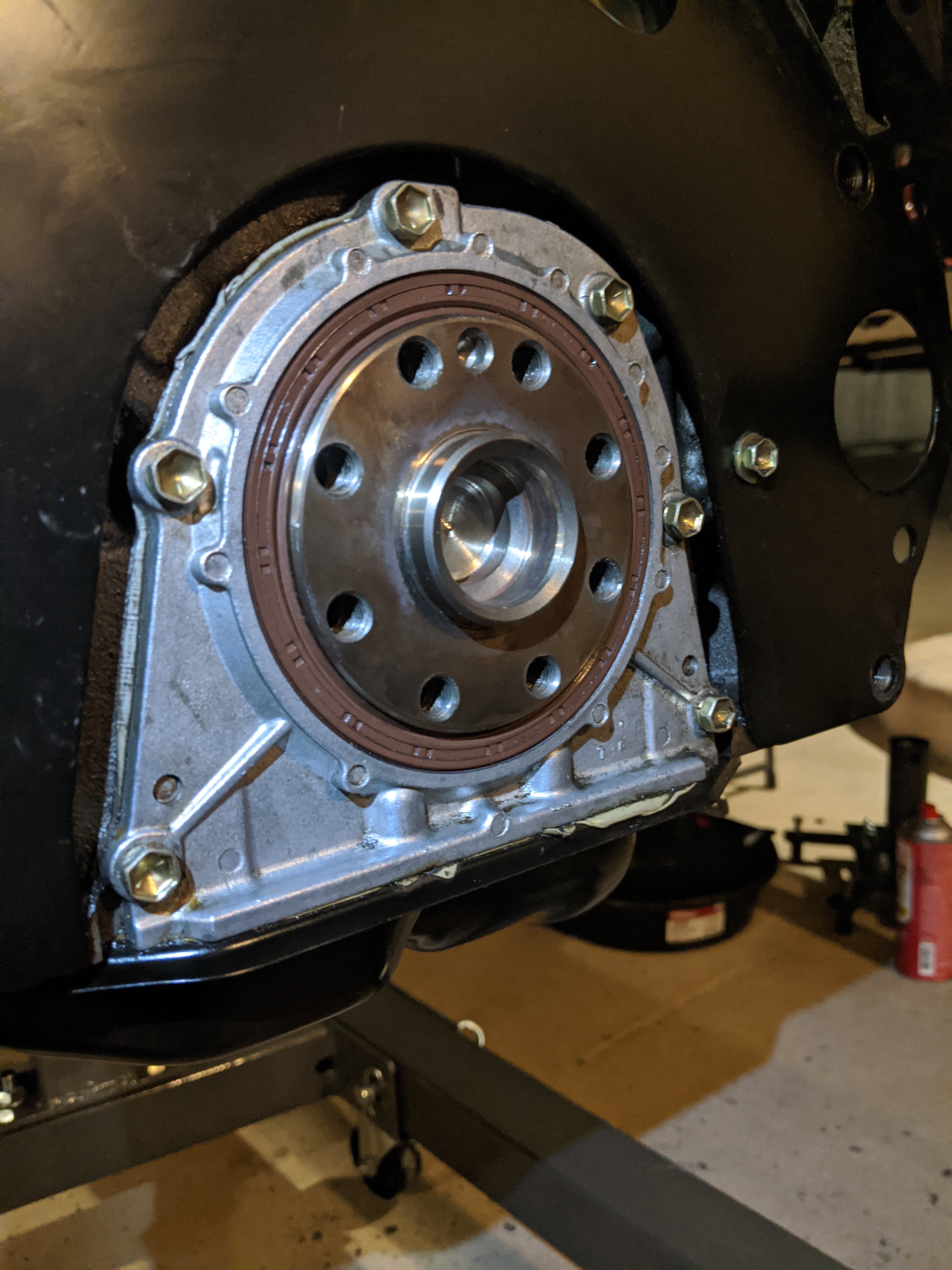

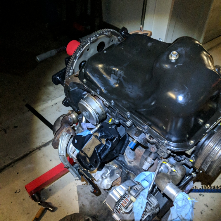

Engine Swap Update #5: Rear Main Seal
Changed out the rear main seal last night.
Special red locktite on the flex plate bolts. I did have to torch the bolts to get the old locktite residue off. Thread chaser wasn't cutting it.
Hardest part was torquing the flex plate.
I just kept the engine hanging on the hoist and use am impact to get all the bolts off and gain access to the rear main.
I also left the Engine hanging when putting the seal on. I sat down on the ground and kept the seal at eye level so I take a better look around the seal to make sure it's seated correctly. The one that was in wasn't entirely Flush with the crank seal retainer.
Per FSM it says to make it Flush....so following the book, that's what I did. Made it flush.

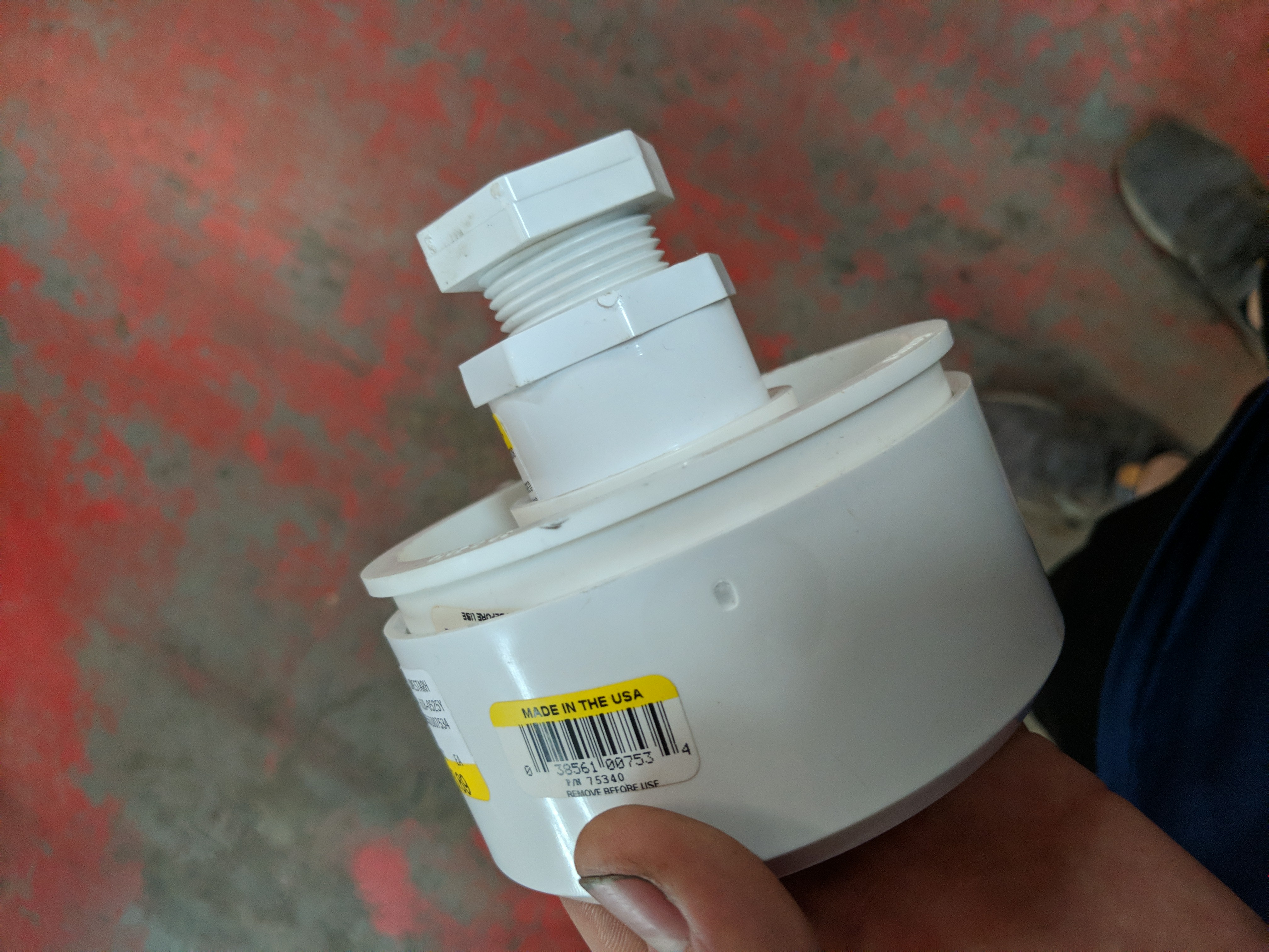

I ran to hardware store to go grab some different pieces of PVC as a seal driver
The CTC of the driveable portion of the seal is 100m on the nose. So if you can find something around 4 inch's out to out as a seal driver or with a flat bearing surface that should be good enough.
Getting the old seal out was a challenge it was in there. Made a few light scratches lol oh well. Of it leaks it leaks.

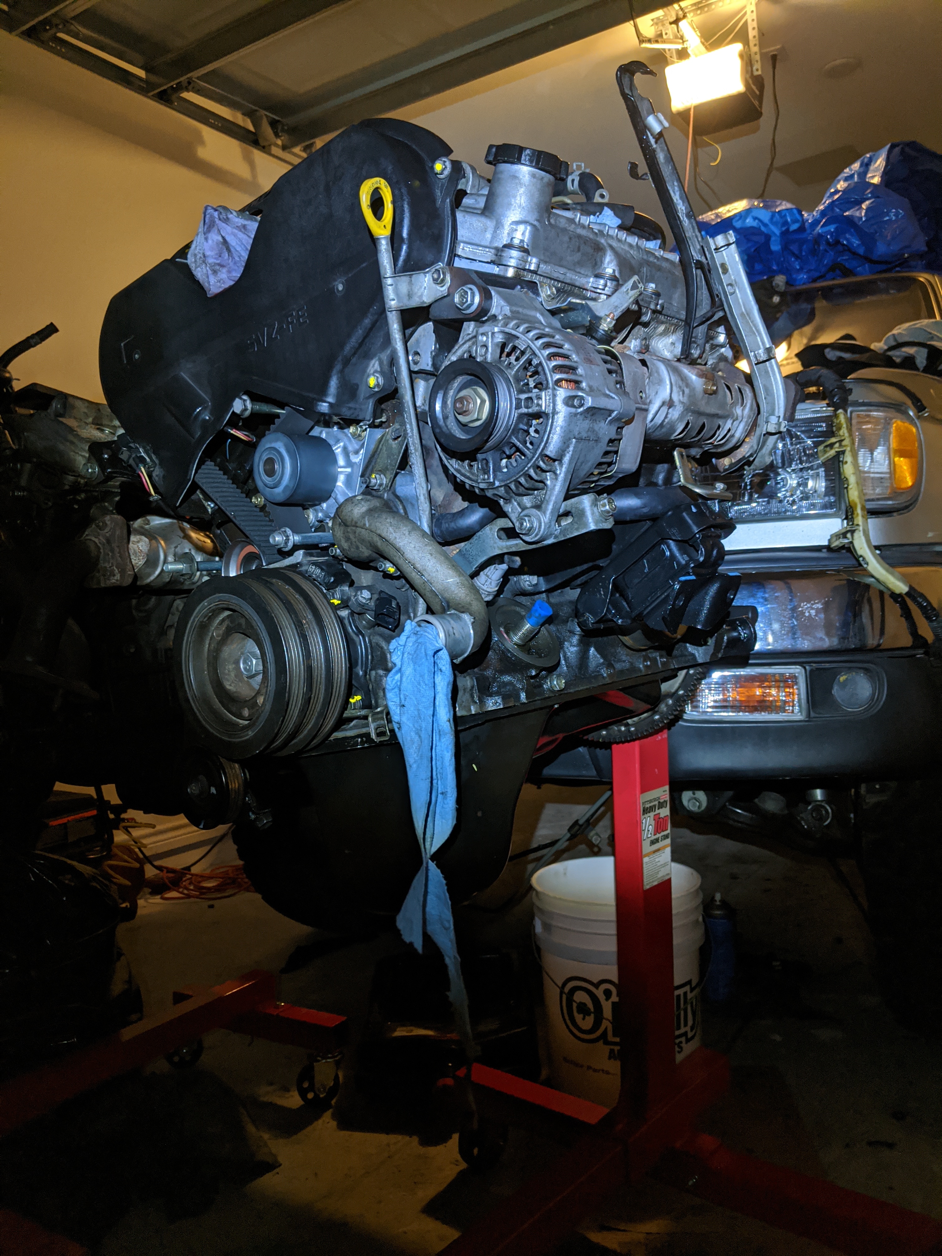

Engine Swap Update #6: She's ready [emoji16]
Oil pan has been sealed with fresh FPIG. I managed to use one tube of FPIG for two completely valve cover jobs and a oil pan lol
It was treat to flip the Engine over and do the oil pan this way.
Gunnna miss working on it outside the Engine.
But she is ready for her maiden voyage now. Got fresh denso plugs in her too for safe measure.
Will install engine Monday afternoon
Probably can fire it up Friday

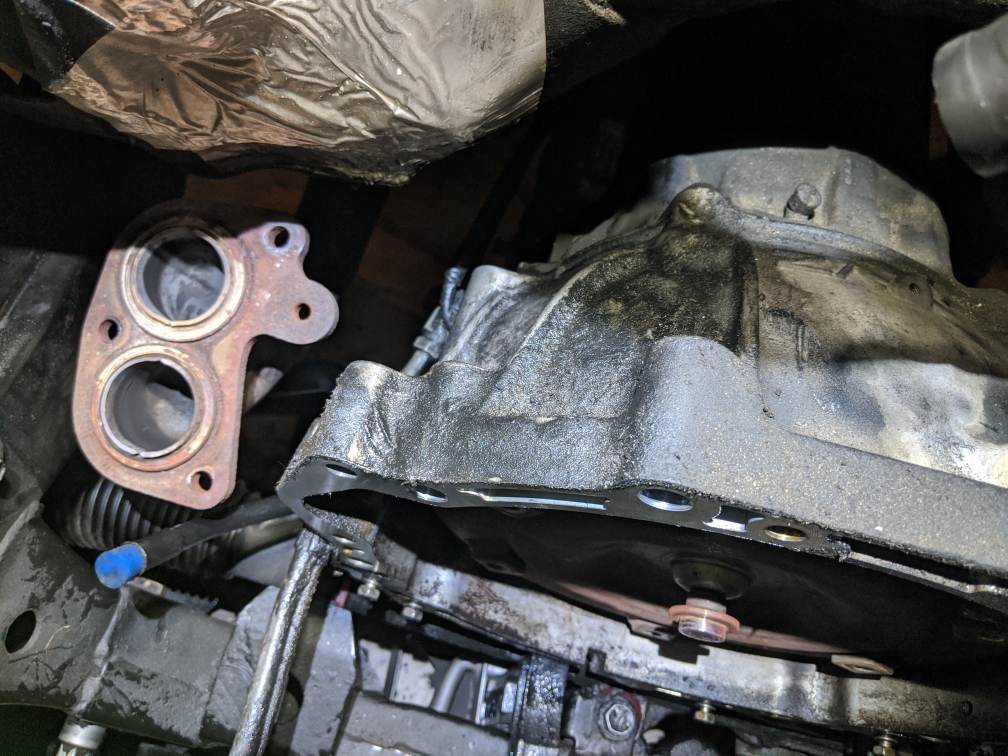

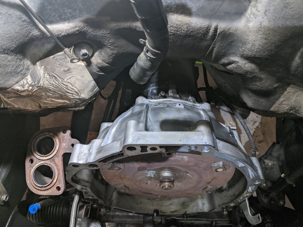

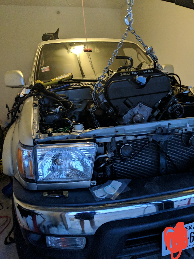

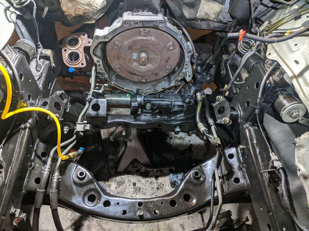

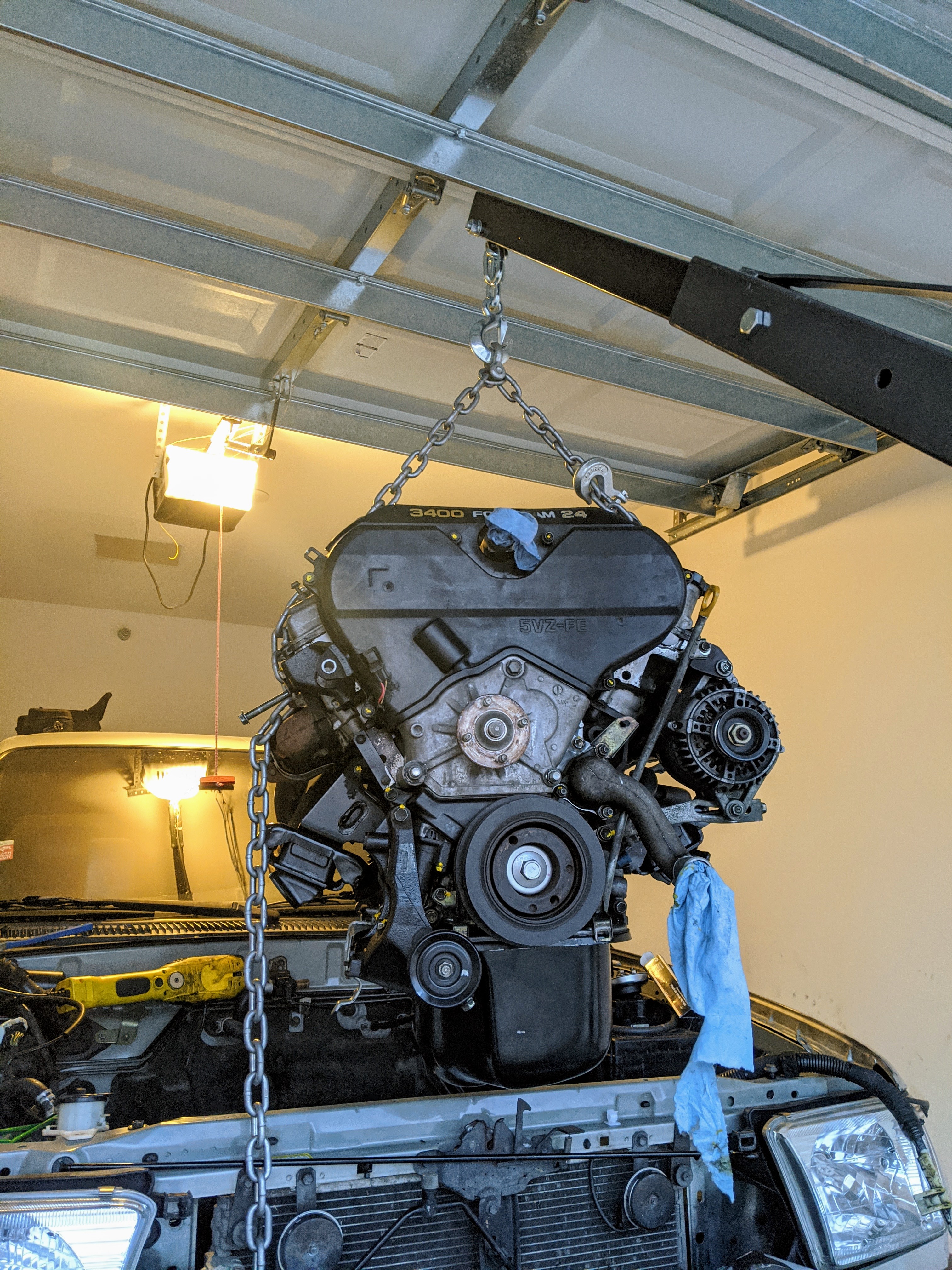

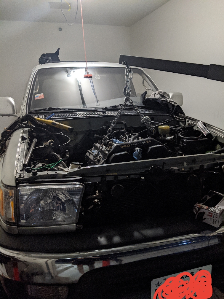

Engine Swap Update #7: Mounting Engine not so much
She is in the engine bay but not mounted! Lol I tired to put engine in on my own I was really close maybe a inch away but couldn't get the pins to align.
I played around with it for about an hour. You don't have any visual of the alignment pins so you really gotta go by feel and visualize it in your head
I said screw it and went to go buy a 800 lb HF transmission Jack.
So today I'm going to support transmission with jack then unbolt the cross member so I can get some wiggle room.
The transmission jack is Gunn's be super helpful because I can rotate and tilt the transmission with two knobs so in theory I should be able to get this done
It may be easier for me to pull the entire transmission back slightly then mount engine, then stab transmission back into engine after it's mounted.
Thoughts?

Can i support the transmission from the bottom of the pan? Or do i need to support it by the outter lip (like where the bolts through the pan)
A leveler on the engine is the 'normal' way to do it, along with a (regular) jack under the pan to adjust the height of the front of the trans. You don't want two 'loose' items in there while trying to get them to mate up. You want that rear trans mount keeping the transmission from sliding back under the truck.

I didn't have any luck with the load leveler.
I'm Gunna put the transmission jack under the transmission and tweak it the way I need to
You bring up a good point I shouldn't have both both unsecured.
But what I can do with the load leveler I can now do with the transmission jack if not more because I have three degrees of adjustment with the transmission where as the level only had 1
Sent from my Pixel 3 XL using Tapatalk
Charlie is correct. I dont have 2 moving things at once. I mostly have the transmissions on the floor out of the way when I pull engines. Then get that engine back in a secured before I put the transmission back on. Just easier for me to do myself.

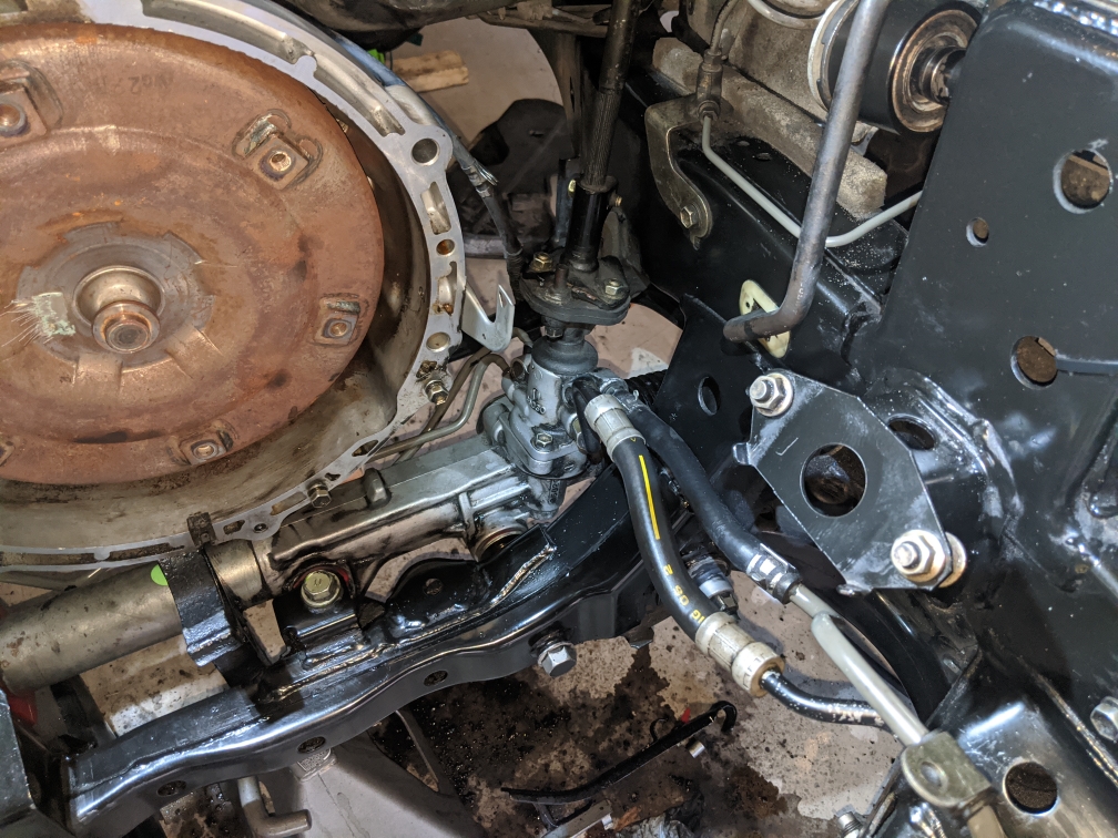

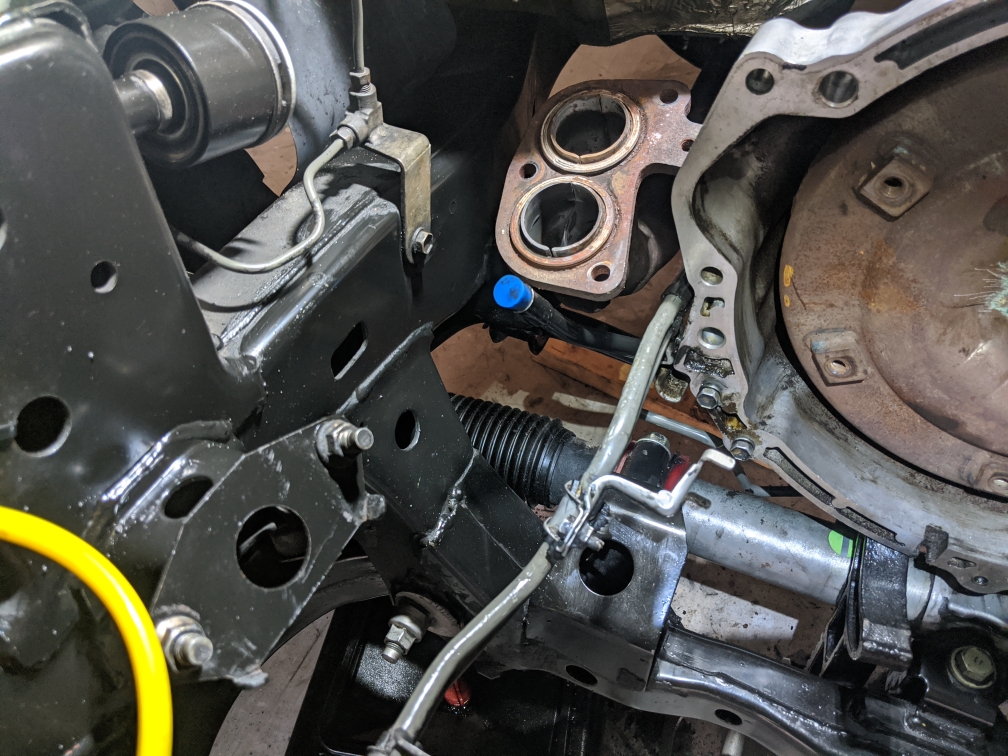

Got it :)
The transmission jack was where the magic happens. Once I got them relatively close, I rotated the transmission using the adjustment knobs.
Got underneath and bumped the engine by the engine mounts and just like that she was home.
I spent maybe 30 minutes getting the pins to align. Making small adjustments each time. Eventually I found if I belly surf on the driver Fender you can see 1 alignment pin, and feel around for the other.
You can't see or feel any of the pins from the passenger side.
All in two hours to get the bell housing bolts and TC torqued to spec.

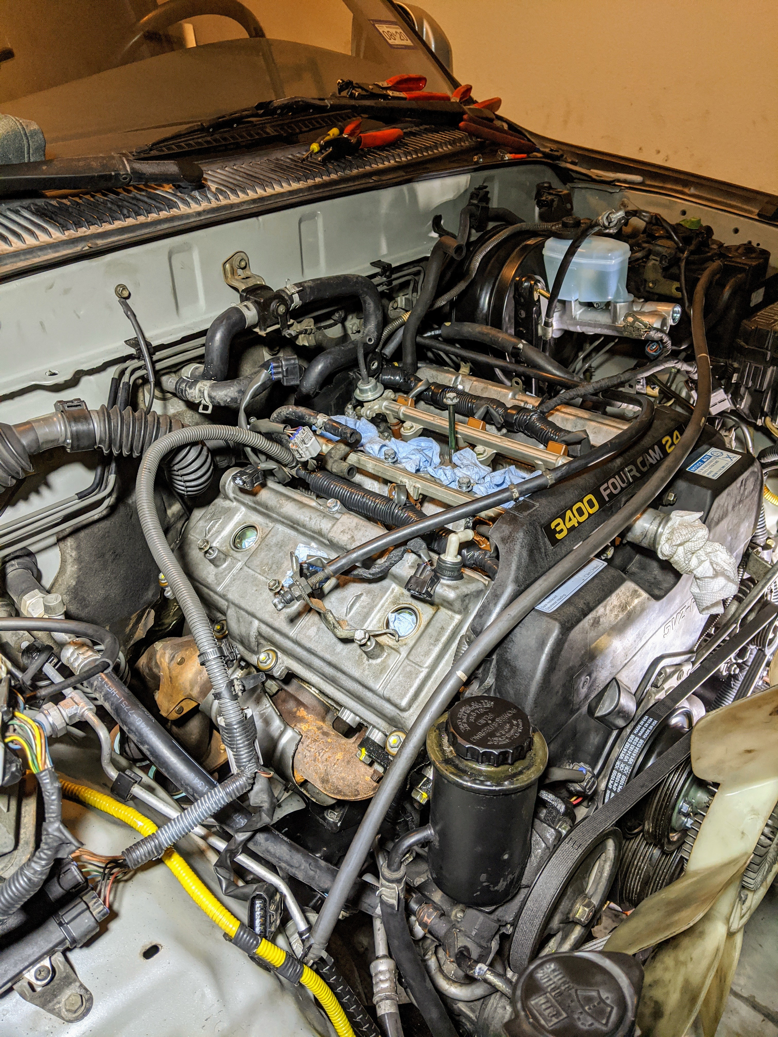

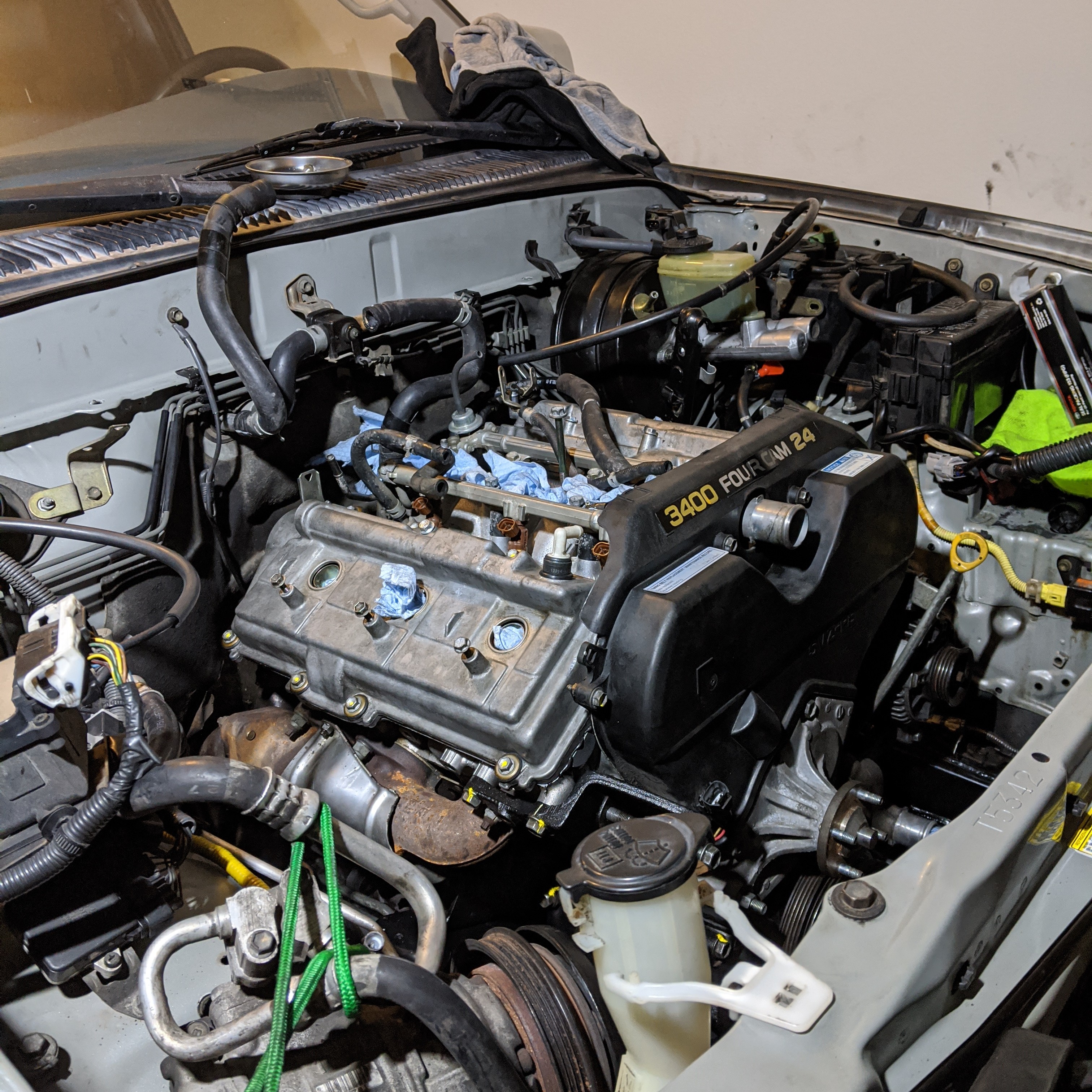

Almost there. Harness is back in I repaired a couple spots with some flame retarded corrugated wireloom. It's pretty cost effective. Cheaper than power braid and just as effective and gives a more OEM look.
So again, harness is in and plugged in, new master cylinder is in (sparkle sparkle), belt's are torqued down I got me a OTC belt tension device that makes it a breeze to set. Fuel lines and ground connected.
No AC :(
New radiator arrives Saturday still waiting on replacement starter. The first one was damaged in Transit
I actually put new denso spark plugs in as well.
This show is almost wrapped up boys!
I'm Gunna call this truck, "NoRunner" I think it's 100% on point and absolutely fitting.
