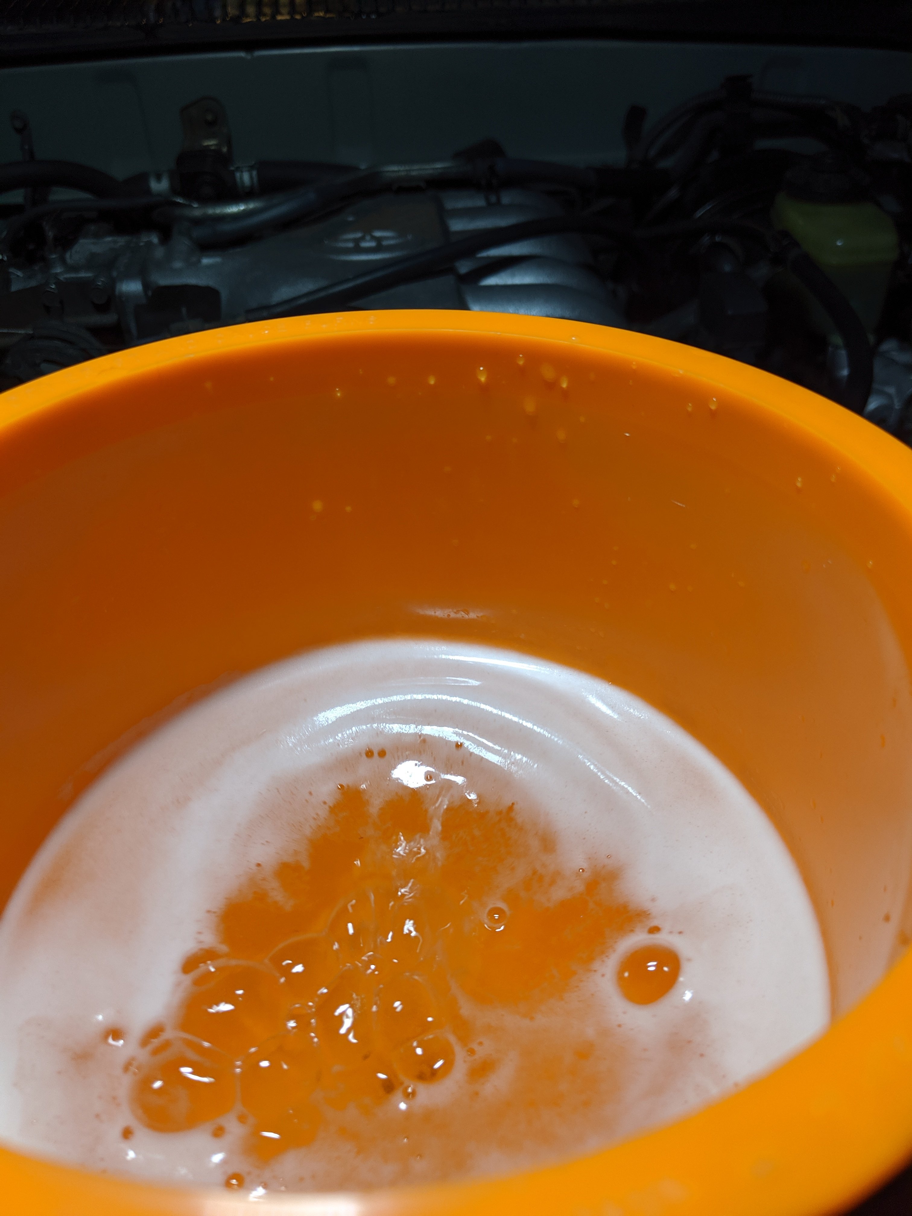

This picture here tells me there is something going on.
I got that sweet exhaust smell and white faint smoke. And that's with it warmed up
Those tiny air bubbles are a good sign of air pumping into a water jacket or air air leaking into the coolant somewhere.

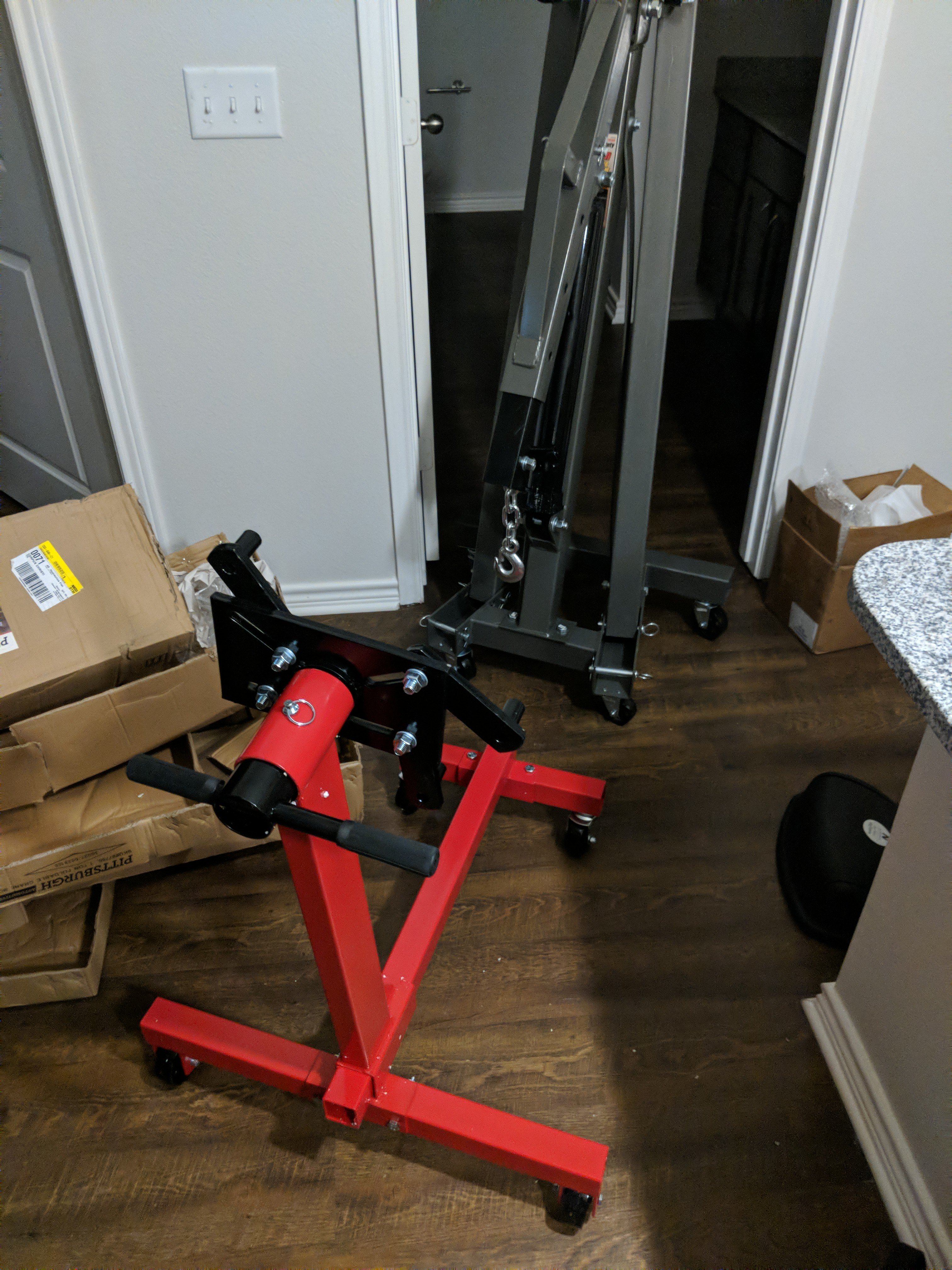

My weapons for battle have been assembled!
Hopefully will have it pulled by Tuesday. I imagine I will only have enough time today to get everything disconnected from the engine.
Monday I'll have the engine hooked up to the hoist and Tuesday the engine will be pulled
Never pulled an engine before. And I am doing it on my own in an apartment garage lol

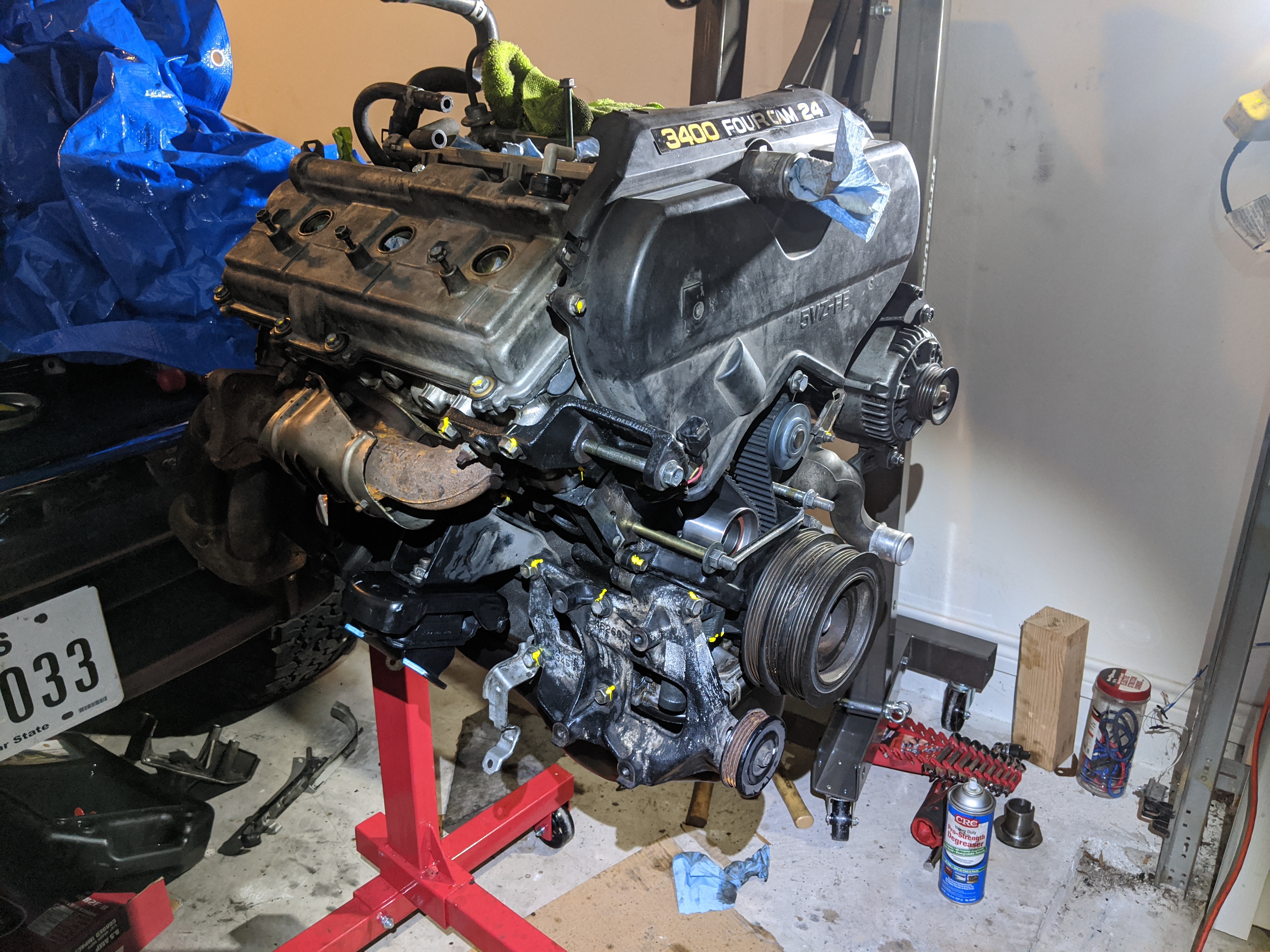

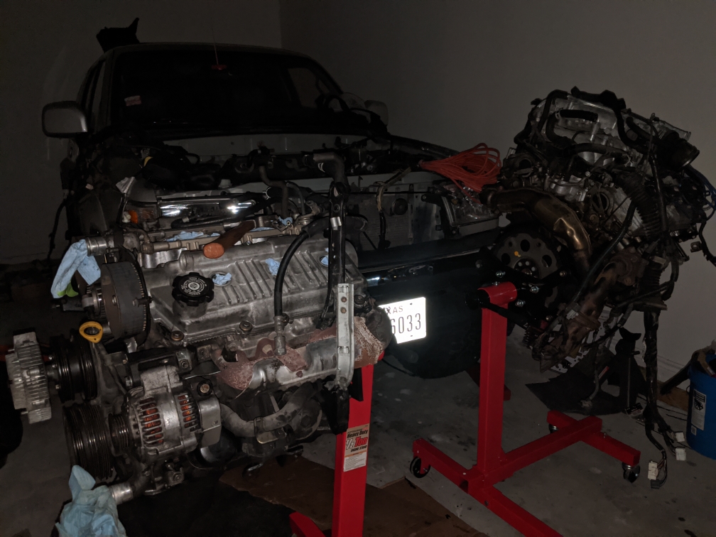

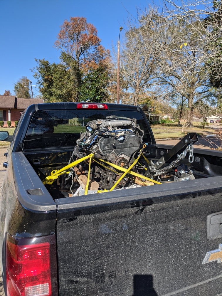

Well I decided to get a donor engine. Came out of a 1999 SR5. The seller wrecked it, had 144k miles on it and he gave me the service records for it too.
Prepping the new engine now. I have to swap power steering, and alternator brackets.
The alternator took a good hit. One of the bolts holding the alternator bracket to the engine sheared off in the head. It broke clean with the boss. So I'm gunna have to dive into my bag of tricks to get it out.

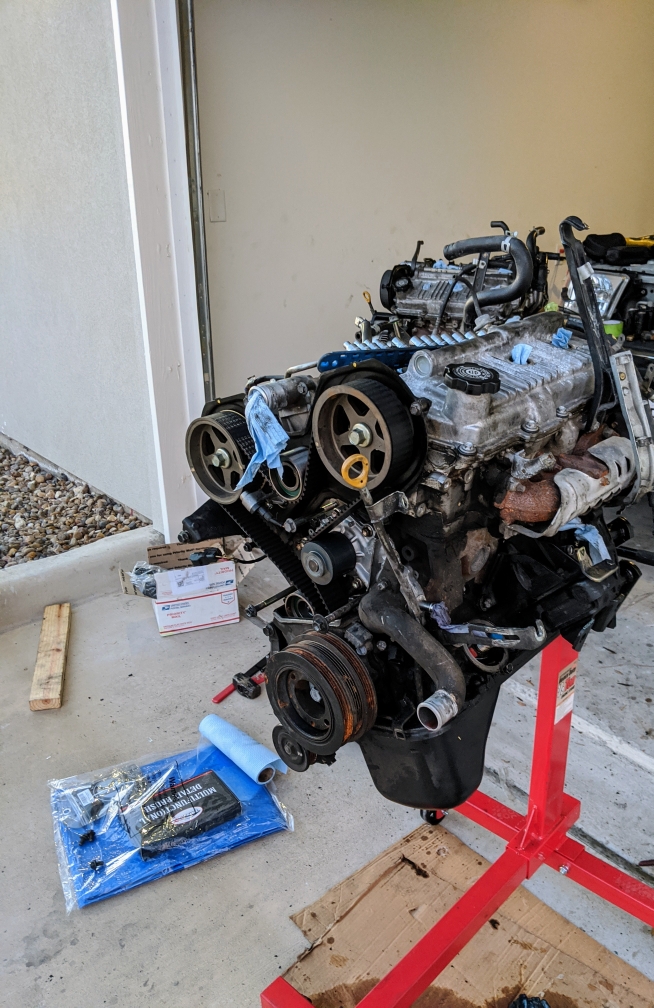

Engine Swap Update #2: Valve coverz 4 dayz, and timing woes
Did my valve covers, swapped everything over the only thing I reused was the rubber gasket and the half moons, I opted for new grommets.
This was the second time I did this in a month other than cleaning the half moons the second part was torquing the sixteen bolts on the valve covers lol steeping them up in torque sequence from 45-50-55. It takes time.
________________________________________________________________________________________________________________
First time doing a timing belt job on this Engine and I'm glad it was done outside the Engine bay.
I'm not sure how anyone can follow it per the manual because it just didn't work for me. I lined the cams up with their marks and crankshaft was set on Cylinder 1 TDC.
Everytime I would try and get the belt on there enough tension to turn both cams. And then I had to reset. Eventually I got it and there was slack between the water pump and the crankshaft gear.
So I would put the tensioner in and sure as shit the tensioner would then take the slack out of the belt and spin the cam gears but the crankshaft stayed put.
And after all that crap I still went ahead and tried to see where my timing was and every time it would end up being 1 mark behind where it should be.
I legit did the same process about ten times thinking I was crazy. There was no way I could change the outcome of this if I do the same thing over and over again.I eventually I said screw this crap I advanced the timing on the cam gears by the amount it was retarding it self.
it kept on retarding itself by 1 tooth on each cam.
So I advanced the timing by 1 tooth before I sent the tension on the belt and sure as shit it worked like a champ.
And I will say when ever I advanced it 1 tooth before putting in the hydraulic tensioner, the belt was sllack between the crankshaft gear and the passenger cam gear
Whenever I was doing it per the FSM it was the opposite way around, the belt was slack between the driver side cam and the crankshaft gear. And that crank shaft dot was one tooth BEHIND where it was marked on the COG
So because I advanced the timing by 1 tooth on each gear i was able to get the belt to slip over on the dot of the crankshaft gear, and the slack was taken up by the tensioner properly, but it did still turn the cams by 1 one tooth! But that's exactly what I wanted.
So by the time the tensioner was torqued ( I still haven't pulled the pin at this point) the cams retarded themselves by 1 tooth and after that my timing was dead set on.
I turned the crank 6 times for a total of 3 cam revolutions, and my timing was dead nutz. Pulled the pin and that is all she wrote.
It was pain in the ass to get that point. A couple of hours at least but i know 110% my timing is dead on.

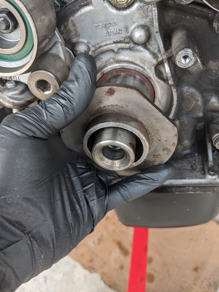

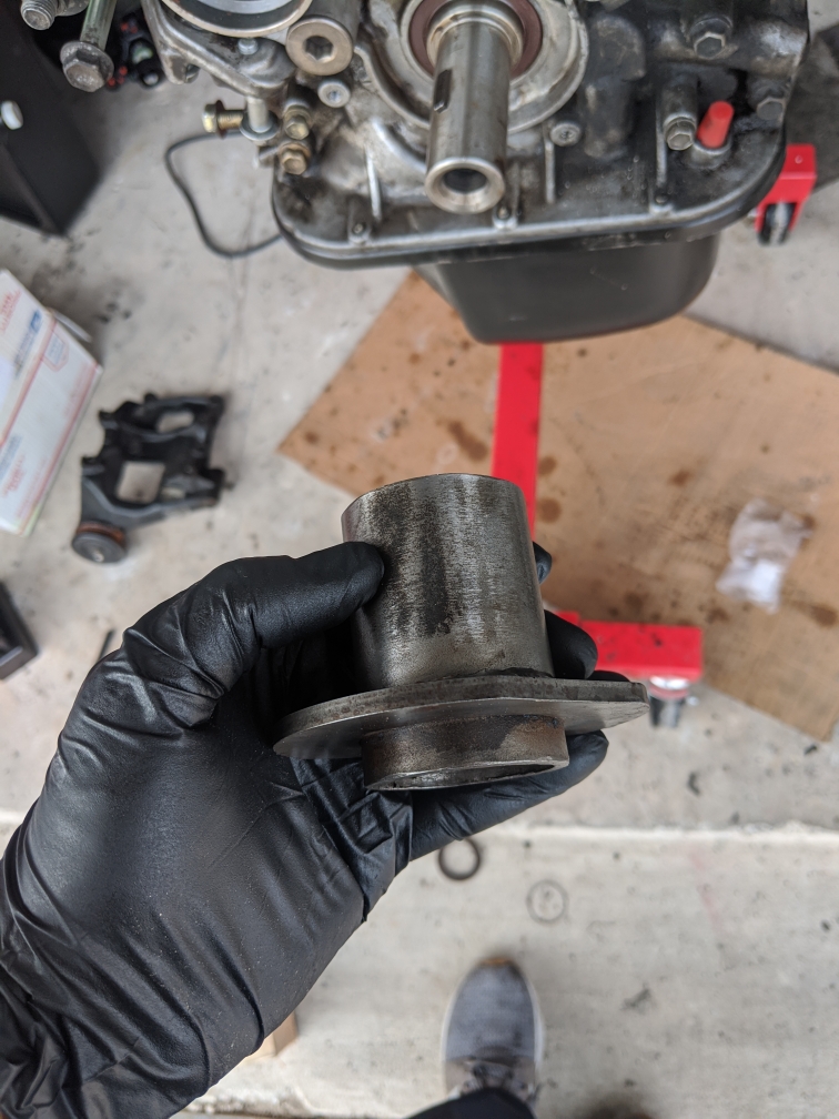

Oh and another thing, for installing the crankshaft front seal, if you have the rear axle bearing puller tool this little piece works as a great deal driver with a nice lip to tap in.

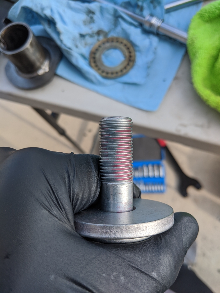

Also notice the new crank bolt has some thread locker on it maybe? Interesting to say the least

I'd be tempted to say you might as well back hydrualic tensioner all the off until it is not pressing against No. 1 pulley at all
I tell you what if I did this in the engine I would remove the AC compressor and bungie cord it and then remove the compressor bracket to get full view of that tensioner.
I think making sure the tensioner is all the way out is 100% needed. You might be able finagle it on but yeah I had mine off completely. Put the belt on, then tightened the bolts snug not to spec made sure the cams were in the right spot,
Then I torqued it spec and that's when it walked back right to where the timing marks were.
Thanks for taking on to my comments though! Here's to helping the lost soul that stumbled on this thread for timing belt stuff after they rifled through everything else! Lol
