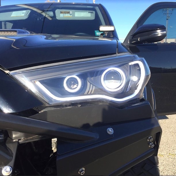

i got mines at www.hidretrofitkit.com for my 2015 4runner with led halos and strips. Here is a picture of the ones i got.
