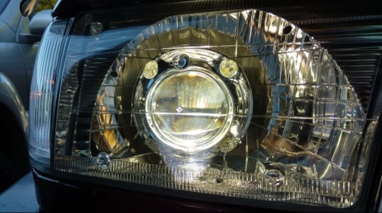

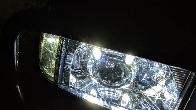

Here are some output shots of them from customers
BX Built Bi-LEDs by Andrew Abalos, on Flickr
Very good work brotha! The Tundra/Sequoia def work with standard h4 harnesses. However we have yet to find an affordable/generic (not that the motocontrol is expensive per say) and reliable harness that works with 3rd gen 4runners thats plug and play. And also reliable. Years ago when we began to offer our services we started with affordable/generic parts to get prices low. As we had issue after issue to deal with I made the choice to only use the most reliable stuff. Saved us thousands a year in warranty work, return shipping etc. Sure we dont sell $300.00 retrofits, but we are more than likely the most fairly priced company using higher end components.
Also we plan to be helping out other builders as soon as the world allows us by providing our own line of projectors and complete build kits. We spent a ton of money having our own Bi-LED projector setup designed after years of installing morimoto, nhk etc. Just really sucked that Corona Virus has put everything to a halt. We used a "Neutral White" LED system vs a "Cool white" thats used by everyone else which we felt was too blue for bad weather conditions. We also retained use of a much smaller and removable install stem for the beginner retrofitters, vs the massive D2s tube size of the Morimoto Bi-LED v2.0. And then we had that install stem cantered upwards to allow 3rd gen 4runners and many other reflector bowl platforms to not need as much vertical adjustment and shroud trimmer.
Looks good brother, I'll hit you up via PM once I'm ready to order.
I'm glad you guys have a complete ready to install kit not a DIY ones.
Are those pics on low beam btw?

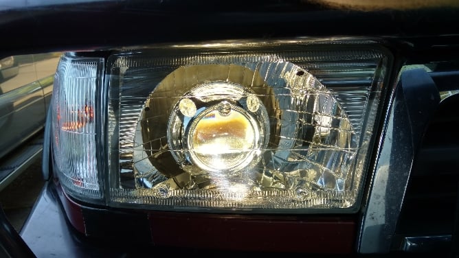

Here are my Panamara projectors
