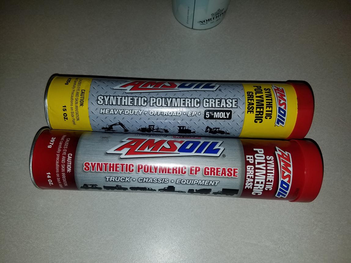

First time greasing the 4-runner at 10k miles. I just got done doing the U-Joints with this:
I had the tube laying around. It doesn't appear to be a "lithium based" NLGI2 grease, however it is NLGI2 rated and synthetic so I'm not too worried about it.
and I bought a separate grease gun and used this for the 2 slip yoke fittings:
I only put a few pumps in the slip yoke fittings and they did not move.
