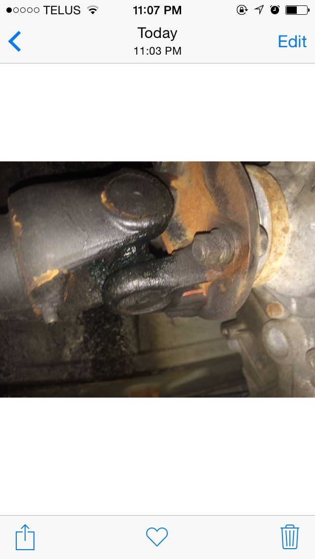

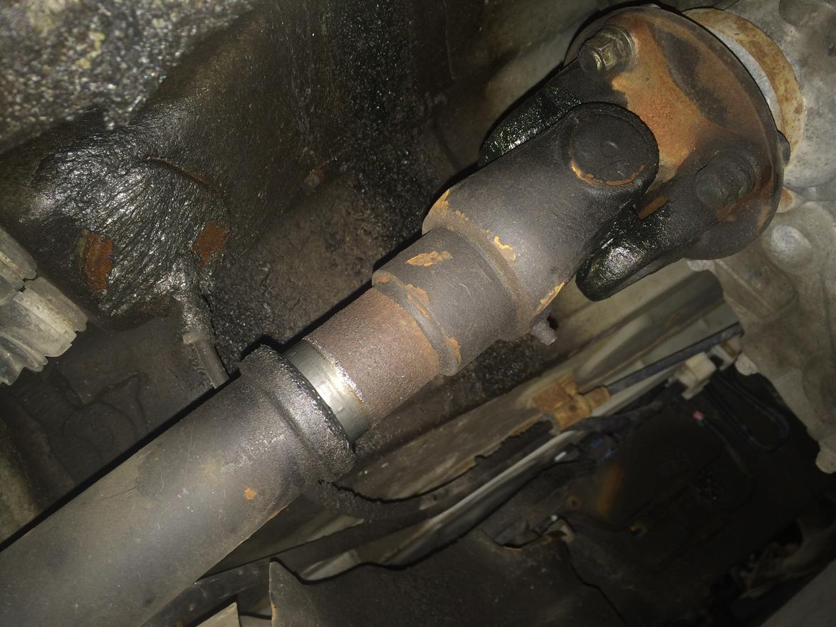

heres some pics of mine

Not Complicated but too much grease can and will push dust capout on the other end of that yoke. Some one has good picture here of that actually happening. Not the end of the world but why overdo it just to have to fix things.
Slider should not have that much grease slinging around. You are over greasing it.
you must remember that is 8 years worth of grease stuck there , greased every 5k Km , it didnt sling that all at once lol
