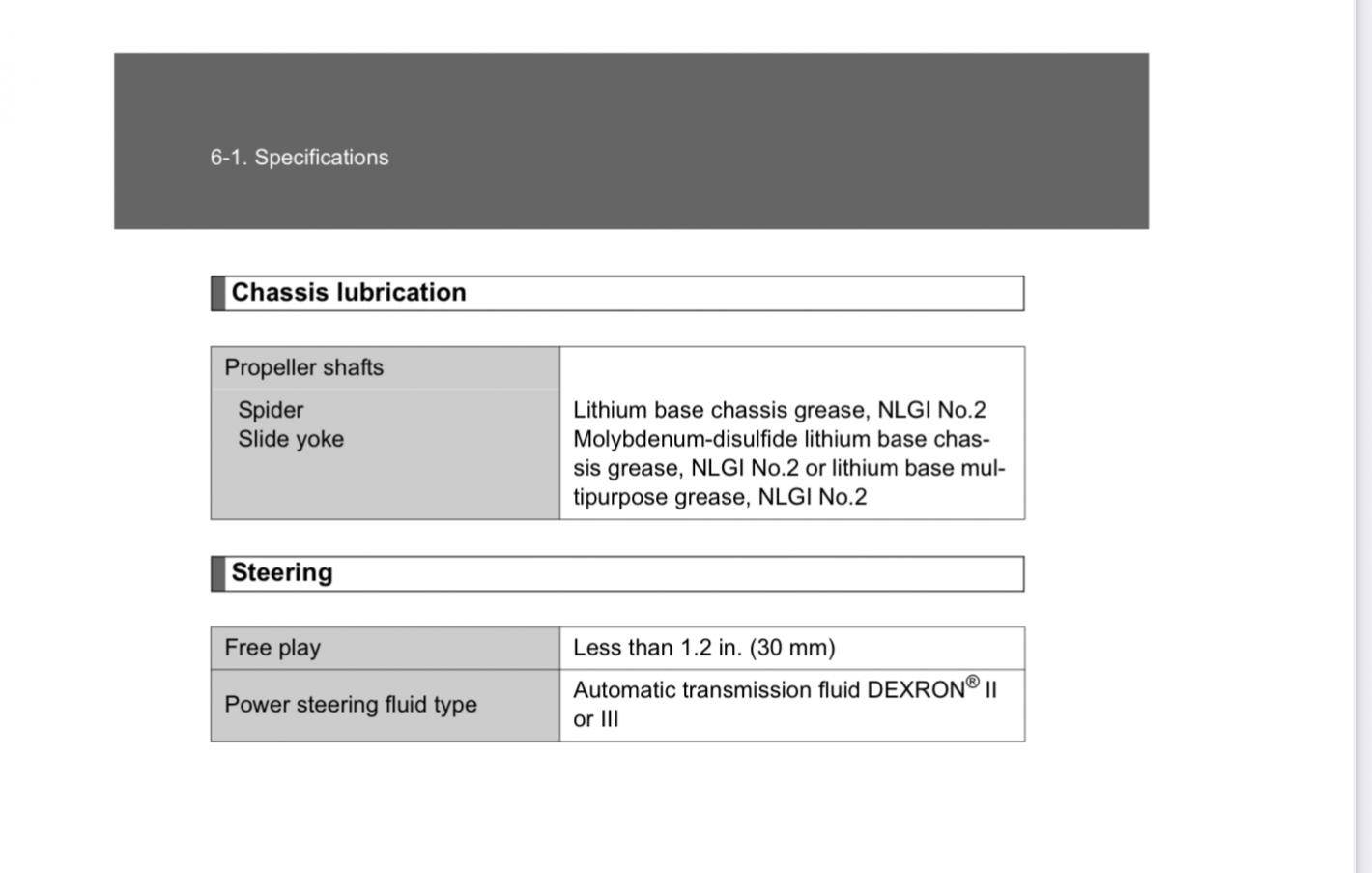

BTW, it’s clearly stated in your user manual. Here’s what mine says, lithium base chassis grease NLGI No. 2.

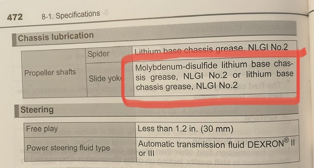

Is that a newer owner’s manual? Mine is slightly different.
“...or multipurpose grease.”
Your 2010 mentions lithium/moly, lithium chassis, lithium multipurpose. Some confusion since MP is usually used to grease the chassis. An interchangeable term.
Mine is a 2018 model. Maybe they made an attempt to clarify the wording.
Here’s how I understand it. Multipurpose grease is generally a calcium sulfonate base, used to grease chassis components. Some MP grease is a lithium base instead, which Toyota wants you to use. The moly additive is generally recommended for sliding surface applications, like the slide yoke. Apparently it’s not really that critical, since Toyota adds that you can instead use lithium base MP (chassis) grease.
