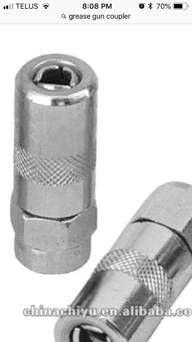

you shouldn't have to yank on it , your coupler on the end is not adjusted correctly , a slight tilt and it should almost fall off
Thanks for the tip on tilting the fitting to disconnect from the zerk! I was tugging pretty hard to get mine off , now I know the trick. I would hate to break off one of those little buggers.
I didn't know the coupler on the end could be adjusted. I tried tilting it, wiggling it, frying it, barbecuing it, baking it, sauteing it. I had to yank it to get it to disconnect.
LOL, how bout whacking it with a sledge hammer? just joking , do not do it !!
as in pic ya can see the line where the adjustment is , sometimes when they are new ya have to put them in a vice and use channel locks to get it to twist due to being too tight from factory , once moving find the happy spot once it is found ya rarely have to turn it again ever an adjustable coupler and pistol style gun with flex line the only way to go . ya need that one hand free to hold coupler especially in tight spaces

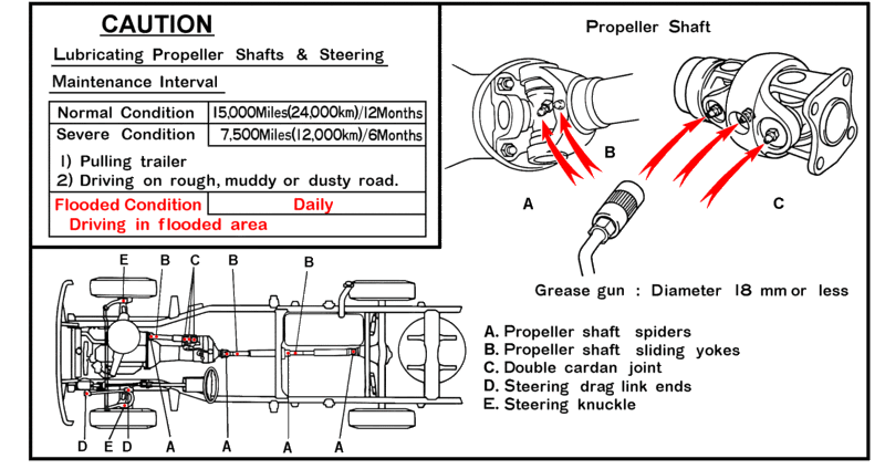

Does anybody has pictures that show where to grease these fittings, Do I still worry about greasing the propeller shaft even I have a 2WD 4Runner

It's on the first page of this thread, scroll down you'll see all of the pics.

Guys....on my '87 there used to be a card in the visor that showed the lube points along the drive line. I used to pull this card and give it to the shop to use as reference. I remember telling them to put it in neutral and roll it until the zerks were visible to lube. Good stuff. The thread shows.....maybe old school's not so bad!
