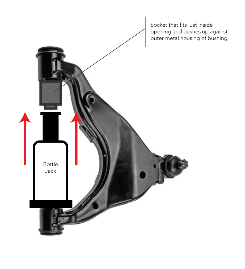

I have no doubt you are correct in your advice. I have a hard pull left when braking and I have always suspected the LCA bushings. I just wonder if this is a job I want to tackle myself, without access to special tools/press/welder/etc. I do have little propane torches for pipe soldering.
You dont need to torch them out, this works pretty well. I have used this method on other cars. Stole this cool picture from another member that posted the other day.
