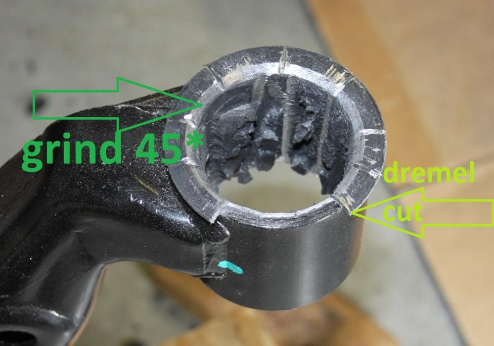

Another way to skin a cat.
Drill out the rubber, press out the inner.
45* grind and pie cut with dremel.

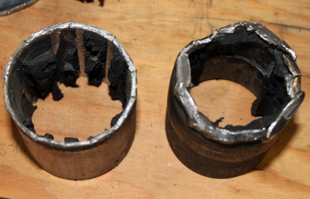

Last pic, right side is the grind 45* pie cut and fold.
Right side is just pie cut and fold.

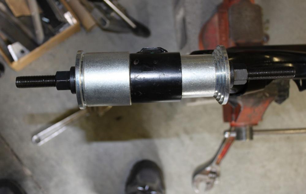

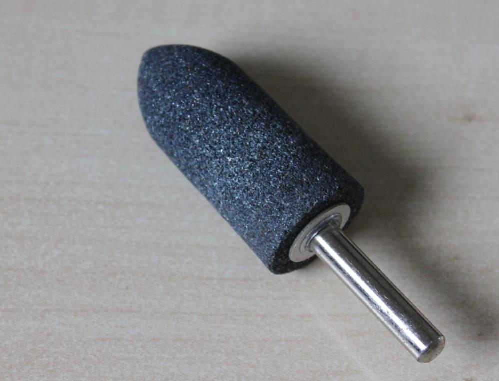

I cover the same thing in the Part 2 video I linked above. I used Diablo Demon Carbide tipped blades. I also agree that Energy Suspension bushings are a very bad choice for this job. I've installed both Whiteline and OEM bushings when doing this job. Some people have managed to destroy their LCAs by using too much force when using a bottle jack to remove the original bushings so we decided to give people an option of using a bearing splitter and hydraulic press to get the bushings out.
