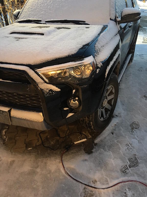

+1 for the factory block heater, we're in the -25 range at night in the Toronto area and it does the trick, the melting snow on the hood in the pic is typically where I see it when plugged in from residual heat loss, so I know it's doing something and certainly helps on the cold crank. I'll have to pay more attention to the air temp coming out of the vents after it's running after a cold start at work... I've got a remote start installed (Viper) so typically there is some warmth coming out already by the time I get across my parking lot to it.

Question: With just the block heater running and WITHOUT remote starting, where does the needle point on your temp gauge when you fire up the car?

Christmas was great up here, snow and the polar vortex set in,when plugged in the needle is still on cold when you start it up just moves up into the warm zone, faster than not plugged in. Checked out that to see if that electric heater gizmo worked, and yup, definitely warmer air than the -40 degrees celsius with everything on max and that was just driving to the end of the street. Now time to go ice fishing!

As low as the needle goes below C for me. I plug it in when its colder than -10 c or 14 f.

I've tried that just to see if it comes up a tad immediately but no - the needle doesn't move but it comes up faster for sure (within a couple mins) when plugged in than not. I don't typically idle for more than a few mins anyway - enough time to clear the windows of ice and snow before starting off in the morning. Certainly when leaving work and not plugged in type thing, I need a few kilometres before heat is cranking out and the needle is moving up.
One thing I noticed tonight for the first time actually is the idle speed change when I crank up my blower motor speed (not defrost mode). Tried it in gear and neutral and sure enough, when I have it set at max heat and crank up the blower motor speed - up goes the idle. Maybe a couple of hundred RPM but noticeable alright. I'm assuming thats due to ambient temp and sudden electrical draw I guess, cause when I turn it right off the idle speed backs down to 650 again or whatever it is in gear typically.
