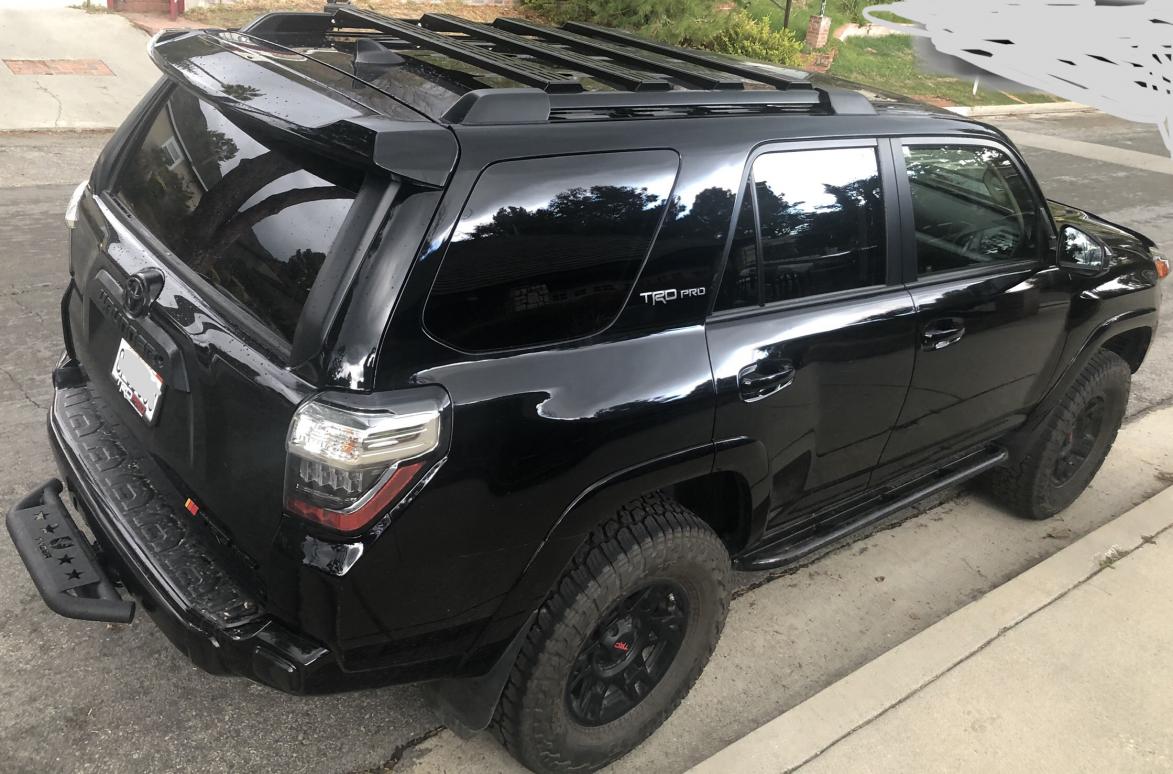

Here is a pic online for reference:
The guy in the referenced pic has the front of the box (the front being the right side of the picture) mounted just before the wind fairing, so there is space. I was the box would be better mounted more forward so that the box is just barely on top of the wind fairing (but it won't be forward it enough where I could bolt it on there. I think for sure the box should not pass over the fairing.
Thoughts?

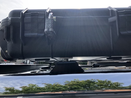

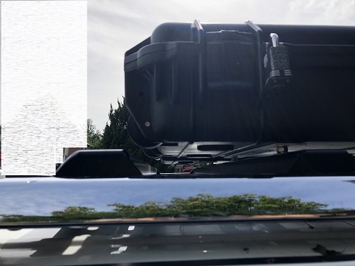

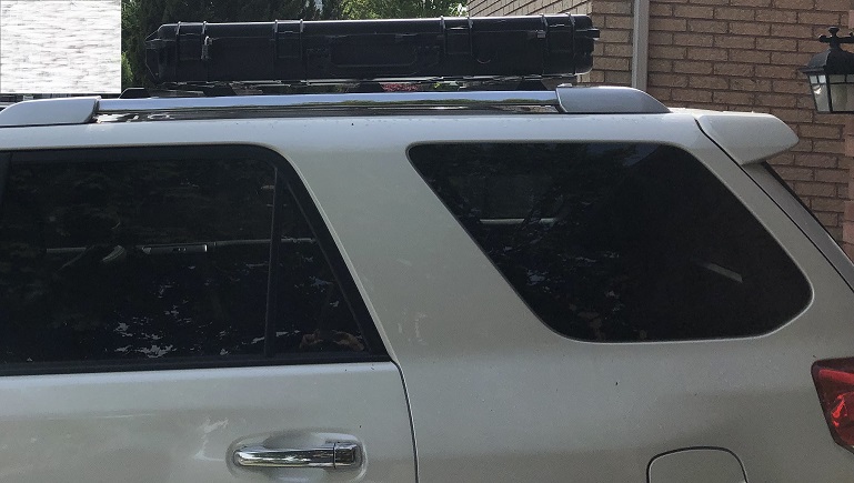

let me get some pics this afternoon. I'll get a couple pics from different angles and report back
her are some pics. from bottom to top this is how I secured:
m8 x 40mm bolt, m8 fender washer, crossbar, m8 fender washer, lock washer, nut, 1/8" aluminum flat attached to case, case plastic, EPDM washer, nut. when I remove the case I have the tops of the m8 bolts which I use those plastic screw covers to protect the threads
if the cases are perfectly centred the 1720s are about the exact length of the side rails. I had to slightly move to the rear so the front edge didn't pass over the back edge of the faring. this also doesn't cover the mounting slots in the faring in case I want to use them. if you get anything longer than the 1720 you will lose your slots in the front faring
