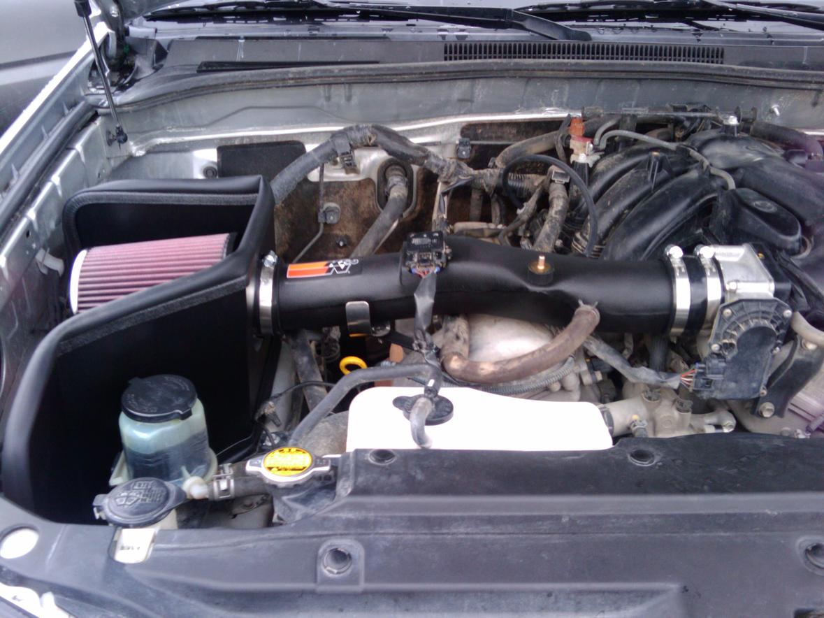

That eBay item is a travesty, I will take a picture of my K&N and post it up later today/tomorrow so you can see exactly what I mean.

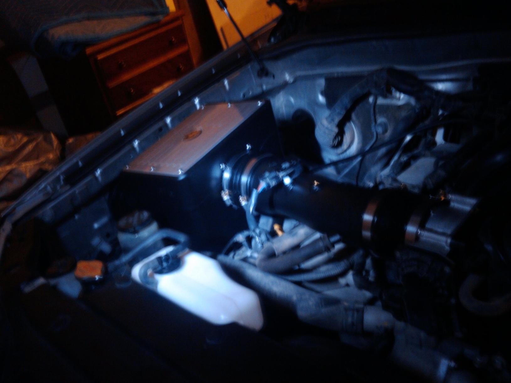

Having had both the AFE and K&N I have pics....:D

You are correct, mine is called the "air charger" and not a "Cold Air Intake" (again, just semantics, but apparently words have changed meaning, my fault) and yes it was expensive, but man was it worth it, I think it does an excellent job and I would buy it over any other if I had to, I am very impressed with it. Yes I also know about the drop in filters, I have one on one of my older cars. I do think the extra gain from the "air charger" is worth it for my 4runner.

The volant box looks great, has a smoother/straighter tube then oem but that hole in the front is a great place for hot air to be sucked in. It would be better if it were covered up. I wouldn't argue that this box doesn't flow better then the oem box. It most likely does. But to what degree and at what rpm range? I doubt that its more then 3-5 hp without head work or exhaust mods. Only before and after dyno runs would confirm the gains and put this debate to rest. I wouldn't spend that kind of money just to get a few more ponies at the 4-5k RPM range. But that's just me (my priorities are all out of whack).:D
IMG_0130.jpg~original
That K&N system has too many gaps to be considered a CAI system.
