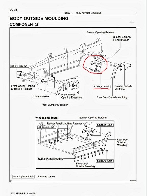

In your pic, is that the retainer for the fender flare & is it held on by 4 bolts on the rear door? I need to remove the fender flare on the rear door and making a list of clips/fasteners I should have on hand for re-installation in case I break some.
