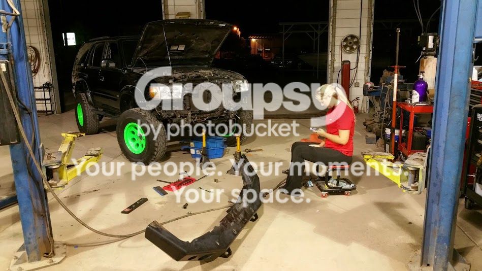

OK Everyone I have not posted In a really really long time because I have been working on opening my own auto shop/ car dealer and it is up and running and doing really well!
OK so now on to the 4runner stuff! my 3rd gen I bought 3 years ago and have not had to put a penny into fixing anything thing just upgrading it! Now at a 150k I finally have a few basic problems!

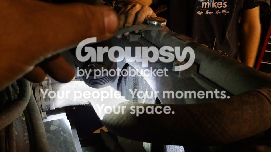

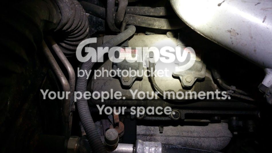

all I use only Toyota Brand parts and amsoil oil! I have been doing some powder coating and had it on a lift over night and noticed the leaking rad, leaking valve covers, and leaking a/c dryer. What I want to do is put an all aluminum rad in with the Taurus fan on it! I have not found any threads of any one doing this so Just looking for some input and some does and donts!
Here is a sneak peak of some of the powder coating
