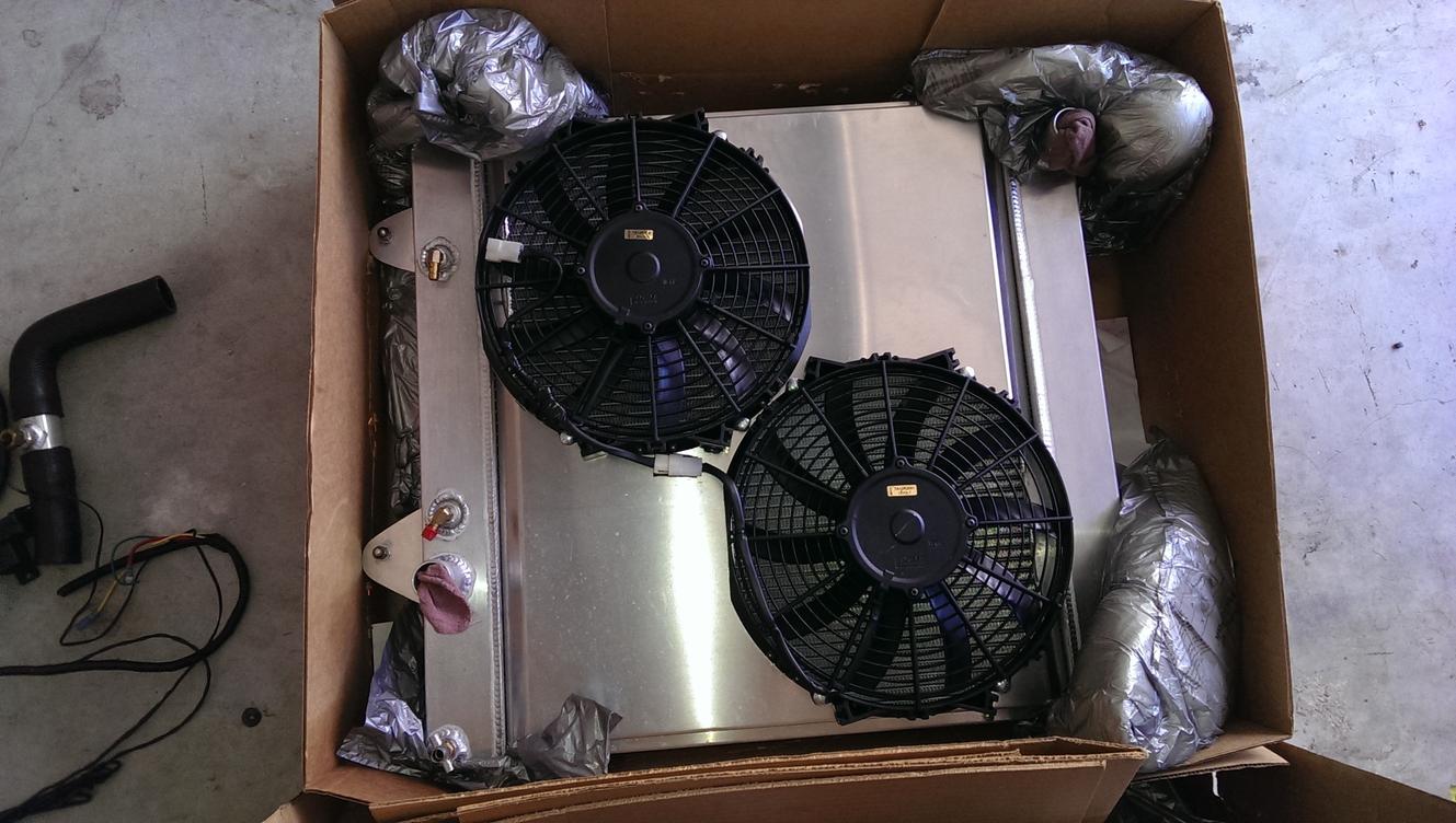

I'm getting ready to install an aluminum radiator and a set of electric fans. Ran across this used set up in the classifieds for a good price. I also was in need of swapping out my rad due to worry of the dreaded pink milkshake!! Anyway...I've never had any problems running electric fans on my other vehicles...so I figure I shouldn't have any on this one.
I'm not doing the install for extra hp...but I do know I have a S/C to install any week, which makes more horse power than Toyota designers anticipated...so it will help me out there. And I also know that with-in the next year or two...I'll end up putting a V-8 in my 4Runner, which will require me to go electric. Oh and one more reason...I think it looks cool...lol!!
Any chance you can provide the manufacturer and model of the pictured rad? I am going to do my timing belt, etc. and am running the original rad on my 97 4runner...
Anyone know the model/maker of the pictured rad?
[MENTION=115020]ThorInc[/MENTION]...hello Sir. I apologize it has taken me so long to get back to you. The radiator and fans were both built by AFCO. You can buy them from Jegs, Summit, Speedys, ect... The guy I bought this radiator from, dealt with the actual company. He called them up and told them what he wanted/needed. They in turn, custom built his radiator with the fans as a complete unit. I'll tell you this much...this set-up is very very high quality! I couldn't be happier with my purchase!!
