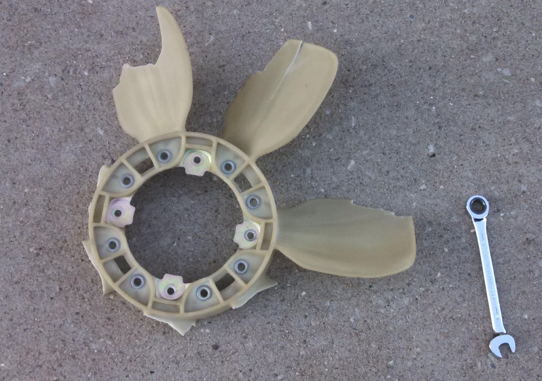

Shortly after I bought my 2000 4Runner, the radiator fan self-destructed, just spontaneously broke apart. I purchased an after-market (Dorman) fan from Advanced Auto. When I was removing the fan, one of the bolts broke off in the fan clutch, so I also replaced it with (an aftermarket) clutch.
The aftermarket clutch never did seem to work right, making the fan run more than it needed. I recently decided enough is enough and purchased an OEM fan clutch. This new fan clutch works much better, only running the fan when it should instead of most of the time.
Last week, while going up a hill with the pedal to the floor the fan (less than 2 years old) self-destructed, shedding all but two blades. It was yellowed with age, and I'm wondering:
-Is Dorman a descent brand?
-Is there something else causing my fan blades to self-destruct?
The dorman fan has a "limited life-time warranty" at advance, but I decided to go with a new OEM fan. I may take the old fan into Advance and insist that they give me a store credit to spend on something else.
Your opinions are appreciated! :-)

Thanks again guys, I'll post once I receive the new one and get it installed...looks like I may not get it until Monday. In the mean time, enjoy this pic of the old fan...
