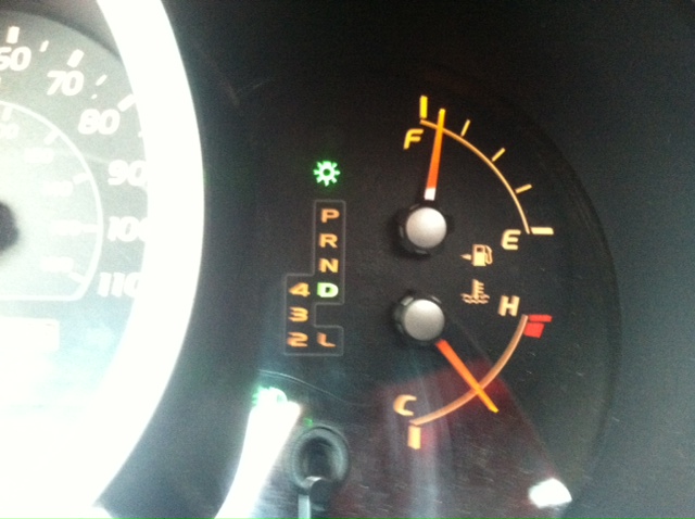

Random, and somewhat affiliated but does this look like normal operating temperature for your guys' 4runners?
