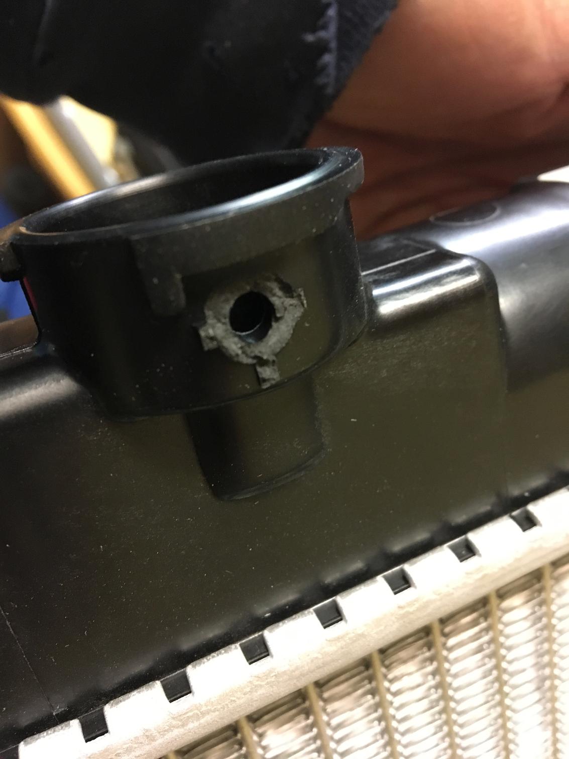

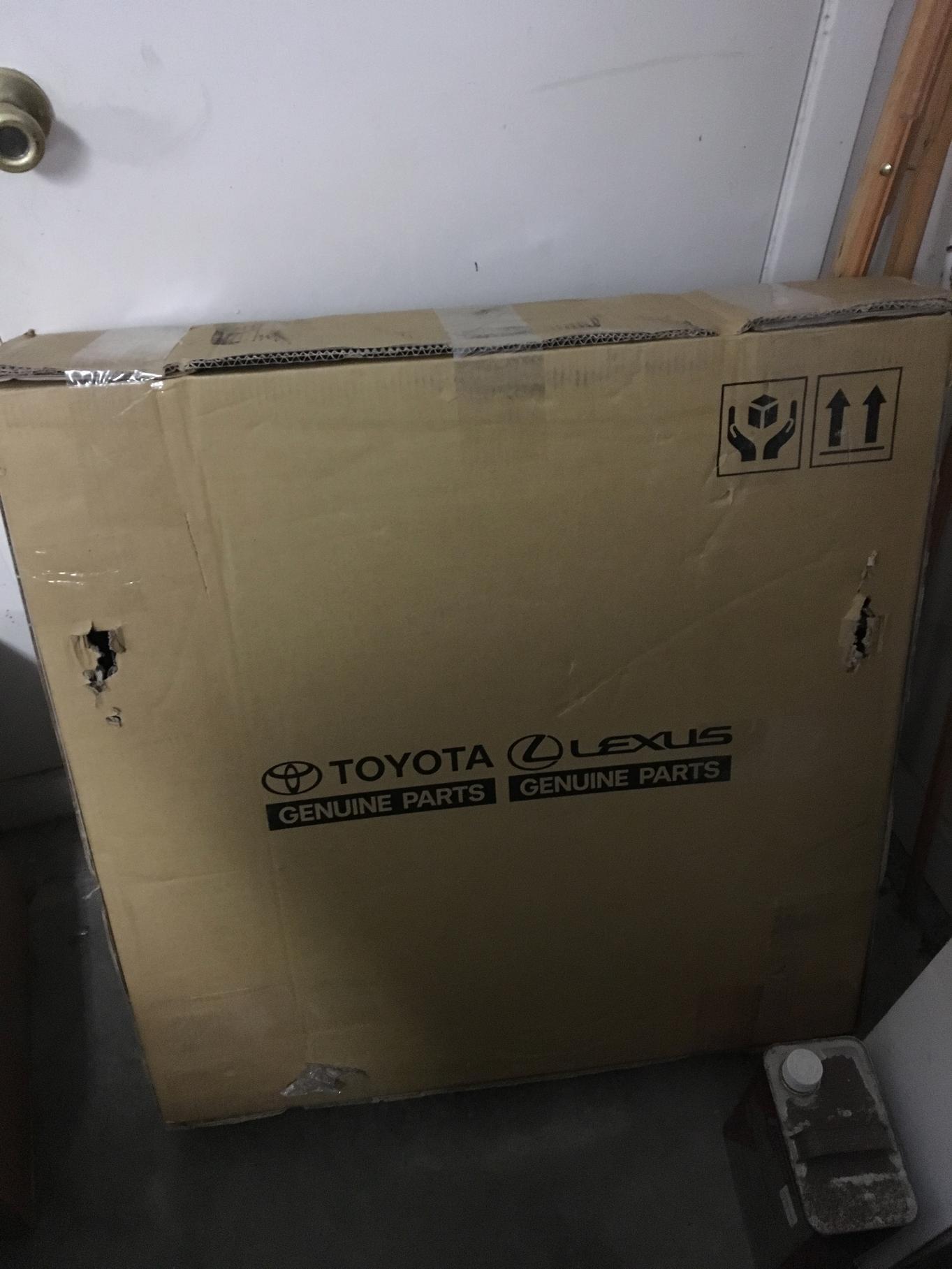

I bought the Toyota OEM Denso from Amazon for $146 or so. It looks legit- exactly like the one I took out with the exception of the nutserts instead of welded on nuts as was noted earlier in the thread. Would be very happy BUT it is broken. Making was an absolute joke. It pisses me off because I want to install it soon. Not sure if I should try them again or get something else.

Amazon is famous for bad packaging for shipping...and not just for auto parts. They shipped that radiator using an inner carton as a shipping box. The web dealer I got my OEM from put that inner carton into a real shipping box.

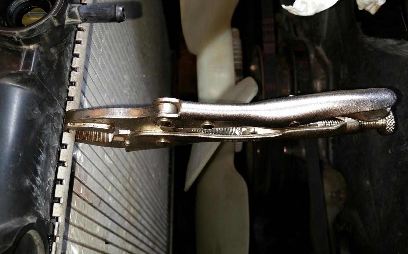

My Koyo just started leaking, or at least I just noticed that it is leaking. After checking my Amazon order history I realized I have had it for 4.5 years so not a horrible product but could be better. The leaks are at the junction of the aluminum core and the plastic tanks. It appears to be more towards the ends. I decided to try and tighten up the junction by carefully compressing every aluminium tab with a Vise-Grip, the whole time being careful that the adjuster on the Vise-Grip didn't move in order to maintain consistent compression.
So far I have drove the vehicle about 20-25 miles and the radiator is bone-dry on the exterior, (knock on wood) unlike yesterday's test I performed to determine the leak location. Yesterday I rinsed off the radiator with water before driving the same route as today and noticed coolant on the exterior after the same 20-25 mile route. If anyone else has issues with their replacement radiator leaking it might be worth it to try to compress all of the tabs before buying another replacement.

Cold weather can make these seams leak too.
My rad leaks not a drop 9 months of the year but on mornings when the weather gets down to below -25 it will leak a lot from this seam until the engine warms up. Now that it is up to -10 overnight the leak is gone.
