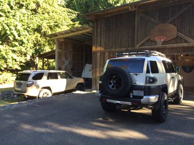

So I was in the garage working on the FJ and had some great jams going on the garage radio, a Canadian station 99.3 [emoji106] and noticed my phone was dying and my cord was in the 4R so I turned the key on and plugged my phone on. The radio kicked in and was on the same station so I left it going, surround sound [emoji7] Getting back to work I noticed they were not in sync. The 4R had a slight delay, sounded like shiat. WTF, I've had both going at other times with no issues, but it was the FJ. So I kicked on the Cruiser and it matched the radio. WTF right? Has any one else experienced this? Thinking maybe it is the Entune system causing the delay. Kind of interesting, kind of sucks, lol!
