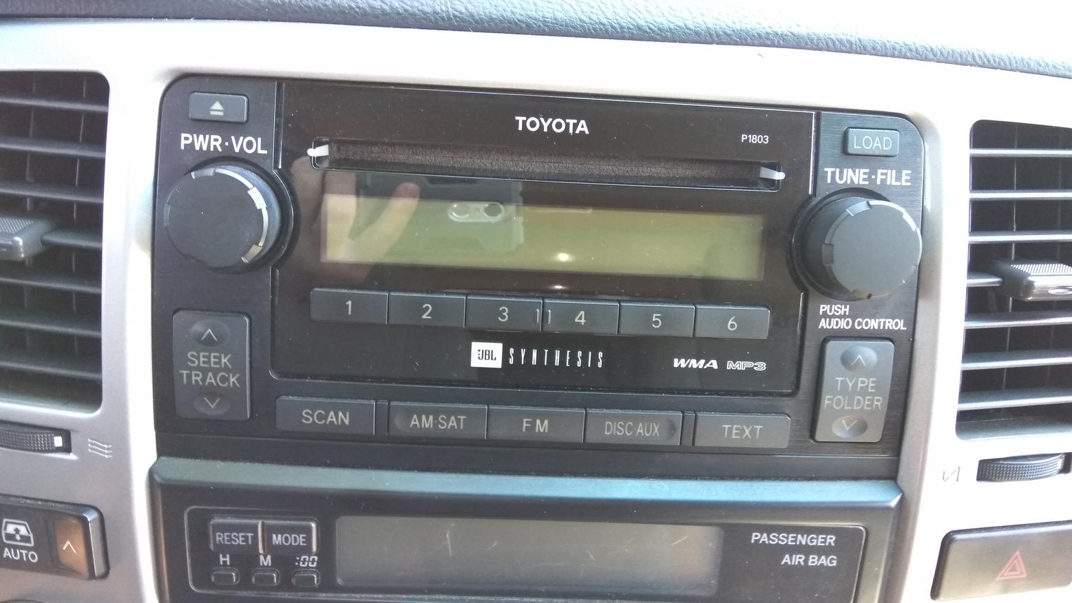

I've tried searching for the past month for the parts needed for installing a headunit in my 2007 limited 4runner replacing a JBL non-RDS headunit, and the answers are just not clear.
Could someone specify which parts I will need to retain the JBL System, besides the Steering wheel control?

You will need the
PAC-RP4-2-TY11-Wiring-Interface
Metra 95-8210 Dash Kit
like you listed above, as well as
Scosche Mda-B Micro/Delco Antenna Adapter Tip
and
Metra 40-UV43 Male to Female Motorola Antenna Cable
if you want a good radio signal.

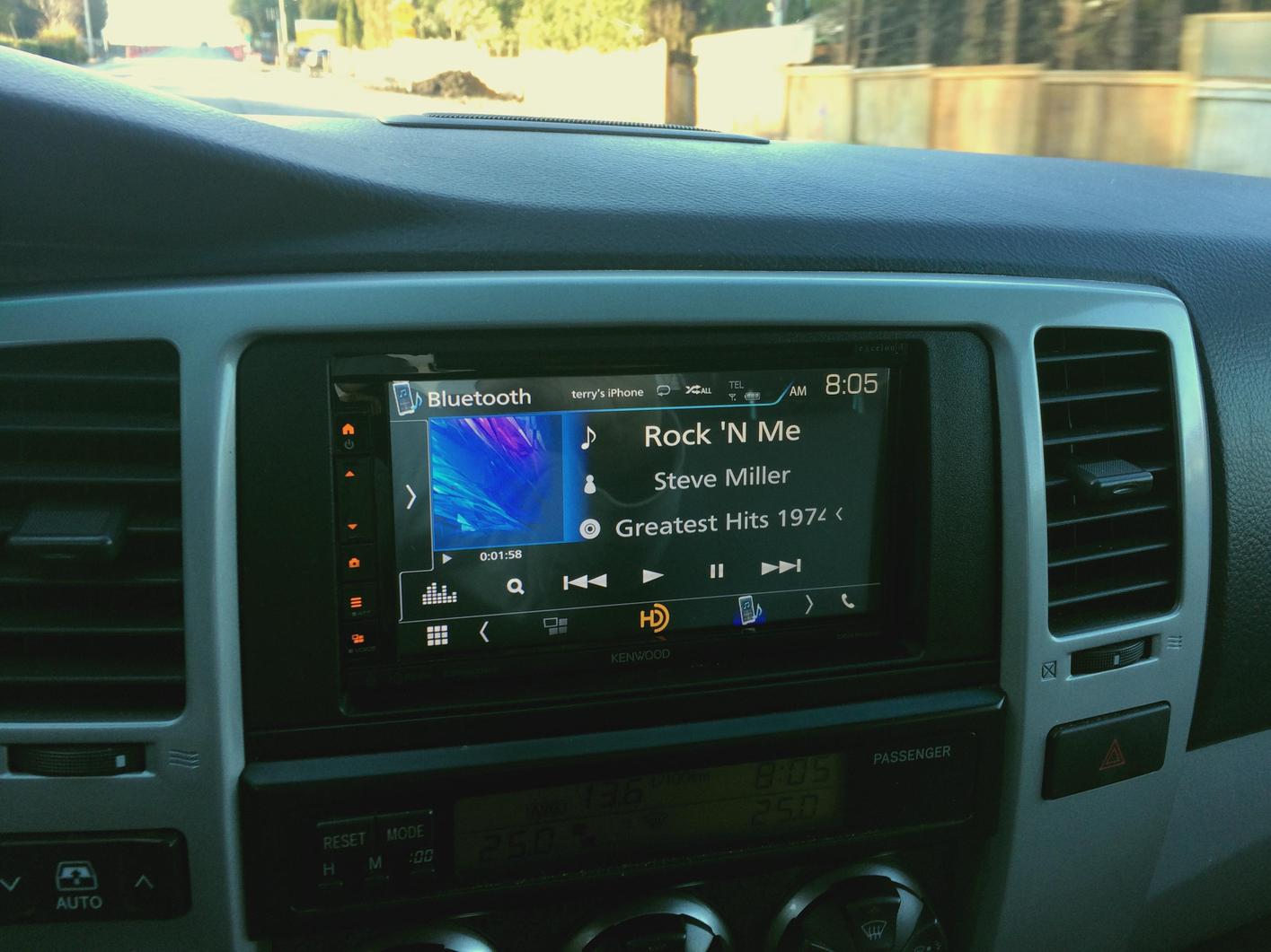

Had a Kenwood DDX6904S installed in my 2004 Limited. The screen is a bit small compared to others I've seen, but I like the way it fit in the factory space. I kept the JBL Synthesis system for now. I usually install this stuff myself, but after reading all the posts on here, I realized I really wanted my steering wheel controls and The JBL to merge for the time being and didn't want to mess with it. I figured I'd bite the bullet and let a pro deal with it all.Couldn't be happier with the work they did. Cost me about $1300 Can. to get it all installed. works flawlessly with my phone, the JBL and the steering wheel controls. The buttons are a bit small and tucked against the edge of the housing so the steering wheel controls are something I wouldn't want to be with out.
