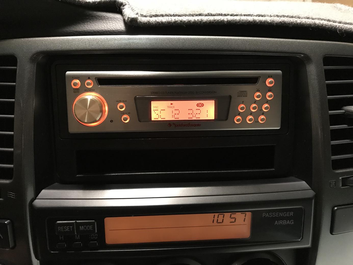

Hi, I love my Denford with Pioneer stage 4 amps, component speakers and a Morel Ultimo sub!!!:rockon:

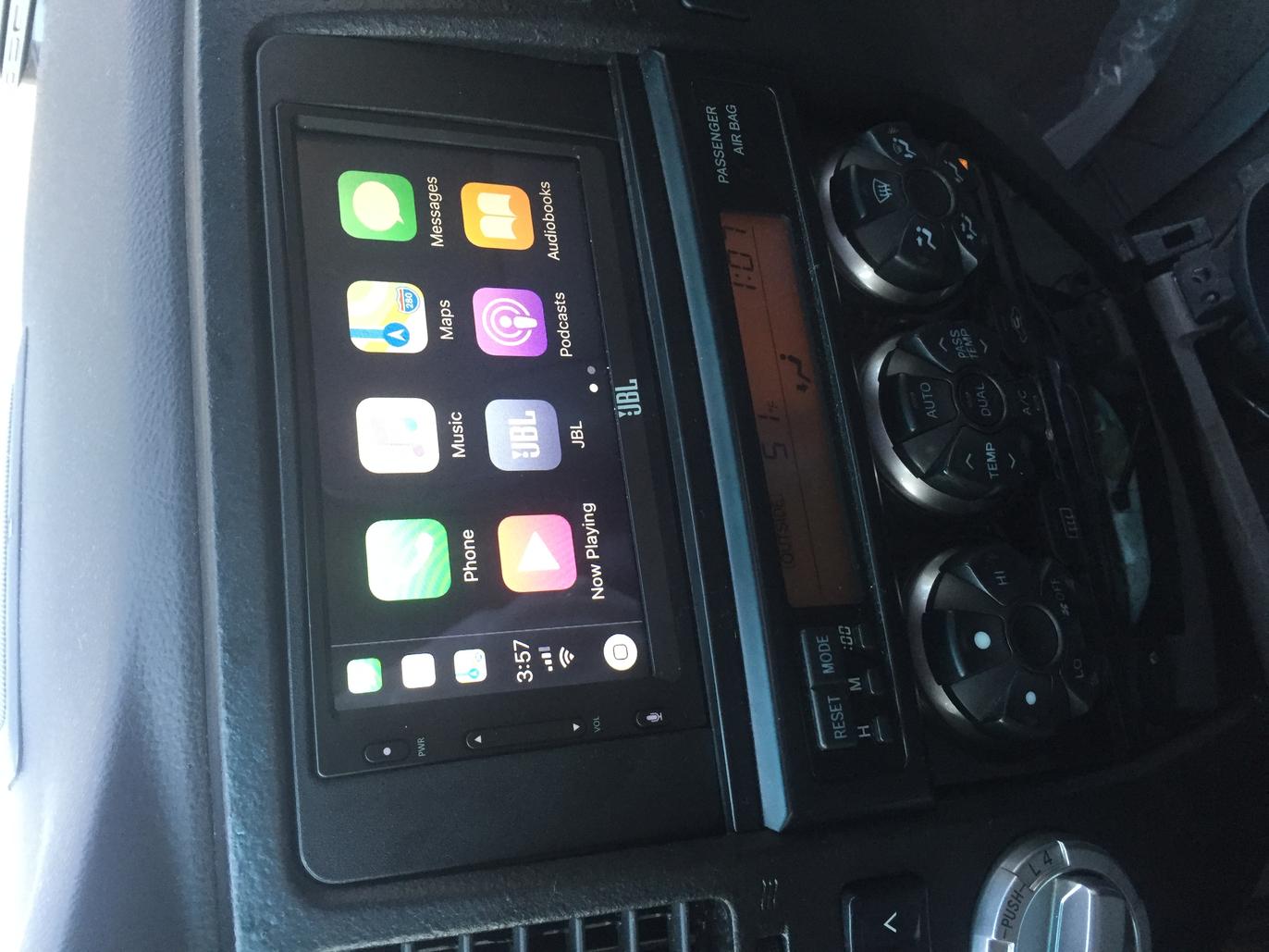

I took one for the team and gambled on the JBL CP100 Legend. It's back in the box and on it's way back to Crutchfield. They are no longer ordering more from JBL. Steering controls didn't line up and would not take any software updates.
I am going to take a second gamble on an 8" Joying Android unit.
The sound quality felt sub par on my JBL speakers. I dont think the subwoofer was going. I had the JBL harness.
It handled CarPlay pretty well. It didn't like it if I plugged my Iphone in AFTER car had been started.
I liked the FM channel scan function.
Clock kept resetting to 24h mode.
The steering wheel controls didn't line up. Vol+ acted liked seek up. Seek- acted like Mute, etc etc. (you cannot re-program vol+/- on an Axxess module).
