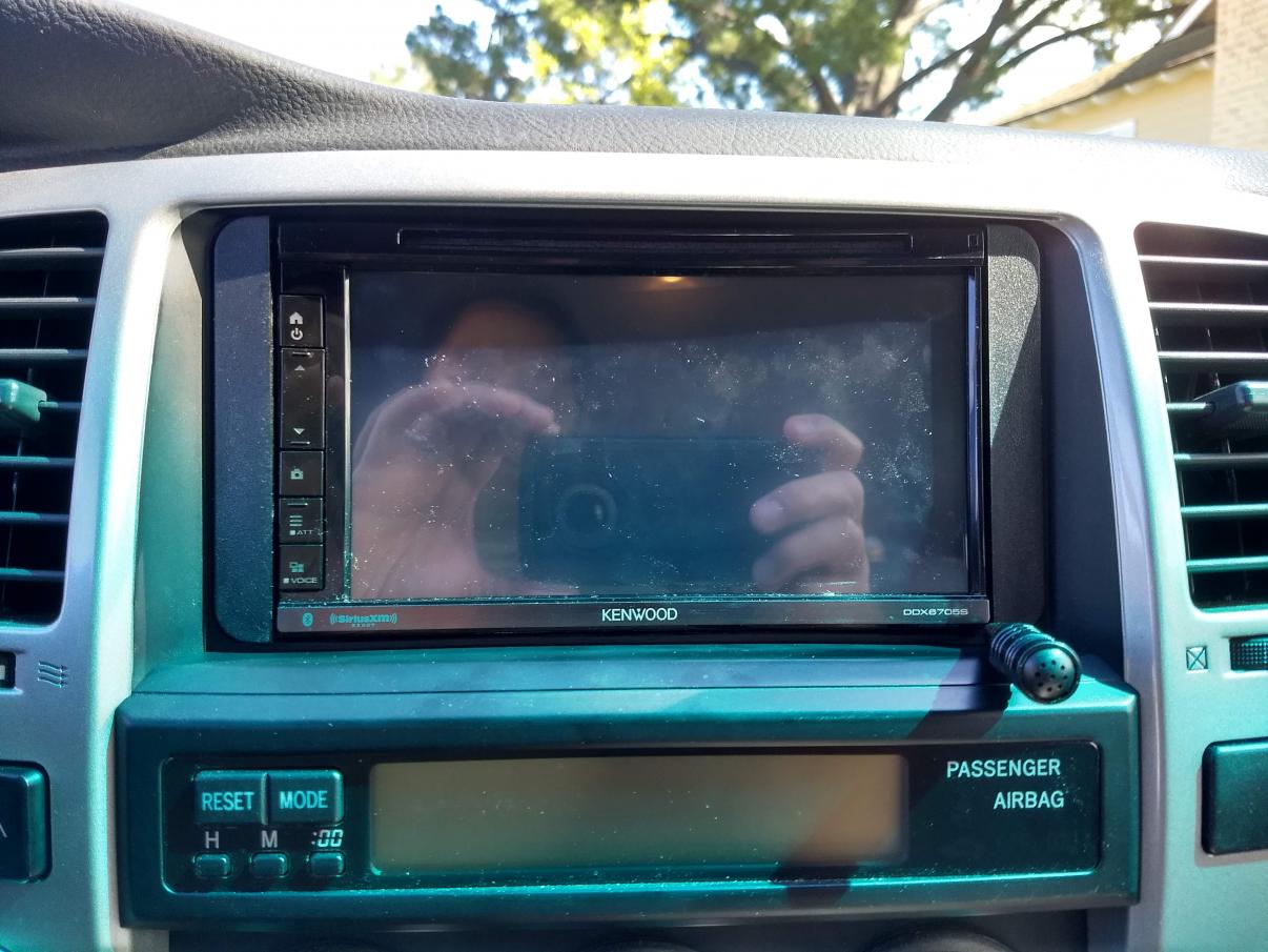

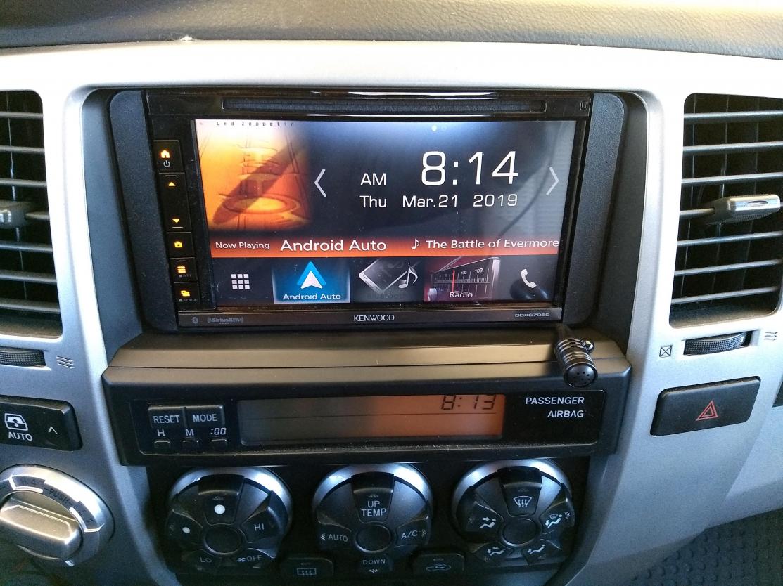

Installed Kenwood DDX6705S with Metra 95-8202 dash kit, and Metra 70-1761 wiring harness. Amazing fit, looks nearly stock. Most people put the MIC on top of the driver side A-pillar, but I decided to put it by the HU where it will get better reception from all passengers.

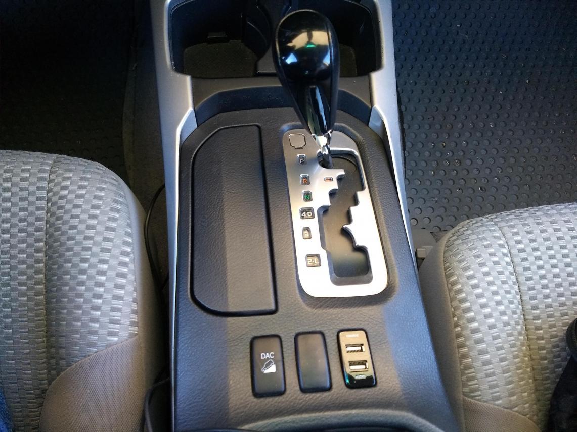

Also added a dual-USB outlet in one of the blanks near the gear selector. Audio outlet connects to back of HU via USB extension cable for Android Auto / Apple Carplay. Charge outlet is tapped into nearby cigarette lighter.
For Android Auto / Apple Carplay, use good quality USB cables rated for USB 2.0 or 3.0. Initially I used a cheap Dollar store cable and HU would not recognize the phone. Would say invalid device or no device connected. Problem solved once I got a good USB cable.
Bought the USB outlet from Amazon for $14:

One of the bulbs on the HVAC display died during the install. Must have broken when popping the display in / out to access HU. Easy fix, took 5 minutes to swap the bulb.

Also added a dual-USB outlet in one of the blanks near the gear selector. One outlet connects to HU for Android Auto / Apple Carplay, other is just power.

Unfortunately, one of the LED lights on the HVAC display died during the install. Easy to fix, just need to order new bulbs.
Was it hard to install the dual usb outlet? Where did you get it from?
Dual USB outlet was super easy to install since I already had the dash / center console opened for the HU installation. The audio outlet has a USB plug on the back, which connects to back of HU with a USB extension cable. The charge outlet has two wires on back, which I tapped into the nearby cigarette lighter.

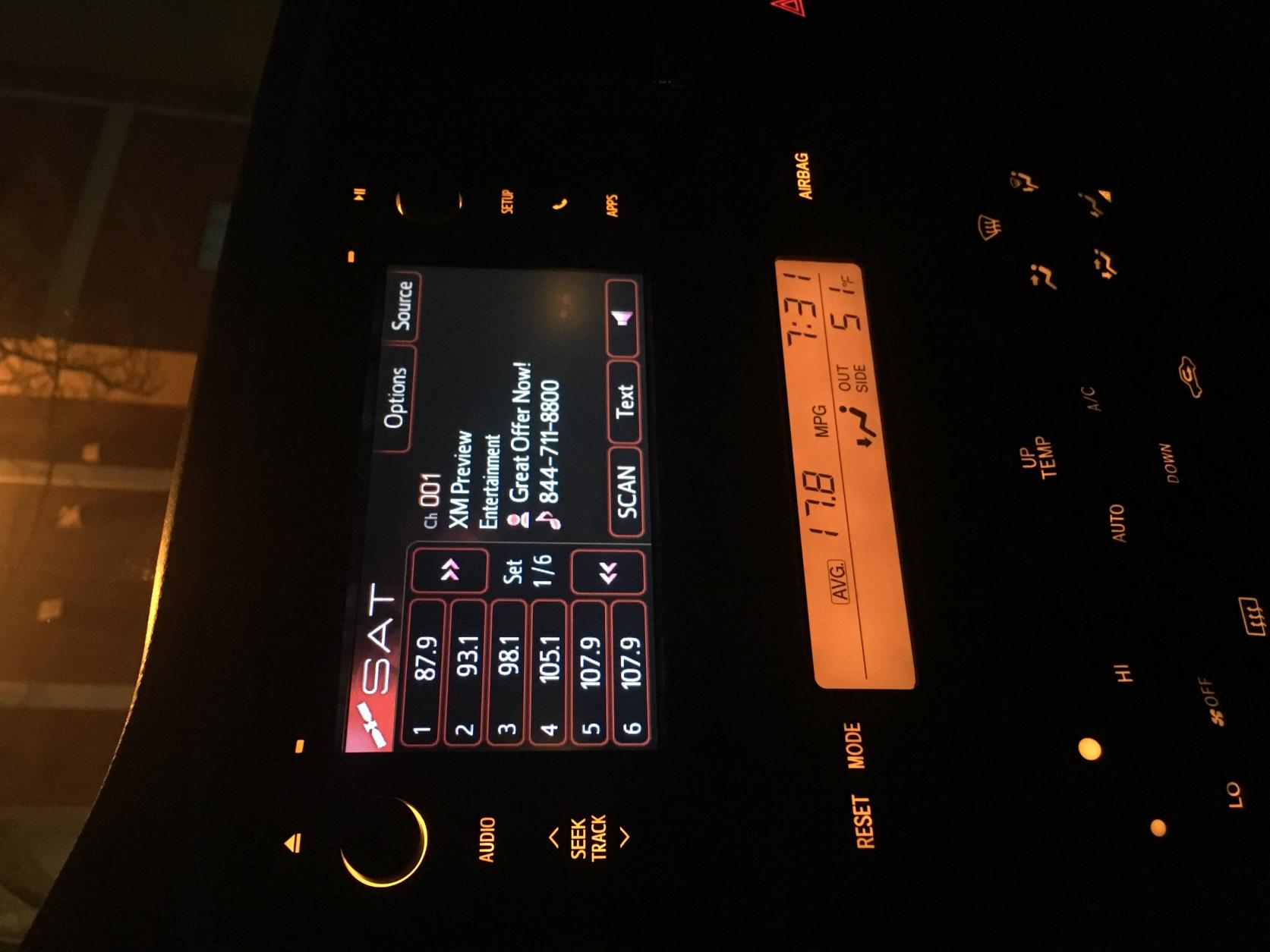

I went with a Corolla head unit because I thought it looked "modern enough" without being overbearing. Seemed to fit better with the period of the car but added things like HD radio, XM, Navigation, BT etc.

just wondering if that corolla headunit has the maintenance reminders like the oem 4runner headunit does? I assume it doesn't have navigation.
It does not have maintenance reminders, but it DOES have navigation, USB, XM, Bluetooth calling / streaming, and AUX inputs. It has the ENTUNE system so you can access things like traffic, weather, etc but ENTUNE isn't that great (but its part of the nav box so you get it regardless if you use it).

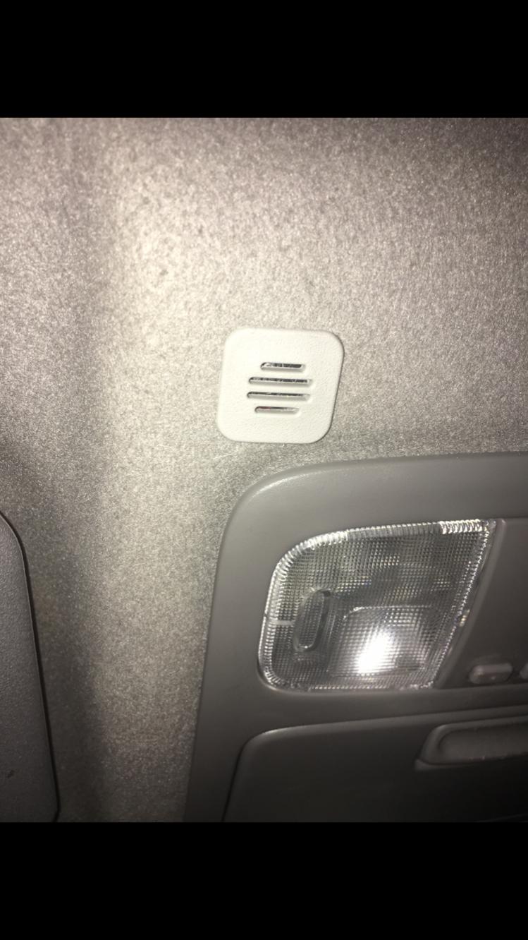

I will compile a build list if needed. Love the radio but cannot get videos to play. Microphone is in the roof and is a corvette microphone cover. Rear back cam is next to license plate light and has been great too. Easy to back to a trailer now
