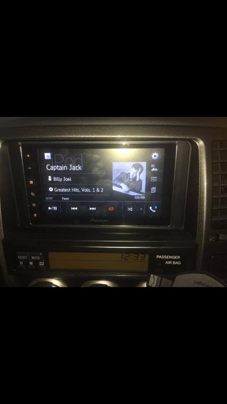

Just trying to mirror video on my phone. From YouTube and netflix
I will compile a build list if needed. Love the radio but cannot get videos to play. Microphone is in the roof and is a corvette microphone cover. Rear back cam is next to license plate light and has been great too. Easy to back to a trailer now
That ceiling mounted mic is a great idea, and looks very clean and factory compared to most installs I’ve seen. Where did you get that cover, and what year vette for those that may want to source one (like me)?:thanks:
Microphone cover from Corvette
On eBay.
05-13 Corvette C6 Volume Noise Compensator Radio Microphone Cover Grey M0472
The grey is a lot lighter but still looks ok. In person, it does not look crooked but does in the photo. :(. Will adjust.
Sounds really good. I used shrinking wire wrap on the mic just leaving the end open and then used electrical tape to wedge and hold as I did not want it picking up vibrations or other noise. Sounds really clear and no back ground noise.

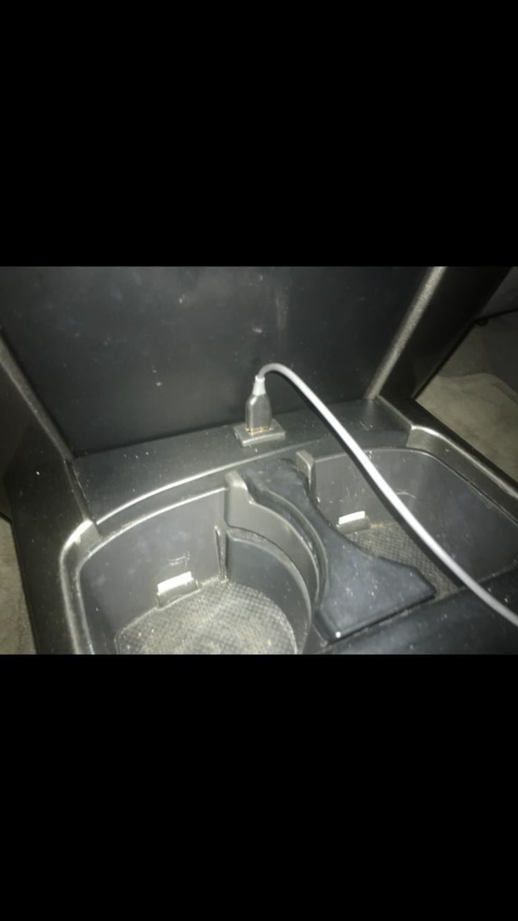

Added a charge port in front of the gear selector
It partially blocks the panel door below the vent controls when a usb cable is plugged in. Liked the location as my phone is on a phone bracket below radio
