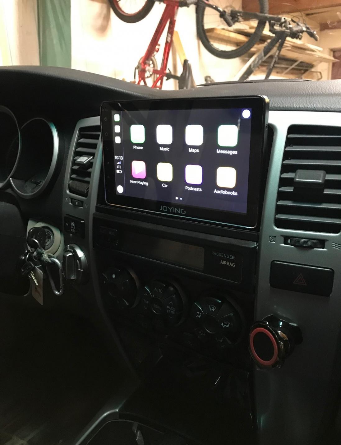

Joying 8"
Just replaced a 7" Joying android unit with a 8" screen version. It is awesome, Everthing works great, units has it's own sim card and gets cell service. Fun upgrade.
