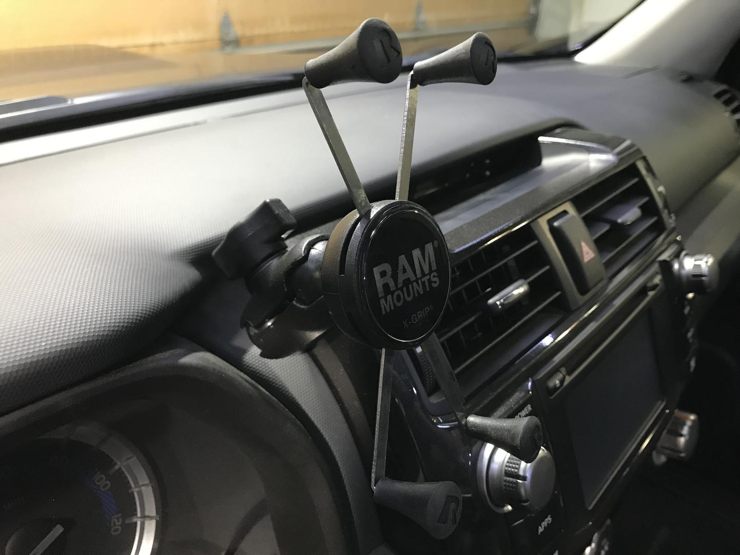

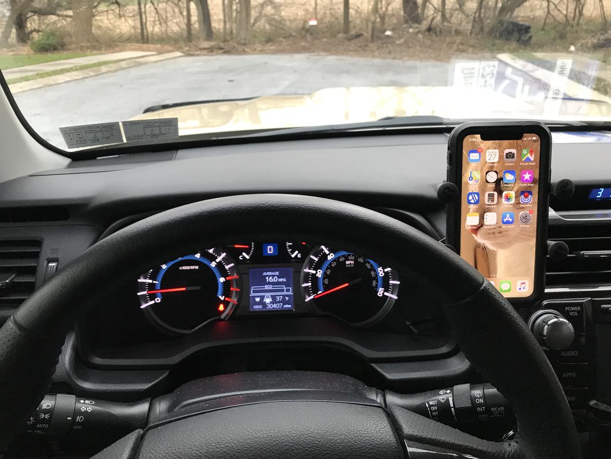

I finally got around to knocking this out today, using the side-trim mount method. I think a full-size tablet is too much though. I had to use a double-arm (using the shorter arms and a Ram ball coupler) which added a bit of vibration. Plus the big tablet really obstructs some of the controls. I ended up adapting my Proclip iPhone cradle to a Ram ball and think I'll just run that for now. It's a convenient one-hand dock and I think is still enough pixels for running Gaia. I might plus-size my phone when my upgrade comes up in the fall anyway. I don't have a mini-tablet to try but as seen in the photos above that's probably the sweet spot for getting a big display without crowding things. Wish I had tried this before ordering the Bad Elf GPS I needed for my iPad... at least it's cheap to return.

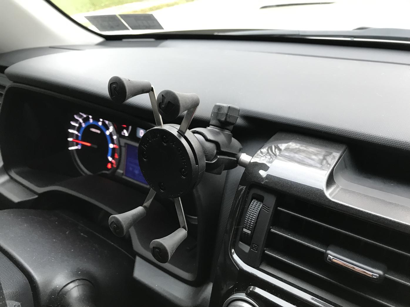

Just installed at the top left of the dash. Used two fender washers on both sides of the plastic to add extra support. Doesn't block access to anything.
