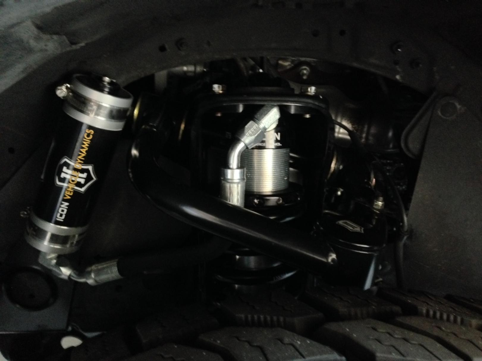

Front are the Extended Travel Coliovers

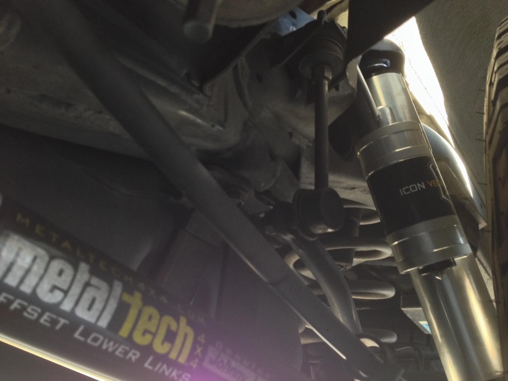

Rear are the PiggyBack 2.5 series (last ones as they no longer do piggyback at Icon due to adding CDC as an option - they do remote resi as the alternative)

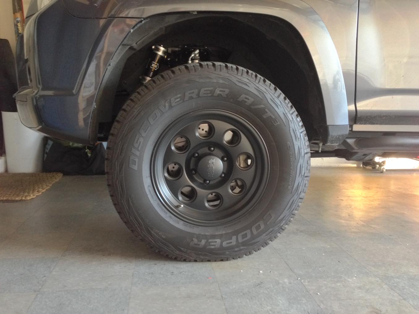

...and a nice pic of the front (see the drilled and slotted rotors - the best part is no more brake noise!!!!)
Basically the culprit was a stuck piston in the front coilovers. I spoke to Radflo and will be rebuilding all of these as backups.
