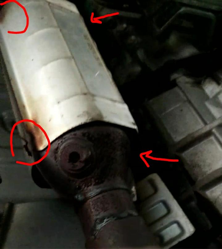

Finally, finally figured out what was rattling, or at least one source. Replying to this old thread in case it helps others. For me, the rattle came from two thin aluminum heat shields that sandwich the catalytic converter. Two small weld/clip spots at each end connect the shields to the converter, which is steel, and I guess the differing materials came apart. If I had welding materials I might try to stick them back on, however my solution was quick and only cost $4: two 5" stainless steel hose clamps. The diameter of the shields is around 4.75".
No more rattle at low rpm, idling in drive thru lane or at a stop light.
