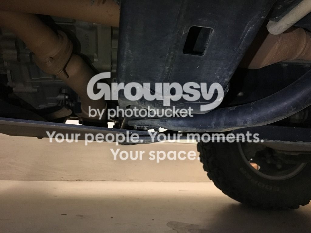

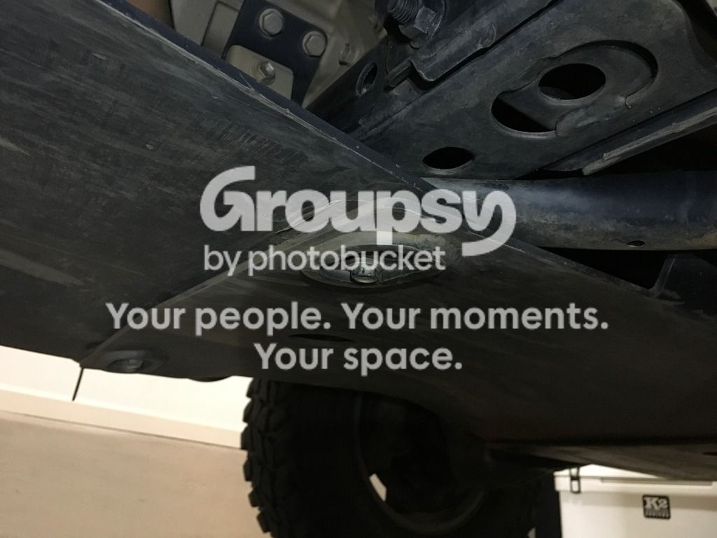

Anyone have an issue with removing the RCI transmission skid plate? Seems after a couple big hits to the plate I have broken the weld nuts inside the cross member and now can't get the plate off. There is very limited access inside the cross member to grab the now spinning weld nut. I would just cut the bolt but RCI's skid have a "Bolt protector ring" that is made it so the bolt head can't be sheered off.
Any other suggestions besides drilling the bolt out are welcome. Using a pry bar to apply downward force on the plate and bolt did not help either.

If you absolutely can't get to the nut I see grinding in your future. I would grind/cut the head off that bolt with a metal cutting wheel and chisel the rest off. I really don't see any other way.
A sawzall blade cant fit in that gap above the skid to cut the bolt? That would let you get the skid plate down and then work on the rest of the bolt and spinning nut

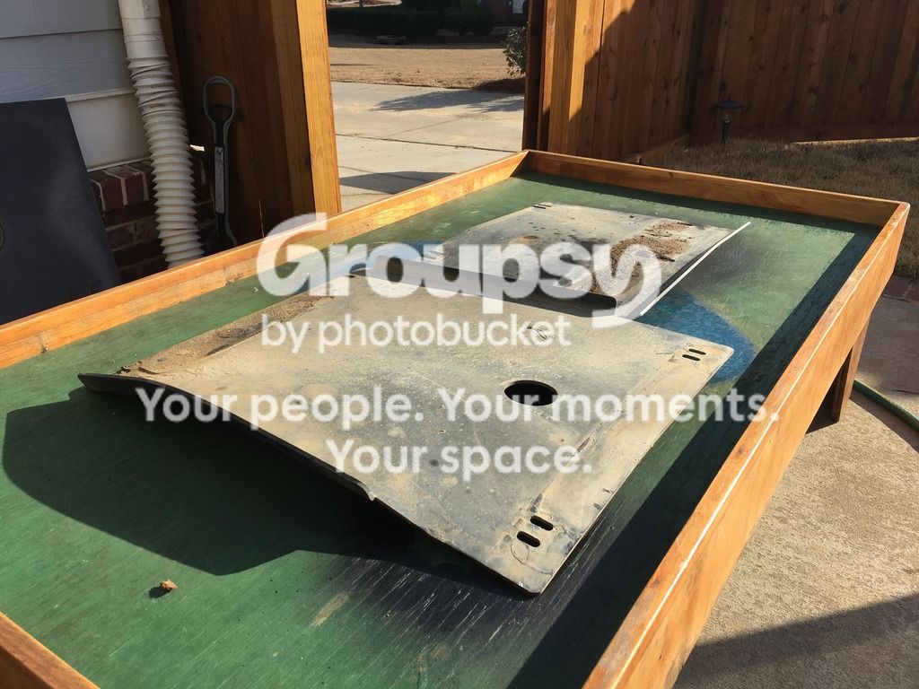

I was actually able to get the transfer skid plate out and that allowed enough room to get between the skid and cross member to cut the bolt.
These are supposed to the flat...
Wow... Well at least you know they are doing their job! Secures in my mind that when I get skids RCI is who I'm going with even though you are having this bolt issue.
Pretty sure this is when my skids got bent...
