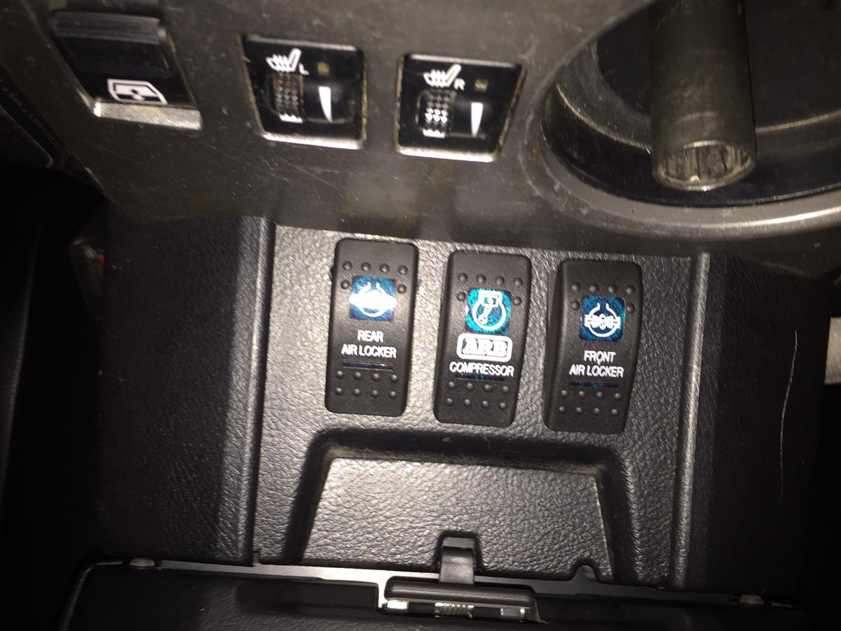

ECGS quoted me just under $3200 for 4.56's and ARB's F+R. That quote includes the core charge refund after i mail my current diffs back to them. Compressors run $250-$500 depending on if you go single or double. Local Shop in Golden quoted around $750 labor. And i guess i didn't include switches so whatever they run.
That sounds like a good deal, $750 labor for all the work including running air lines and switches a good deal. Here is a picture of my switches, mounted on front of center console. Good luck!
