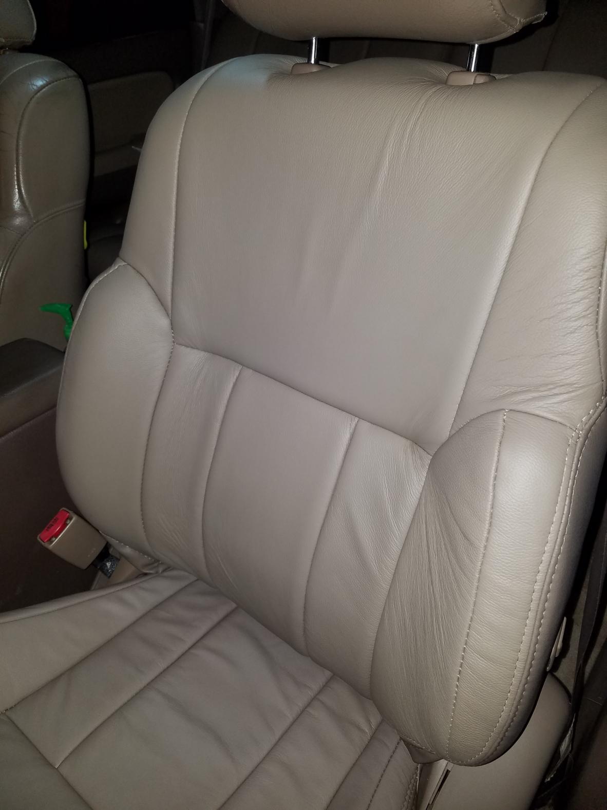

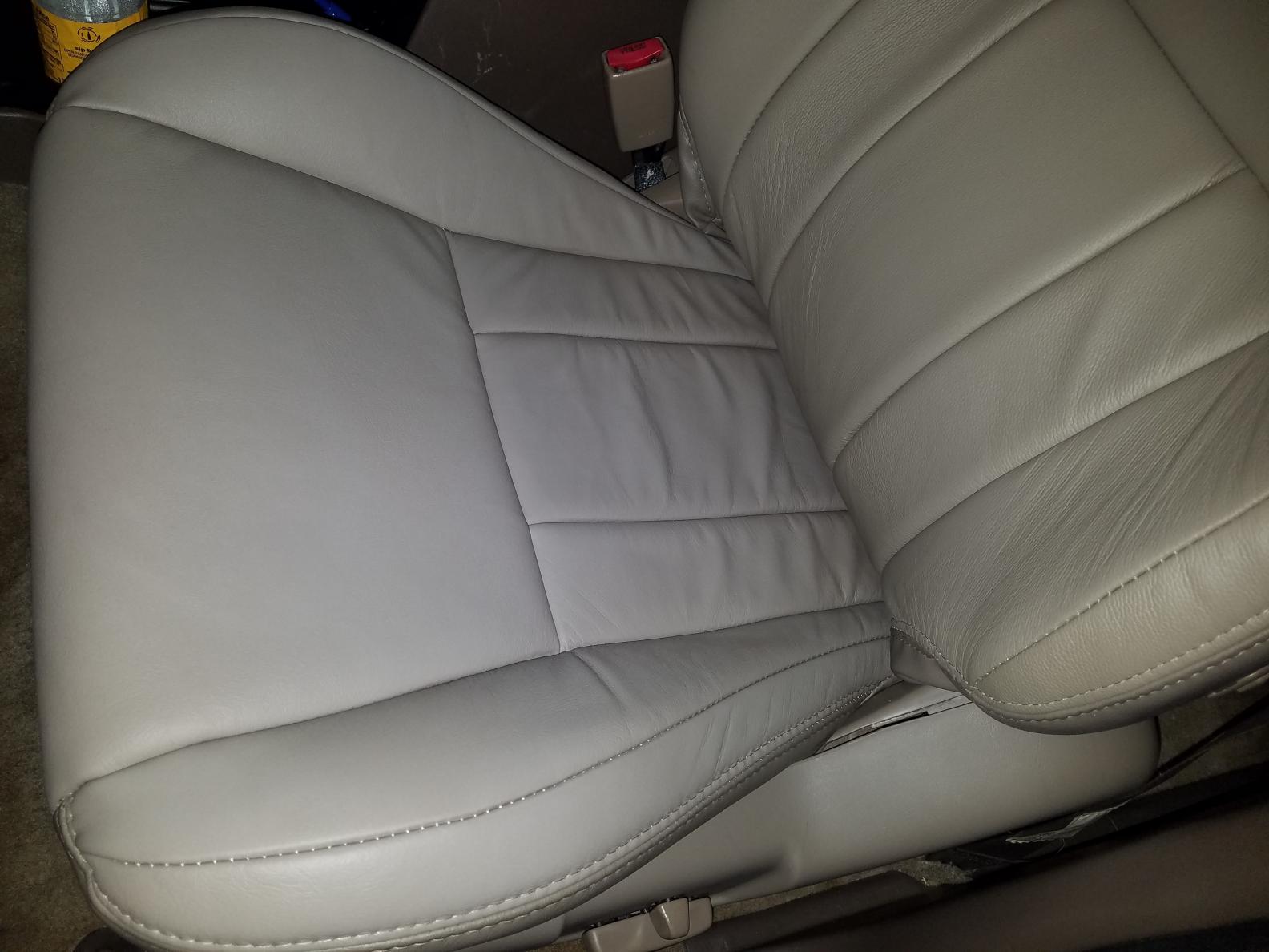

I have been piecing together parts for the past few months and ordered leather seat replacement upholstery and seat pad from US Autonation on Ebay. Had to order the OE seat back foam from McGeorge (least expensive) and they (USPS or McGeorge) lost the first shipment and had to send a replacement via FedEx.

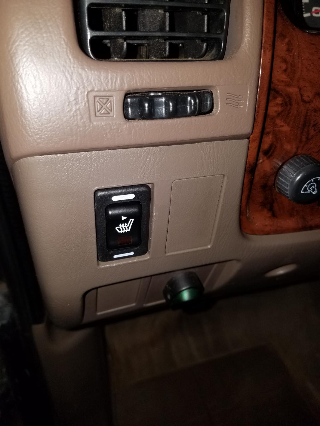

I purchased a carbon fiber seat heater kit from Ebay and took my time to install everything correctly. REALLY IMPRESSED with the way everything turned out. Only sad thing is the crappy lumbar support (even though I tested it with the covers off) still does not work. Very poor design by Toyota.
PROS: The seats seem to sit “higher” as the new foam is firmer.
CONS: Takes a lot of time and effort to get everything right but better than paying an upholstery shop to do it at $1,000-$1500 per seat. Pictures will be posted later……

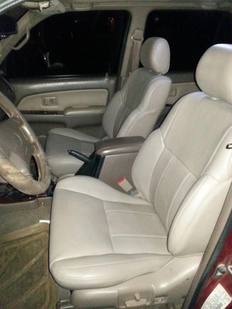

I had both fronts recovered in pleather with all new foam, bottoms and backs. 2 stage foam, majority is firm underneath and a baby soft upper layer.
They feel awesome and make up for an out of the box not so good ride on these vehicles. I'm lazy so had found a shop. Left in shop for 7 hrs and $750 later (austin) - best money I ever spend on this truck.
