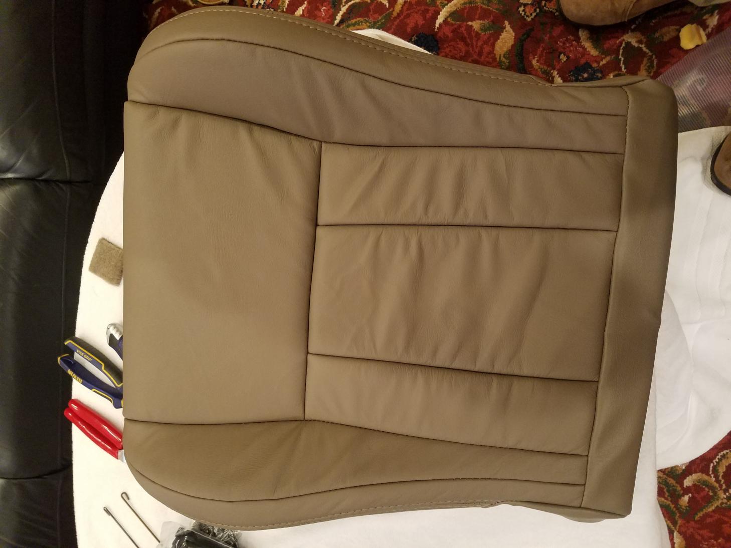

So, the leather and foam on the seats in my 2000 T4R LTD 4WD have seen better days. I found two donor seats from the same year make and model and have been piecing together parts (new foam + leather + seat heaters) and when I am done, I will simply swap the old seats out and the newly refurbished ones in....
That being said, any advice on the wiring? The carbon fiber seat heaters recommend a 10A power source and I am thinking of using an "add a circuit" style fuse connection.
I bought the leather seat bottom cover off of Ebay. Not bad quality. Also added the carbon fiber seat heater with a control button that fits the blank slots to the left of the steering wheel.
If any one of our members has done this and would be willing to offer tips/tricks/advice, I would appreciate it!

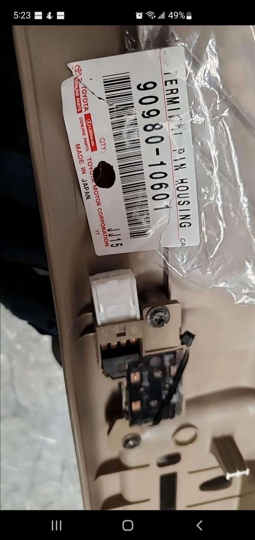

Can you take a picture of the plug that goes into that lumbar switch? I have that newer side skirt but the harness was cut off when I got to it....
I don't have easy access to it now, and if I recall correctly the mounting tabs were pretty delicate, so I prefer not to pop the piece off just to take a picture. I don't recall doing any rewiring in that area though, so I am pretty sure that the connector for the newer switch is identical to the earlier one.
No worries, I understand completely! Unfortunately, the plugs are completely different
