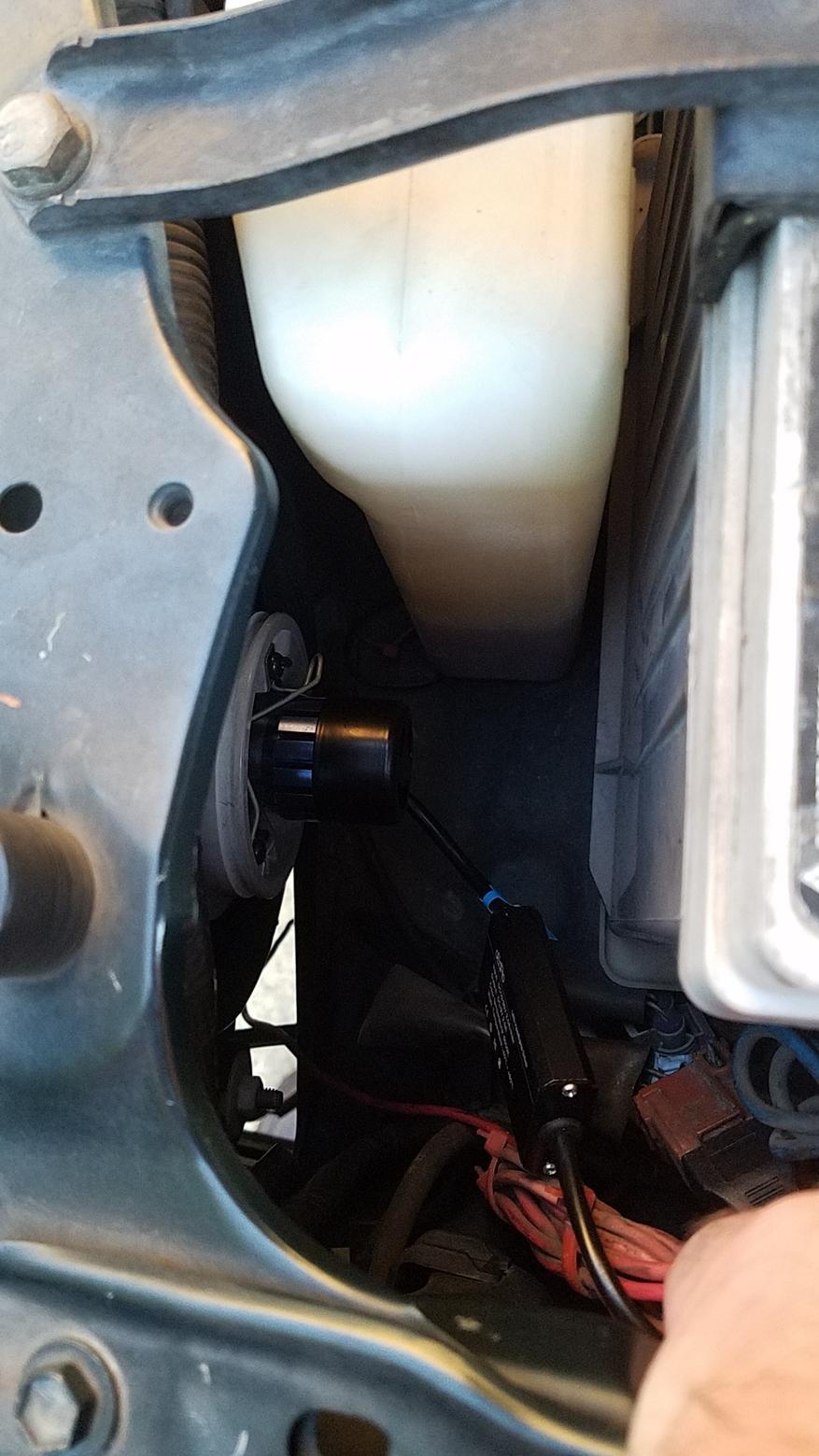

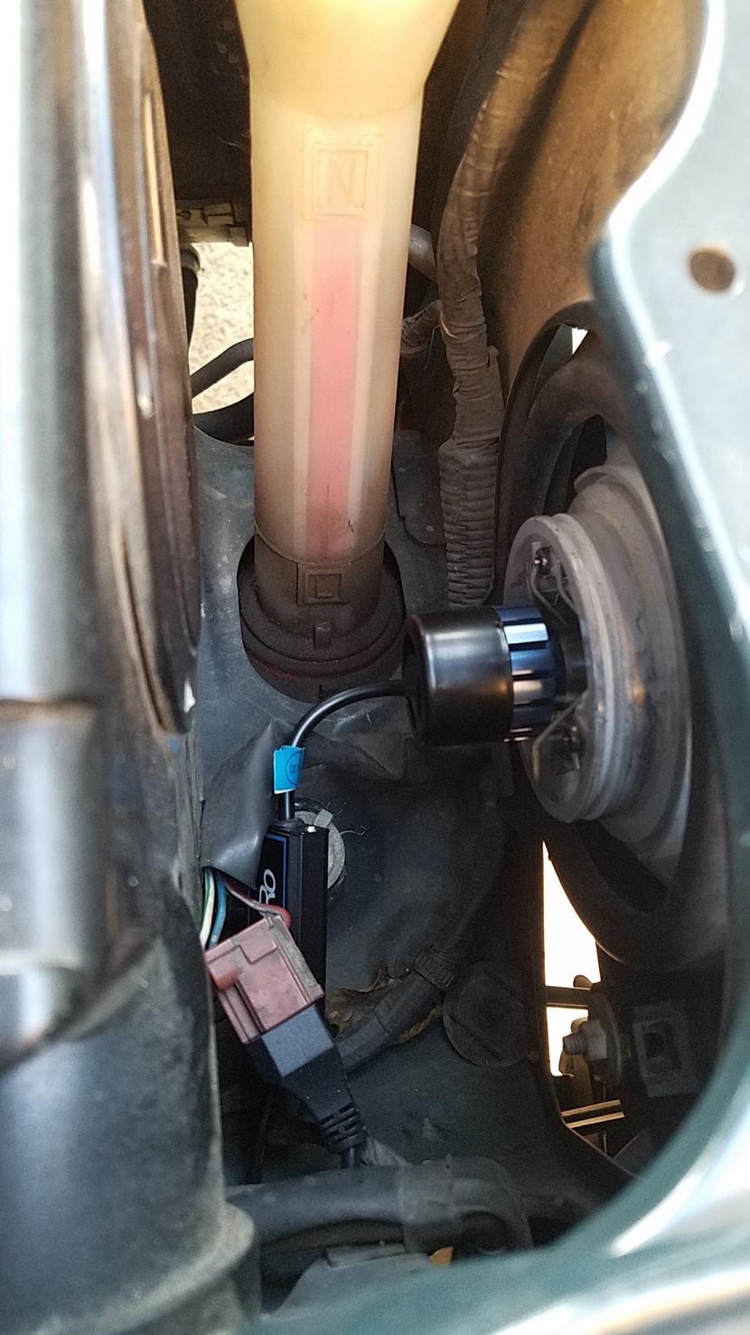

[MENTION=25434]BamaDrewski[/MENTION], How much clearence would you say you have between airbox and bulb, bulb and battery? Finger width, two finger, Shocker.
To answer your question, I thought it would be better with photos! :)

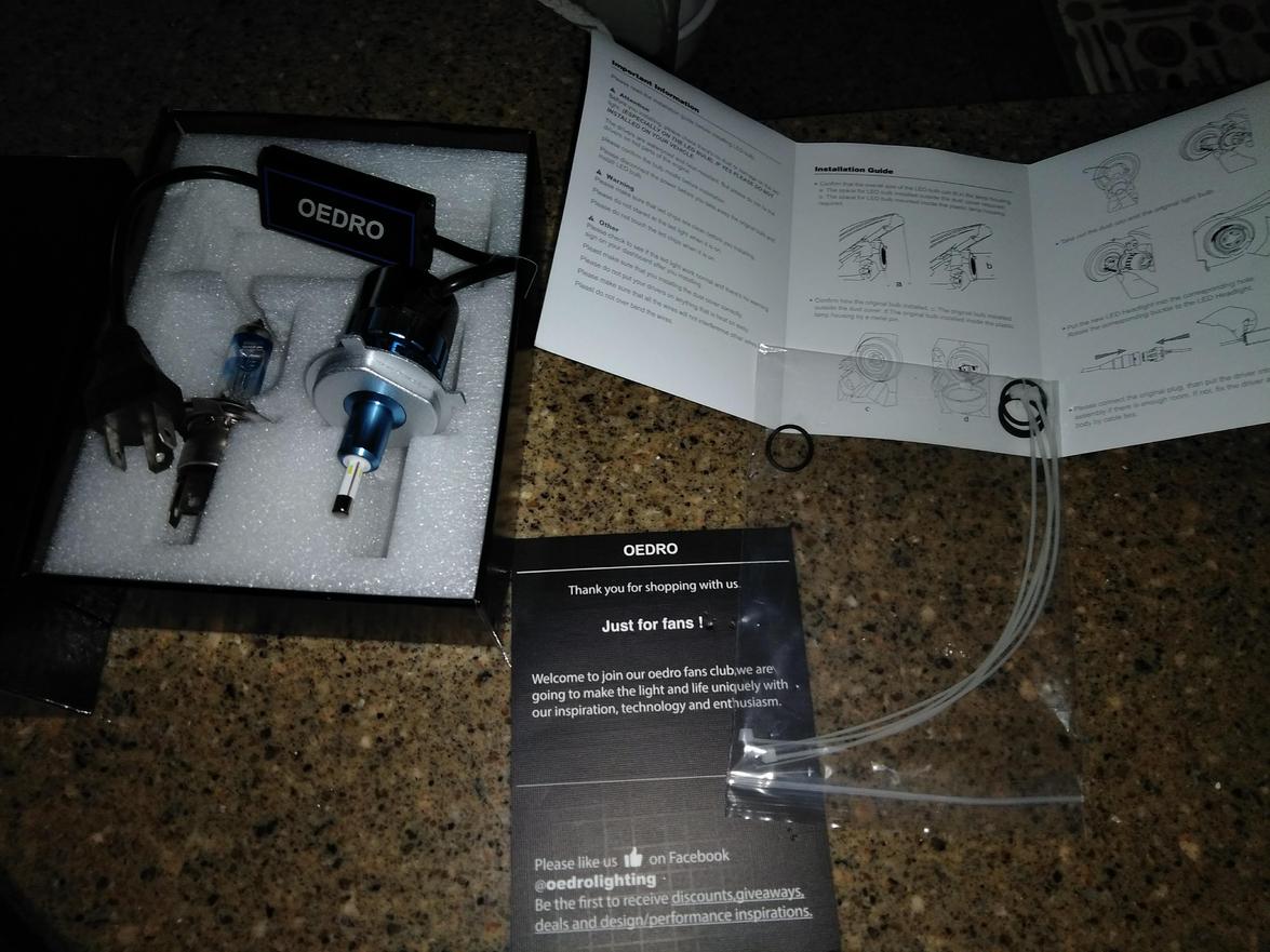

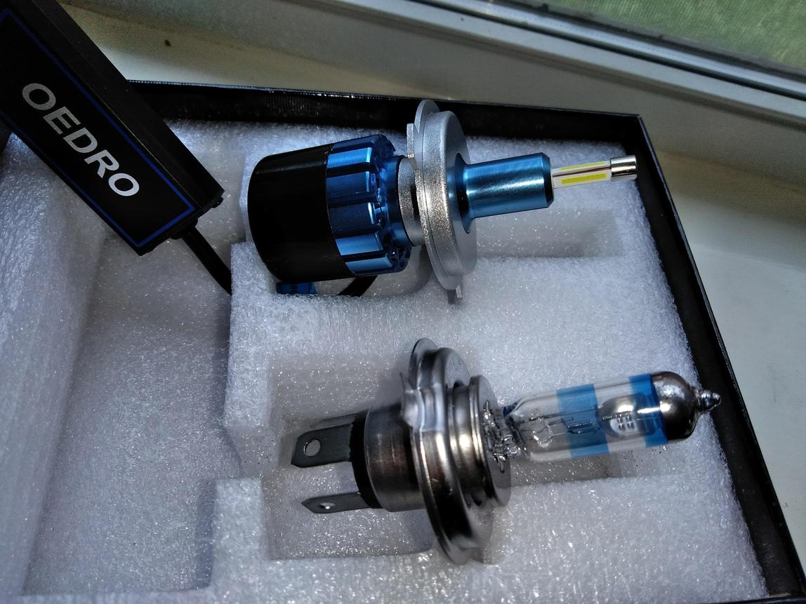

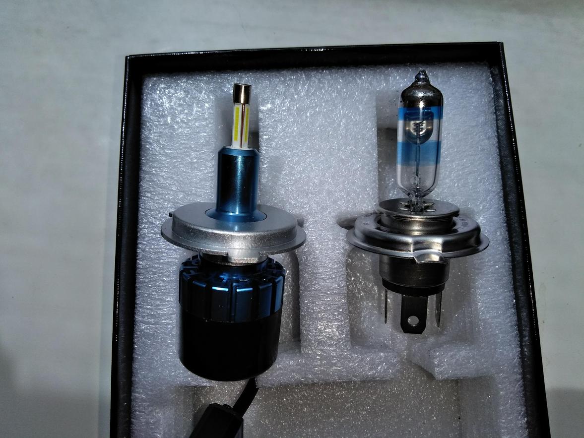

So i bit. Found it interesting the shrouds won't go back over the rear ends of the LED lights and the instructions pretty much depict the shrouds being left off. Even though they say they're waterproof, I sure wish I could fit them on. Otherwise...
Will shoot a couple left side (sylvania silverstar halogen) and right side (new led bulb) for comparisons after dark.
Oh and the DRL feature (which i lazily never disabled) doesn't work with even one LED bulb installed, so that could be 'good' for many out there.
Of course it says not to stare at the light but i did for just a couple moments to see which parts of the LED bulb lights up with low beams and which lights up with high beams. Even during daylight the LED output is incredibly bright. similar in brigntness to a welding torch cutting with oxygen.
As the manufacturers description states the LED bulbs are designed very much like the standard or halogen bulbs. That is the LEDs are in the same locations, oriented to the same angles for both the low and high beams. As regular bulbs the forward portion of the LED bulb is what lights up during low beam and like halogens the rear portion lights up in addition to the front for high beam use. So I can see how they would work well in standard light housings using the standard reflectors built in. We'll see later....
Here are a couple pics of the overall package and close ups of one of the LED bulbs and one of my sylvania silverstars next to it for comparison. Both bulbs are oriented as they fit installed with the tops facing up for comparison. The shading is in the same place, under the forward portion of the bulbs and the high beam light is in the same place, rear end top portion.
Also the instructions of course are very general but I would expect they'd tell you what you might do with the 4 small o-rings. Thoughts?
